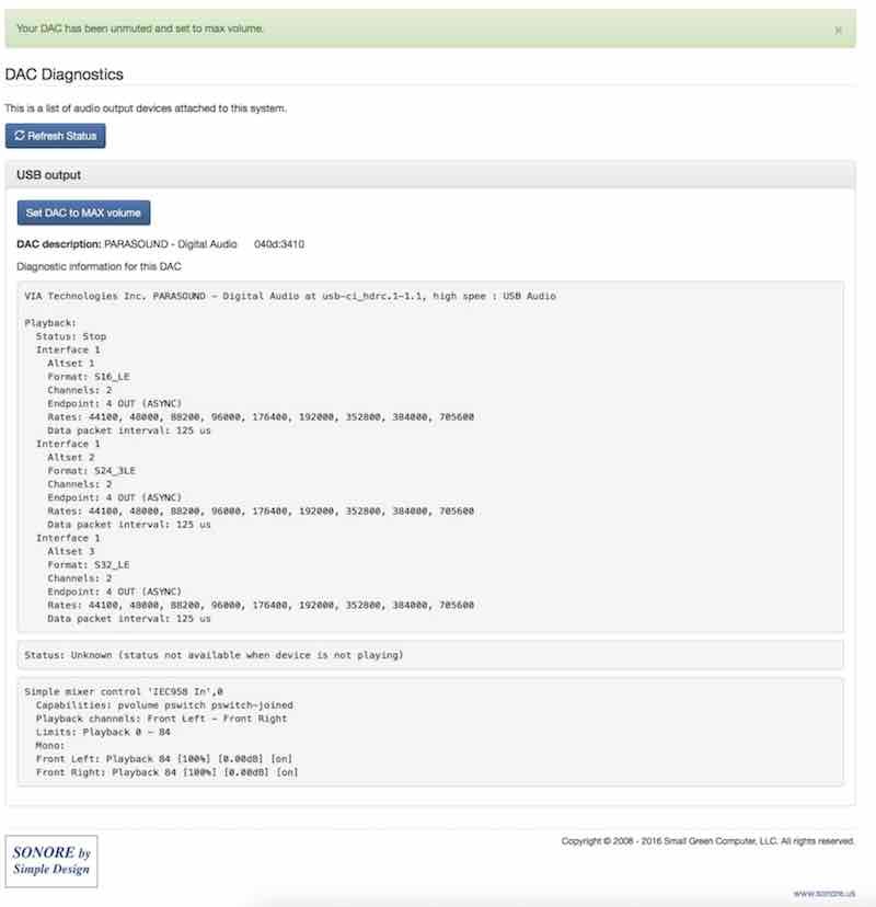

–I did verify all the settings from the post you mentioned
–I did press the maximize volume button
–above did not change anything, still cannot get DSD to play audibly unless I adjust settings in Roon so it is being converted to PCM

Base on the information you provided native DSD will not work on your DAC with Linux. This is because your DAC does not support the format required. This means that you will have to use DoP. In these cases DOP is usually limited to DSD64 and DSD128.
In order to get DoP playback with Roon / RoonReady you need a bit prefect stream. It could be a global setting or a specific setting to the microRendu/RoonReady output in Roon. Look for things like crossfade/normalization and turn them off.
