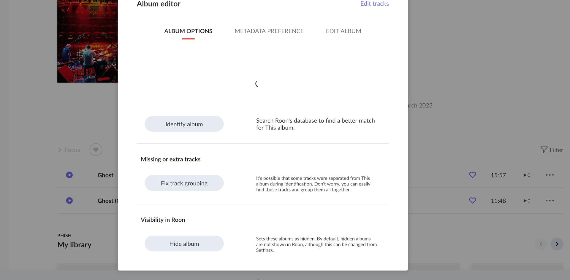

Im trying to use “album editor”
when i click “edit” Roon just spins…no going on over 3 mins
I am unable to edit the album-see attached image
