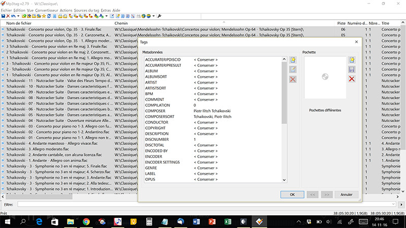

Sorry, I misunderstood. I tag my FLAC files with mp3tag, and I confirm that the same name is in the composer tag of every file.
Here you can see the tag summary for all these files; the only similar tag is the composer one:
