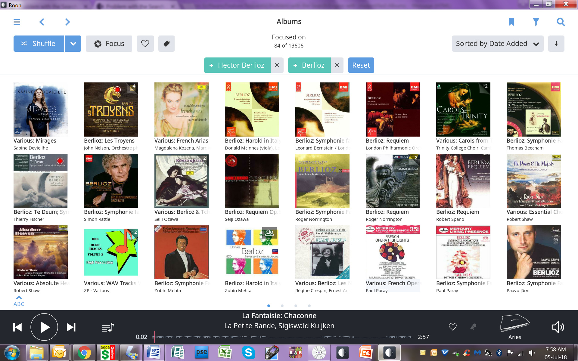

This album, is unidentified;
A focus on “Berlioz” & “Hector Berlioz” fails to locate it.
But a search for “Damnation of Faust” does
So I’m assuming it does not come up under “Berlioz” because it is unidentified so Roon does not completely recognise it. So maybe my header is wrong and the problem is with the Focus on composers not the search engine although I’m pretty sure the search engine did not find it yesterday - but it did this morning so …

Focus on Berlioz requires that the name is in the composer field.
Or in some other artist field. From the appearance of the screen capture, it seems that Berlioz is not in any field.
But I bet that the “funnel filter” on Berlioz would find it, since it is in the album title.
Ah, now I understand. The reason why search (magnifying glass) and focus (iris) are returning different results is that search is parsing strings in your track titles, artist and composer names. But focus is parsing populated elements in a database (roon’s object model). It is the identification process that populates that object model. Focus doesn’t find anything simply because there is nothing there.
