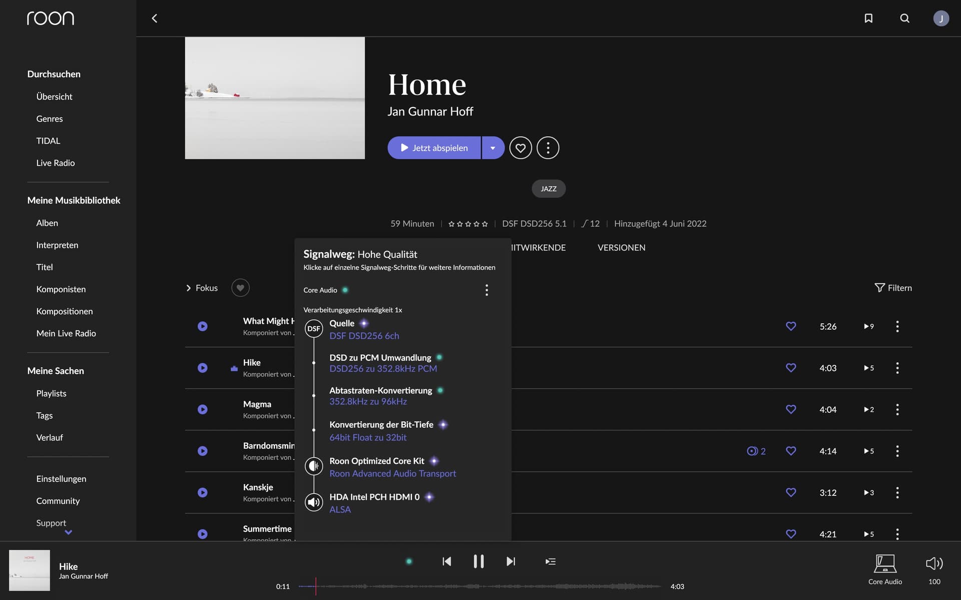

Fellow user here, the first thing to look at, imho, is the processing speed on the signal path while playing a 5.1 track. If you could take a screen shot and post it that would be helpful.

I just made a few screenshots…once rock via network to the Trinnov and once the rock via HDMI to the Trinnov.
Unfortunately, both connections result in the problem.
In both pics, the processing speed is 1x which is too low. Anything below 1.3x can begin to exhibit playback issues.
Simply put, the CPU cannot handle it. And @WiWavelength was correct.
