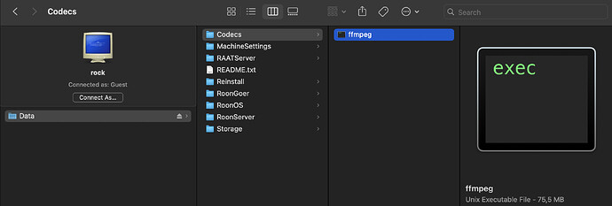

The web interface shows MISSING CODECS
I have downloaded the ffmpeg codec and copied this into Data/Codec/ and rebooted ROCK - still shows MISSING CODECS.

Hi - if you want to use internal storage in your NUC you’ll need a second drive (presuming you have a ‘tall’ NUC - if you don’t, you’ll have to use external storage either connected via USB or across your network).
It’s not possible to use the drive ROCK is installed on for anything other than the OS.
As for ffmpeg - did you uncompress it twice? That’s caught a few folk over the years. It should simply be called ‘ffmpeg’ and be around 77mb.
Michael
First thing first, your 1TB SSD M.2 can only be used for ROCK OS. You cannot store any music files here. You have to use another drive (2.5" SATA drive for internal storage music files).
As a side note, you don’t need a 1TB M.2 SSD for ROCK OS. You only need a very small SSD for this.
Secondly, as far as adding a FFMPEG file, make sure the file is already uncompressed. Once uncompressed it’s name should be just ffmpeg and that’s it, without any file extension at all. If it has a file extension you might still to uncompress the file.
Once you copied the ffmpeg correctly to the Data\Codecs folder, you don’t actually need to reboot ROON. It will just work. You can verify by going to the Web UI and refresh the screen.

I have uncompressed the archive ffmpeg-6.0-amd64-static.tar.xz using ARK
I get the uncompressed directory with ffmpeg in the root (no extension)
The ffmpeg file is not compressed - 78,683,840 bytes executable file.
This is the file I have copied - I don’t see where the second uncompress comes in.

This is fine. I assume the ARK you are using is the KDE tool on Linux? Keep in mind that’s not what the instructions are written for, they target Windows/Mac users without much knowledge, and I think on Windows one my have to uncompress twice (depending on the tools one uses), once the xv to a tar and then the tar to a folder. Though on Mac it’s not necessary either and the instructions could do with some improvement.
Putting the ffmpeg file into /Data/Codecs should suffice, like others have written.
Though it should not matter that you used a 6.0 archive, I noticed that you did. Did you try with the version that is recommended in the instructions, https://johnvansickle.com/ffmpeg/builds/ffmpeg-git-amd64-static.tar.xz ?
