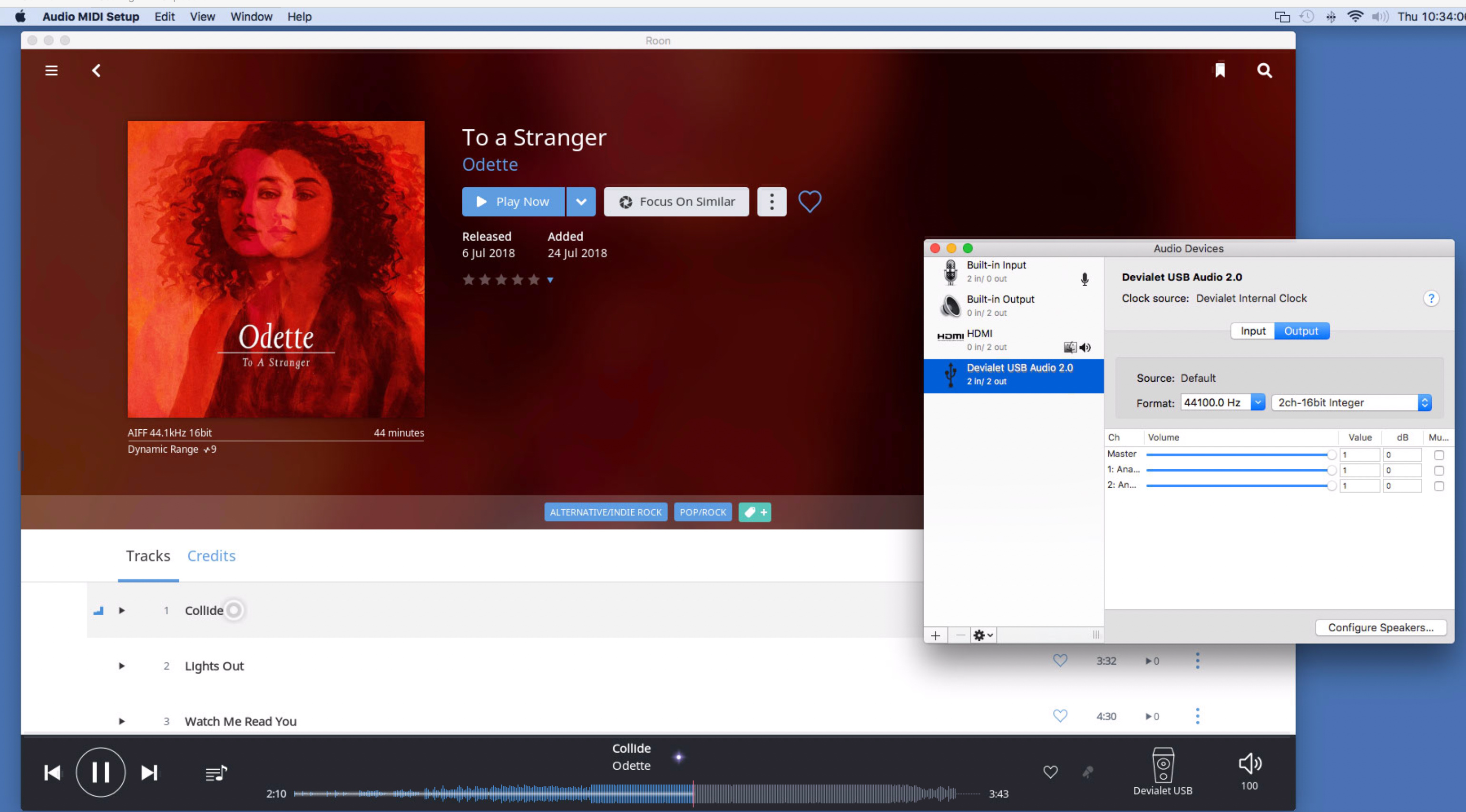

Not sure what’s going on anymore since the problem is now a bit different to before. Using USB, whether with ROON or other programs (Audirvana, Amarra) and selecting Devialet USB for sound output in the Apple Audio Midi still results in defaulting to HDMI as output as soon as something is played but the sound streams to the amplifier anyway. This is what it looks like in ROON:
So I’ve gone back to using the ethernet connection, which has meant some rejigging of my network. I’m assuming that the USB problem has to do with the Audio Midi itself rather than ROON or the amplifier. Maybe a recent upgrade has introduced some quirk.
