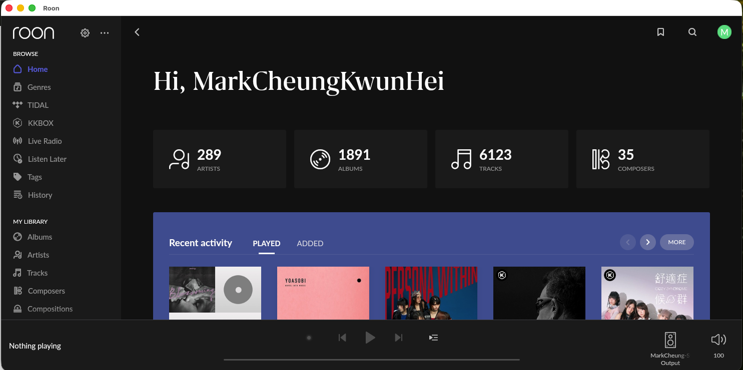

· I couldn't sync my profile pic on my Roonserver and my Mac mini, iPad, iPhone remote app, even couldn't re-upload my profile pic from my local drive, or through the URL from Imgur. Here is my system, Ugreen NAS DXP480T Plus, ubuntu VM to run the Roonserver, Mac mini M1, iPadpro M2, iPhone 16pro, Router is Xiaomi BE3600 with Xiaomi switch, Using Tailscale with Roon ARC, DNS 114.114.114.114, 8.8.8.8, I created a new profile didn't work, setup new 2step verification on my ubuntu VM, (Google Authenticator), My NAS also had it, My Roon account connect with my apple account to login(with FaceID), also had a 2step verification with (Google Authenticator), this happen b4, but after I setup a 2step verification it turned to normal, but its happening today again, its quite annoying, pls give a solution or advance advice to solve this issue.
· Router: Xiaomi BE3600, Xiaomi switch, Ugreen NAS ubuntu VM,
