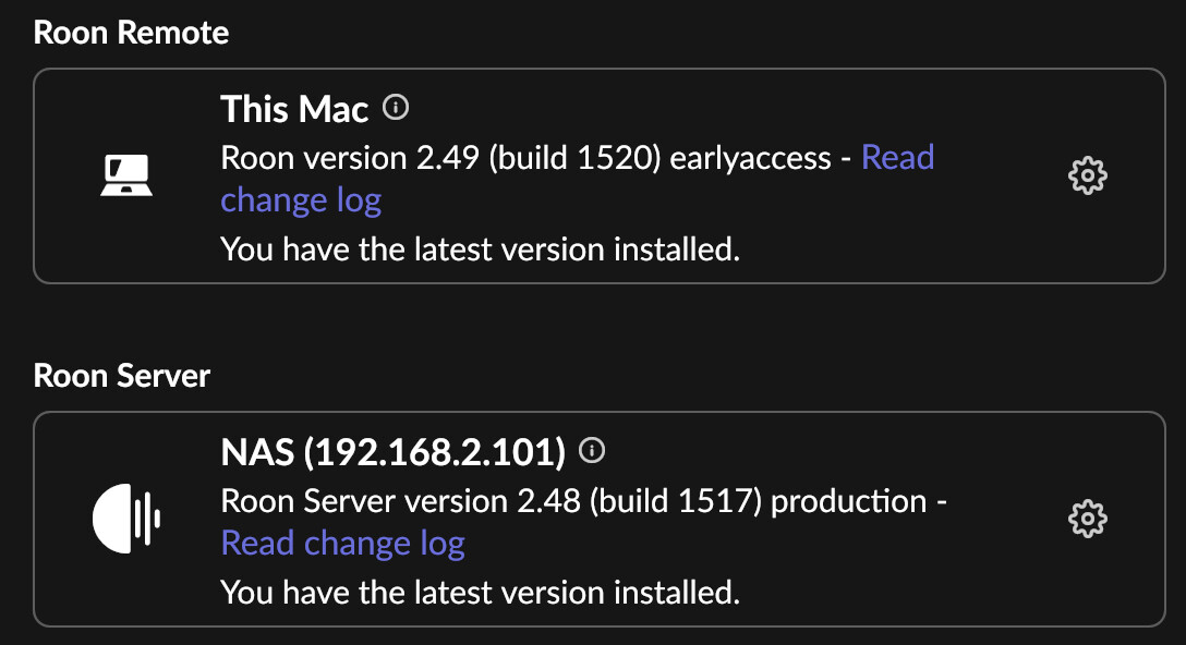

QNAP early access doesnt seem to be early access
i downloaded that latest release
RoonServerEarlyAccess_QNAP_x86-64_2022-11-17.qpkg
and installed it, it shows up like this
also i cannot open the little info screen on the QNAP UI … it only shows a blank screen

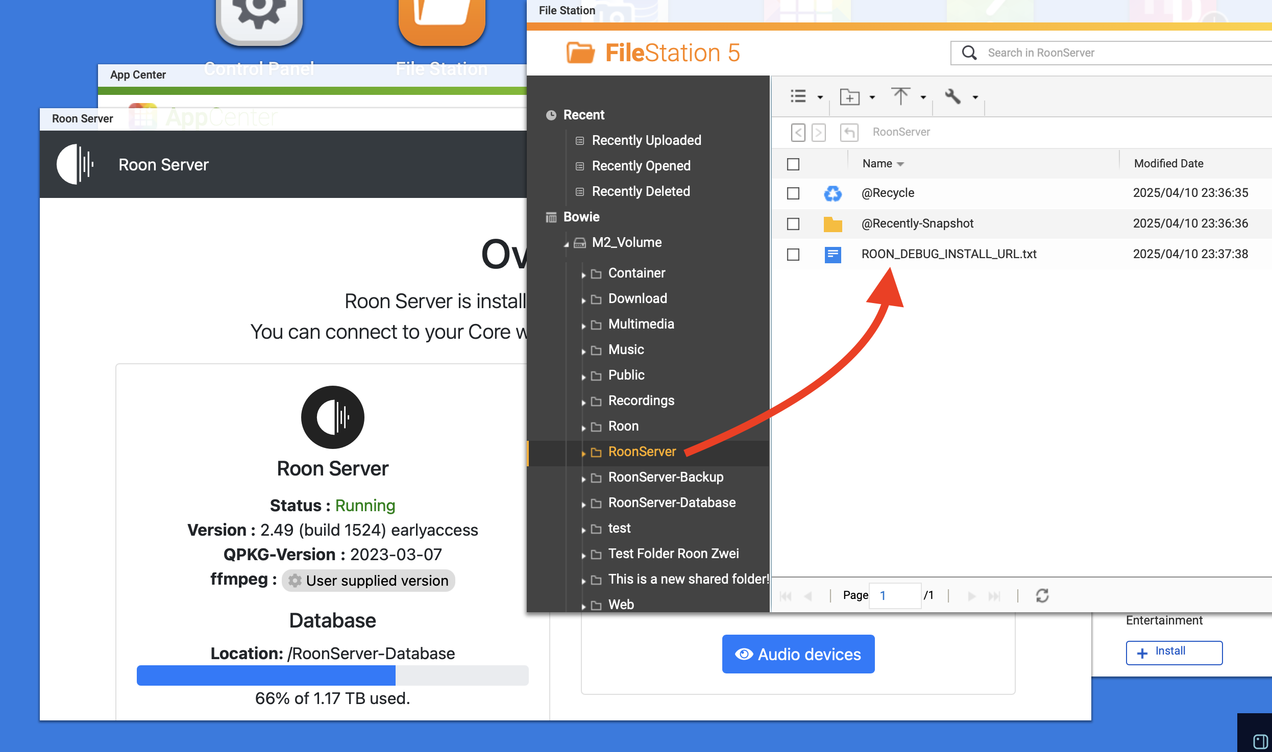

Hi, @Tino_Nettling, here’s a potential workaround:
  • Uninstall RoonServer in the App Center. (Your Ronn Server database folder won’t get deleted by this)
  • Create a (plain) textfile ROON_DEBUG_INSTALL_URL.txt on the root level of the RoonServer shared folder (case sensitive!) with the early access url (https://download.roonlabs.net/builds/earlyaccess/RoonServer_linuxx64.tar.bz2) as content. (If you don’t have a RoonServer shared folder, create it in the Control Panel → Shared Folders)
  • Install RoonServer again in the app Center.
  • Open the QNAPs Roon Server web panel, and specify the database location.
  • You can now delete the textfile again (and remove the RoonServer shared folder, in case you created it before)
Could you please try that and let me know if you area able to switch to EA branch?
