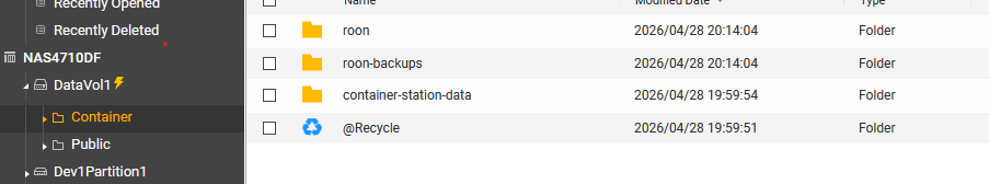

Could you share a screenshot of the folder structure in File Station, pointing to the local folder where your music files reside pls?

The folders for container and backups are clear:
/share/Container/roon
and
/share/Container/roon-backups
I hope the volume DataVol1 on NAS4710DF is an SSD volume?

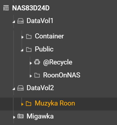

What is the name of the main folder in Dev1, could you show that one pls?
also try the path where, as in the app there is no share path
Is /RoonOnNAS the only folder under that Dev1Partition? I would not recommend to use it, as it contains older database remnants.
Choose another folder under Dev1Partition1, or create a new one, like /RoonContainer

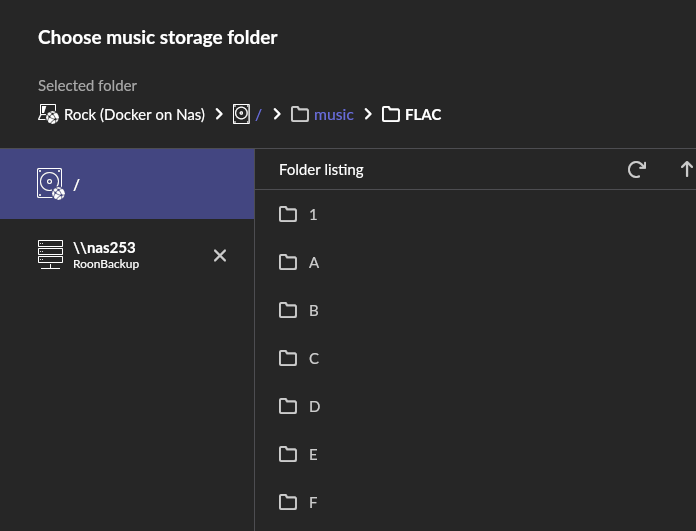

in Roon I then can enable my folders within my music folder in the storage settings:

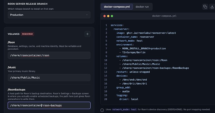

Try exactly this setting in the docker generator:
Your existing folder /Public/Music (with the music files) will be shared with the container, and roon in the container sees that as /Music within the container
Here it is:
