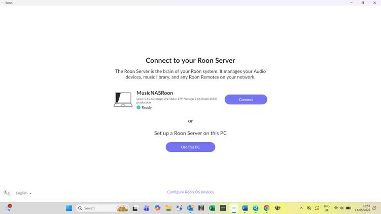

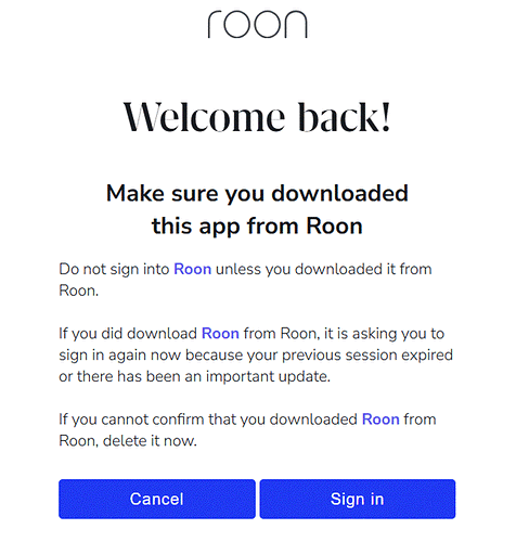

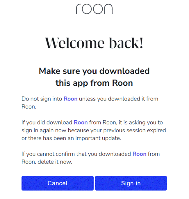

I followed the instructions but when I reopened the Roon app, the only Roon server that was showing, which was marked as ready, appears to be my previous server as it has the same name (MusicNASRoon) as the previous one. During the process I completed, I I gave the server a new name (roon-server). When I try to connect to the MusicNASRoon server, I input my log in details but it keeps returning to the log in page (below). I initially got a message stating that I was already logged in to a server and could not therefore log into a second server. When I try to log in, it keeps returning to the following page:
Also, whilst I thought my database was backed up automatically, if I press ‘restore a back up’ on the Roon app log in page, the RoonBackups folder is empty. I’m not absolutely sure that this is the correct backup folder.
Whilst I thought I’d followed the process correctly, I can’t get past this stage and I suspect I’m trying to connect to the old server. I also fear that my library is not backed up (or the back-up files are located elsewhere).
Do you have any suggestions as to what to do next?
Thanks again for your help so far.
Hello @Chris_Russell1,
Welcome back! It sounds like you are very close to getting this finished. The behavior you are describing is actually quite common when moving from the old native app to the new Docker setup.
Here is what is happening and how we can get you past this login screen.
  1. The “Two Servers” and the Login Loop
The reason you see your old server name (MusicNASRoon) and get a message saying you are “already logged in” is because your account currently sees two separate Roon “brains.” One is the old native app, and the other is your new Docker container.
  • The Solution: When you see the message stating you are already logged in to another server, you should see an option to “Un-authorize.” * Don’t worry: Clicking “Un-authorize” does not delete your music or your database. It simply tells Roon, “Please move my license from the old app to this new Docker container.” Once you click that, the login loop should break, and you will be able to proceed.

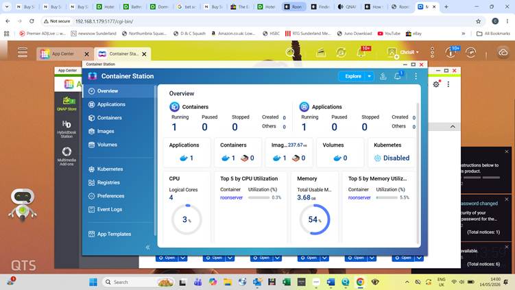

To help you further, could you please provide a screenshot of:
  1. The “Choose your Roon Server” screen where you see the different names.
  2. Your Container Station dashboard showing the running roon-server.

Thanks for your response. I was unable t complete step 1 because I no longer get the message that I’m already logged on or the option to unauthorize. I have tried to log in several times but I got that message only once. Now all I see when I open the Roon app is this screen:
Is there another way to unauthorize the original server ?

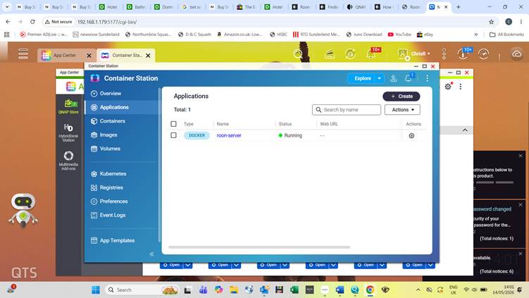

I have however been able to complete step 2, uninstalling the original Roon server. This is the Container Station overview pag e:
And the applications page:
I do hope it was ok to go ahead with step 2 even though I couldn’t complete step 1.

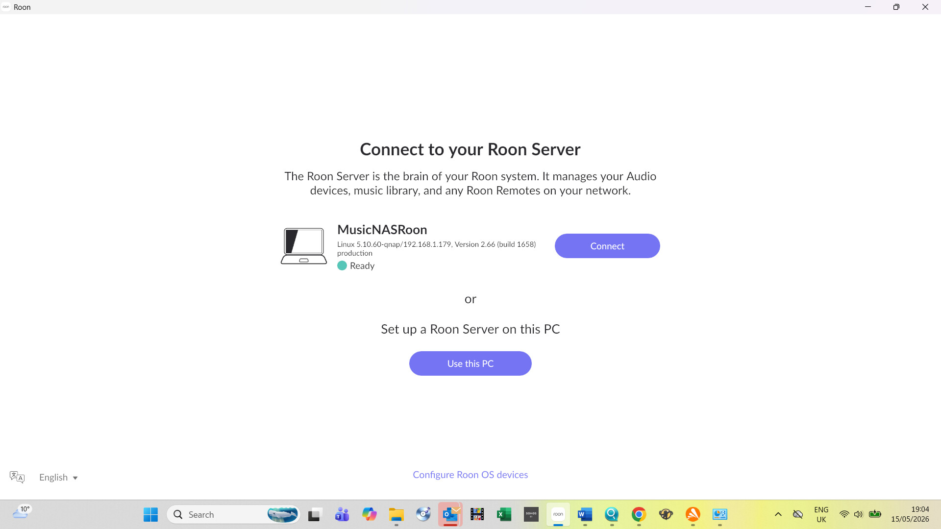

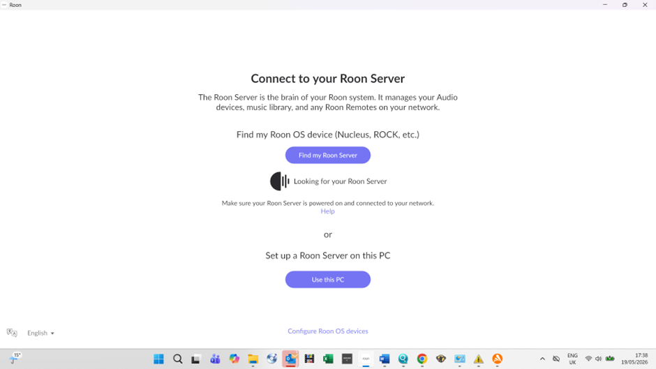

No, I’m not up and running yet.
The log in screen (above) is showing only the old server (MusicNASRoon), not the new one (roon_server) and when I click on Connect, I just get this page:
It doesn’t give me the option to de-authorise the old server or to connect to the new one. Can you advise how to do both of these things please?
I will probably then need help to locate and import my library back-up files as I’m not sure where they have been saved.

Ah you have my apologies there @Chris_Russell1! I completely misunderstood your prior reply.
The good news is from a fresh Roon Server diagnostic report, your Roon Server running via Docker is completely healthy and operating normally.
The problem is purely on the account/authorization side, not with the server itself.
The Roon app on your Windows laptop is only showing the old server name (MusicNASRoon) because that name is still registered to your Roon account in the cloud. The new Docker container hasn’t been claimed under your account yet.
Two quick things to check:
  1. It may be worth temporarily disabling your PC’s firewall to see if you’re able to see your new Roon instance.
  1. I’d also triple-check that your NAS and PC are functioning on the same local subnet within your local network.

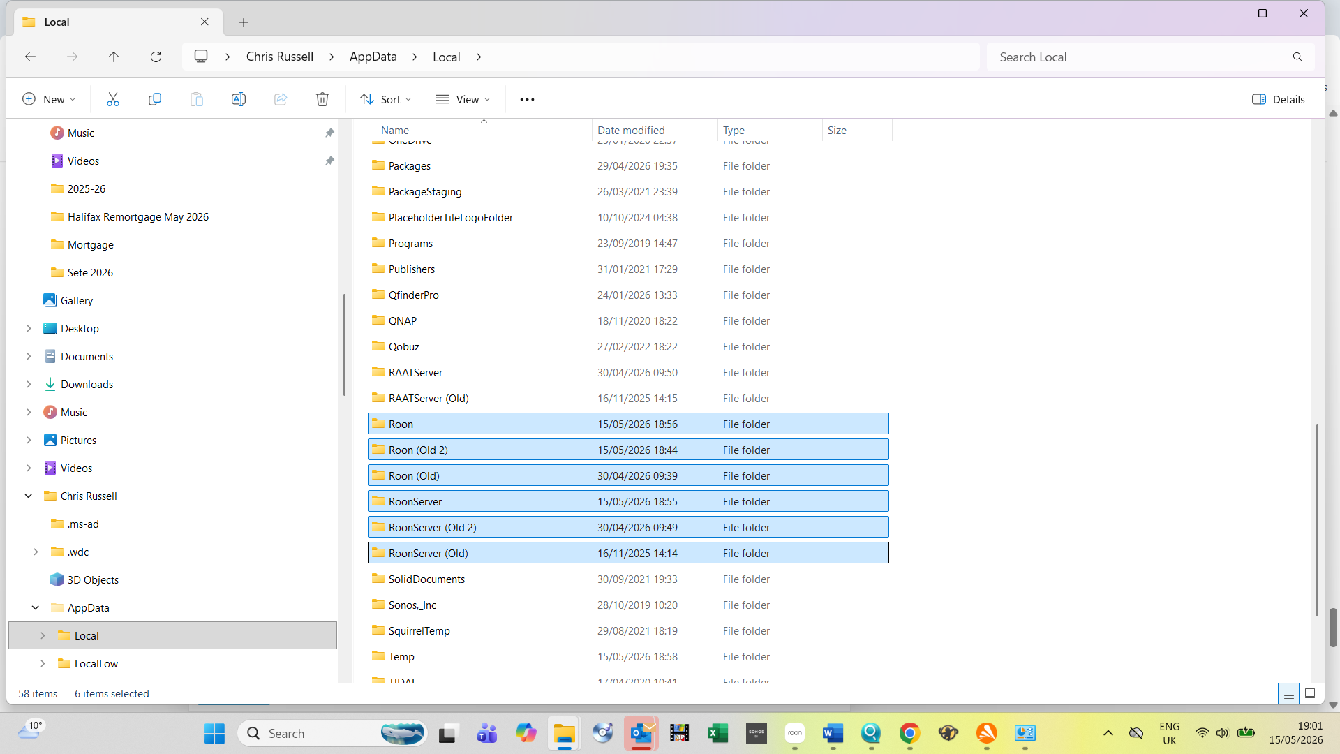

If neither help, on your windows 11, I’d be curious to see what happens if you perform a Roon app refresh. Steps are below:
On the PC:
  • Exit out of Roon
  • Find the folder that says “Roon”
  • Rename the “Roon” folder to “Roon_old”
See if you’re able to recognize the new instance of Roon Server afterward.

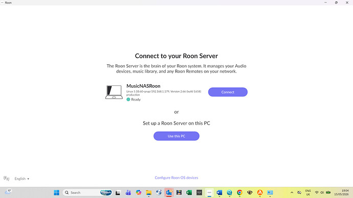

Apologies that my previous message was unclear and thanks for the suggestions.
I turned off my Avast firewall and still Roon only showed the old server. My NAS and laptop are both on the same subnet, at least the first 7 digits of the IP addresses are identical. I believe that confirms they’re on the same subnet?

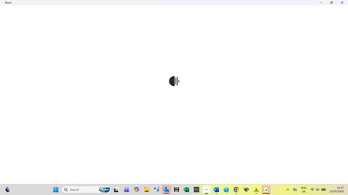

I also performed the Roon app refresh:
However, Roon is still showing only the old server:
And nothing happens of course when I press Connect.
Sorry this is proving to be a tough one. Do you have any other suggestions?

Hello again Vadim,

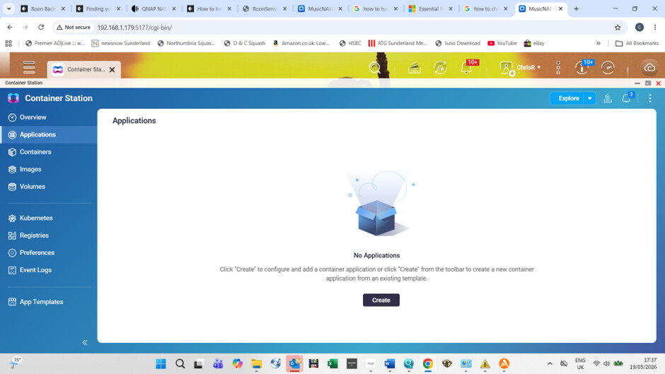

I stopped and then deleted (removed) Docker Station:
When I opened the Roon app, the MusicNASRoon server had disappeared and the Roon app opened on this page:
For clarity, before I deleted Docker Container, Roon showed the MusicNASRoon server but when I clicked on it, nothing happened. I just got the Roon logo icon indicating that it was searching for something but not finding it.
Also, in case this is helpful, previously I did try to Restore a Back-up, which took me to a folder structure (I’m not sure whether this was on the NAS or my Windows laptop) but the folder entitled Back-up appeared empty. At this point I’m pretty sure I didn’t press ‘restore’, I just navigated back to the previous page.

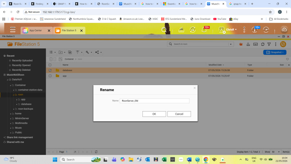

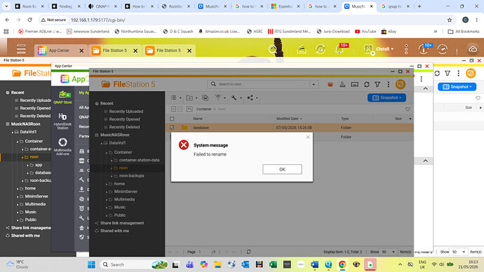

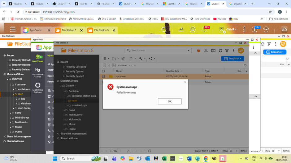

Thanks for that Vadim but I’m afraid I haven’t got very far.
I opened Filse Station and navigated to a sub-folder named ‘database’, within the Roon folder. I then tried to rename the folder ‘RoonServer_Old’:
However, the system failed to rename the folder:
Am I trying to rename the correct folder and if so, any idea why it won’t change the name of the folder? If you can confirm that this is the correct folder, I can try to rename it with a different name.
At step 1.4 (create new folder), what do you mean by “the original name”? Do you mean name the newly created blank folder as the original name of the folder that I (should) have just renamed (i.e. name the new folder ‘database’)?
At step 2.2 (create new application), I will input ‘roon-server’ as the application name (as I did last time) but where can I obtain the exact same YAML code I used previously? I still have the Docker Configuration Generator page open from when I did this last time. Is the code I used last time provided on this screen?
Sorry I haven’t made much progress but your further guidanec would be greatly appreciated.
It looks like the reason you are receiving a “Failed to rename” error is that the Roon container is currently running, which locks the files inside the database folder.
However, there is one more possibility to keep in mind if stopping the container doesn’t immediately fix the rename error: File Permissions.
1. Stop the Container
First, ensure the container is fully stopped in QNAP Container Station. If it’s running, the system will actively protect those files and prevent any renaming.

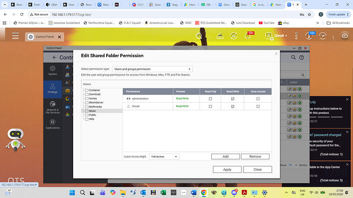

2. Check for Permission Conflicts
If you stop the container and still cannot rename the folder, it is likely a permissions issue. On QNAP, even if you are an administrator, the folder might be “owned” by the docker user or root, preventing your specific user account from modifying it.
  • The Shared Folder Workaround: Instead of using File Station, go to Control Panel > Shared Folders.
    1. Select the shared folder where your Roon data resides.
    2. Click Edit.
    3. Go to the Permissions tab.
    4. Ensure that your username has RW (Read/Write) access explicitly checked for the “Roon” folder and its subfolders.
    5. If you see an “Apply changes to this folder, subfolders and files” checkbox, make sure it is ticked.After saving these changes, go back to File Station, and you should now have the necessary permissions to rename the database folder.
3. Creating the New Folder
Once you successfully rename the old one, create a new folder and name it exactly database. This provides the empty, clean space Roon needs to initialize.
4. The YAML Code

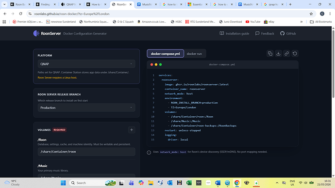

Yes, you have it right! If you still have the Docker Configuration Generator page open, that is the exact YAML code you used. You can safely copy that again.
One final note: When you recreate the container, please ensure that the “Environment Variables” and “Volume Mappings” in your configuration match your previous setup exactly. If the folder path in the YAML doesn’t match the location of your newly created database folder, the container won’t be able to “see” it, and it will fail to start.
Try stopping the container first, and if the error persists, check those permissions—let us know if you get stuck on the command line!strong text
Hello and thanks for the guidance. However, despite spending a lot of time on this, I haven’t been able to make much progress. I’m way out of my depth here and have managed to complete only some of the steps you suggested, as follows:
Step 1 (Stop the Container): The container was definitely fully stopped when I originally completed this step prior to your last response.
Step 2 (Check Permissions Conflicts): Within the permissions tab, the only shared folder that has my username listed is the ‘Music’ folder and read/write permissions for my username are confirmed by a tick in the corresponding box:
Step 3 (Creating New Folder): Your instructions don’t state which old folder you would like me to rename or where you would like me to create a new folder - so I haven’t been able to complete this step.
Step 4 (YAML Code): on the Docker Configuration Generator, which I still have open, I don’t know which is the YAML code. Also, I don’t know how to recreate the Container or how to ensure hat the “Environment Variables” and “Volume Mappings” in my configuration match your previous setup exactly. I don’t understand the final part of your guidance at all.
It’s over a month now since I lost access to Roon and I’m more confused now than I was before you guided me through all of the above steps. Woud it be possible to guide me through the remaining steps using screen sharing software please, so you can view my screen and show me what to do, step by step? I’m really lost off now and don’t know what to do next. If we are able to share screens and if you can provide hands-on guidance on what to do, I’d be extremely grateful.
