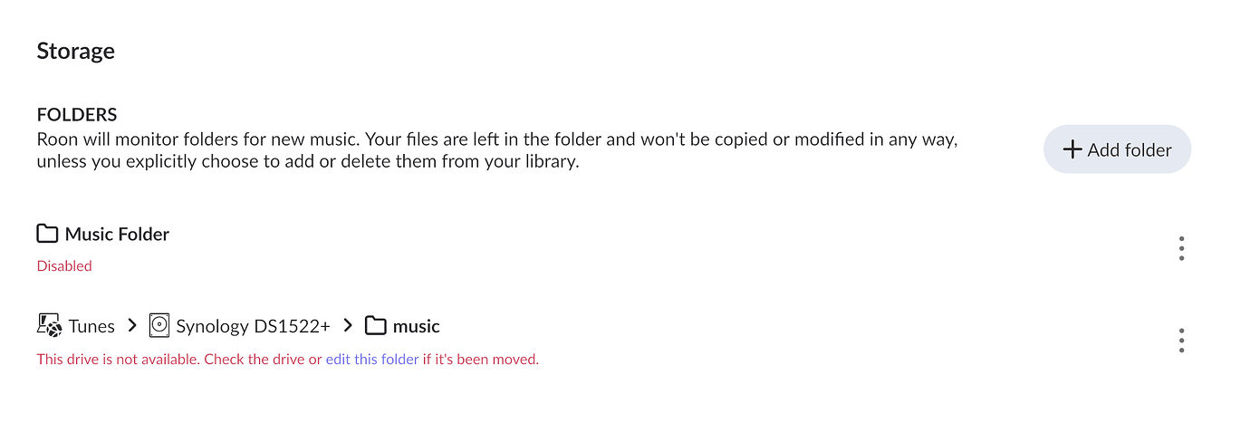

I ended up moving Roon to a Docker container. Just a heads-up: after restoring the backup, you need to update the storage path and backup path — then all the media will come back.
Indeed. It’s important to re-associate your old path using the “edit this folder” link, i.e.:

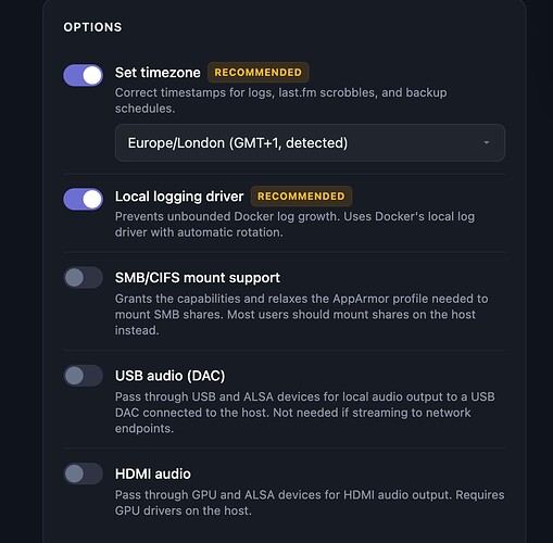

When you used the RoonServer Docker configurator did you select the USB Audio (DAC) option ?
Yes of course.
And, did you rebuild the container if/when changes to the configuration were made?

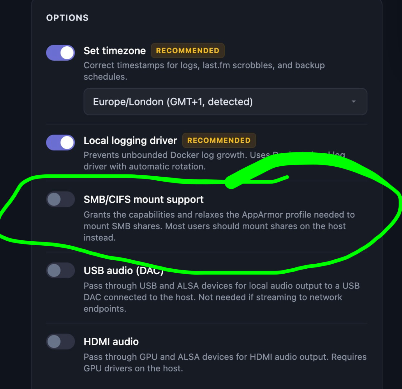

Also, I did not succed to add my Innous Zenith as a network folder, as it used to work before. I always receive an error when trying to add it (location: \\zenith\Music, user: guest, pw: innuos).
Any help is greatly appreciated.
Rainer
It seems you should mount it on the host (in which case the mounting has nothing to do with the container) and then use a path in the container configuration to pass the local mount to the container. Alternatively, enable the SMB option in the container config. Did you do either?
Thanks a lot, activating SMB mount support worked!
