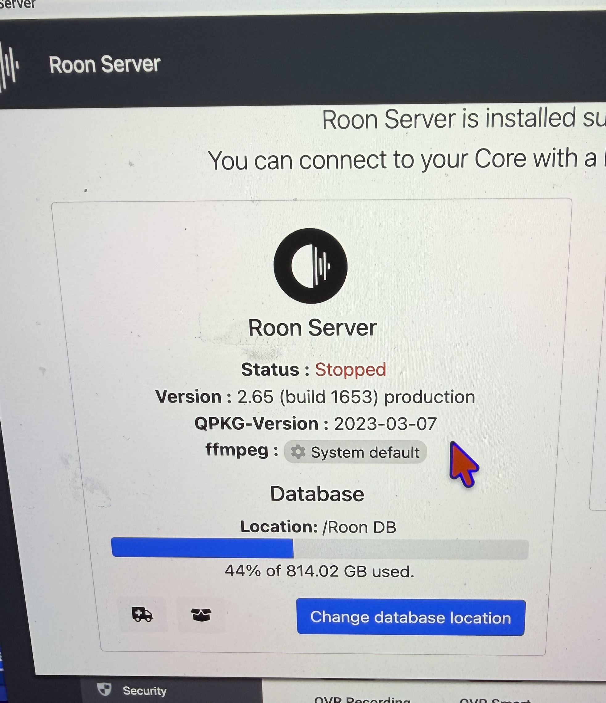

· My Roon server is on a QNAP drive. It was working until yesterday when I could not connect. The iphone/Macbook Roon app message was "Waiting for your server...." On the QNAP Roon server window, it showed status: "Stopped" in red. The adapter status showed "connected". I stopped, restarted, removed, re-installed, updated the QNAP Roon app (still 2023-03-07)without success. I rebooted the NAS. I refreshed the browser. I tried a new data location/folder with no success. I can send pics. I await your guidance. Thanks
· Verizon Fios Router with Ethernet cable to TP-Link TL-SG105S 2.5G switch with cable to QNAP. This setup working for weeks. I didn't anything. The QNAP front panel lights show appropriate colors and and lights so connected.
Hello @MARK_SWIDLER and welcome to the forum.-
The Roon Server package no longer works, please switch to the official Docker image to run Roon Server on your NAS. See also:

Hello @MARK_SWIDLER , and welcome to the Roon community!
Thank you for reaching out, and a big thanks to BlackJack for pointing you in the right direction. We completely understand that moving from a simple app package to a Docker installation can look a bit daunting at first glance!
To give you a little context on why this happened: the recent Roon update introduced new minimum system requirements. Because the native QNAP operating system relies on older software libraries, it can no longer run the standard Roon Server package (which is why it suddenly shows as “Stopped”). Transitioning to Docker allows Roon to run in an isolated environment with all the modern tools it needs, which actually results in much better stability and performance for your NAS moving forward.

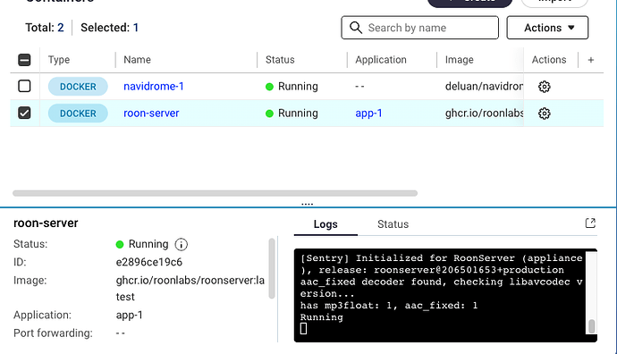

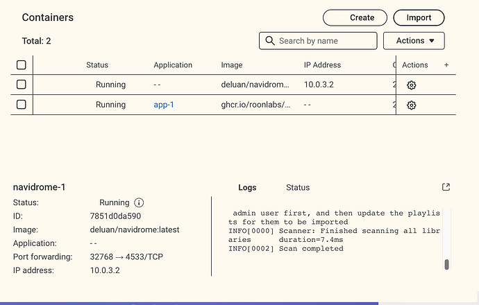

Here is the container setup on QNAP TS 264T. Do it look OK? If not what should I do? Still no luck getting QNAP Roon Server to work. When I try, I do switch off from MacBook server to QNAP so only using one Roon server at a time. In the QNAP Roon app, I click on upload new Roon program, a check mark appears but Roon continues to be stopped. Is there someone I can talk with who can guide me in real time? Please advise. Thanks
Hello @MARK_SWIDLER
Thank you for the screenshots. This shows that your Docker container (app-1) is successfully Running. This is now your actual Roon Server!
  1. Completely Stop the Native App: Go to your QNAP App Center (not the Roon window), find the Roon Server icon, and ensure it is Stopped. It is vital that the old app is fully deactivated so it doesn’t conflict with the new Docker version. Please confirm here once you have stopped it in the App Center.
  2. Connect via Roon Remote: Open the Roon app on your iPhone or PC. Click Disconnect and “Select a different Roon Server.” You should see the new Docker instance of your NAS ready to connect.

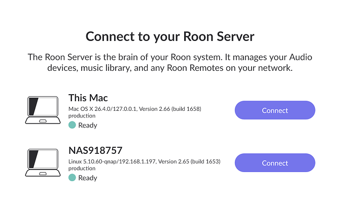

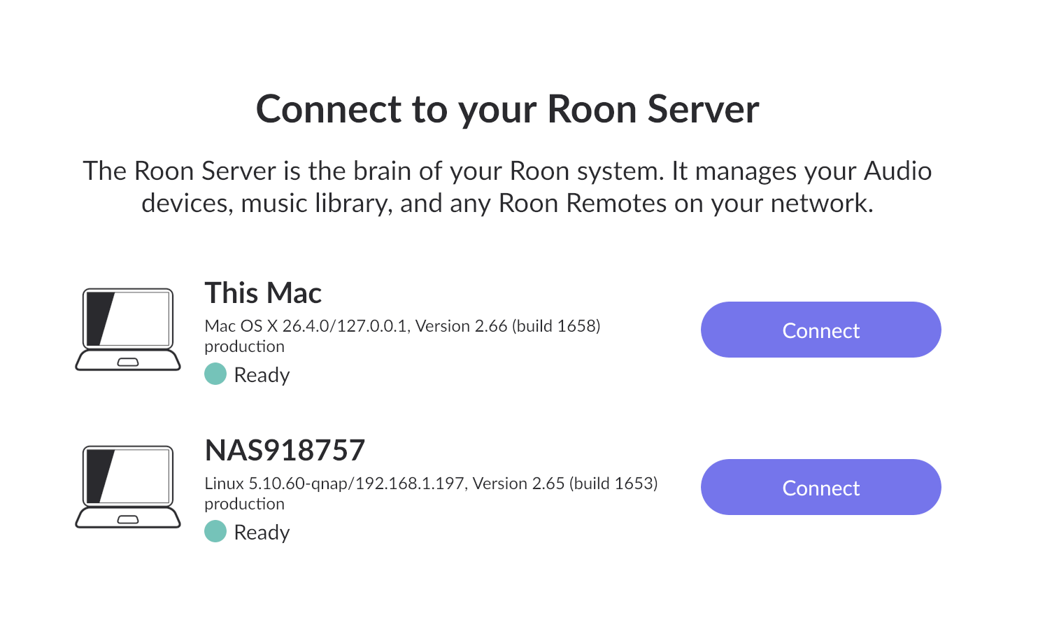

Hi Vadim, Thank you for your reply. I am still trying to make the QNAP work as before. I followed your instructions. I stopped the Roon App on QNAP. I went to Roon app on my MAC and clicked disconnect.What came up was image below. I clicked on the NAS choice. The Roon pinwheel appeared and is still spinning. Please advise. Thanks

Hello @MARK_SWIDLER,
Thank you for sticking with this process and providing those updates!
Seeing the QNAP-RoonServer listed in that window is actually a good sign—it means your Roon Remote (your Mac) can “see” the new Docker container broadcasting on the network. The spinning pinwheel, however, indicates it is hanging when trying to establish the actual connection.
This usually happens due to one of two things: either the database path inside the container is misconfigured, or the container is struggling to adopt a restored database backup.

  2. Restart the Container: Sometimes a new container needs a “kick” to fully initialize its networking. Please go into your QNAP Container Station, find the app-1 container, stop it, wait 30 seconds, and start it again. Then, try connecting from your Mac once more.

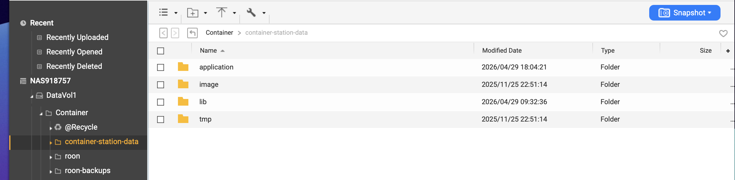

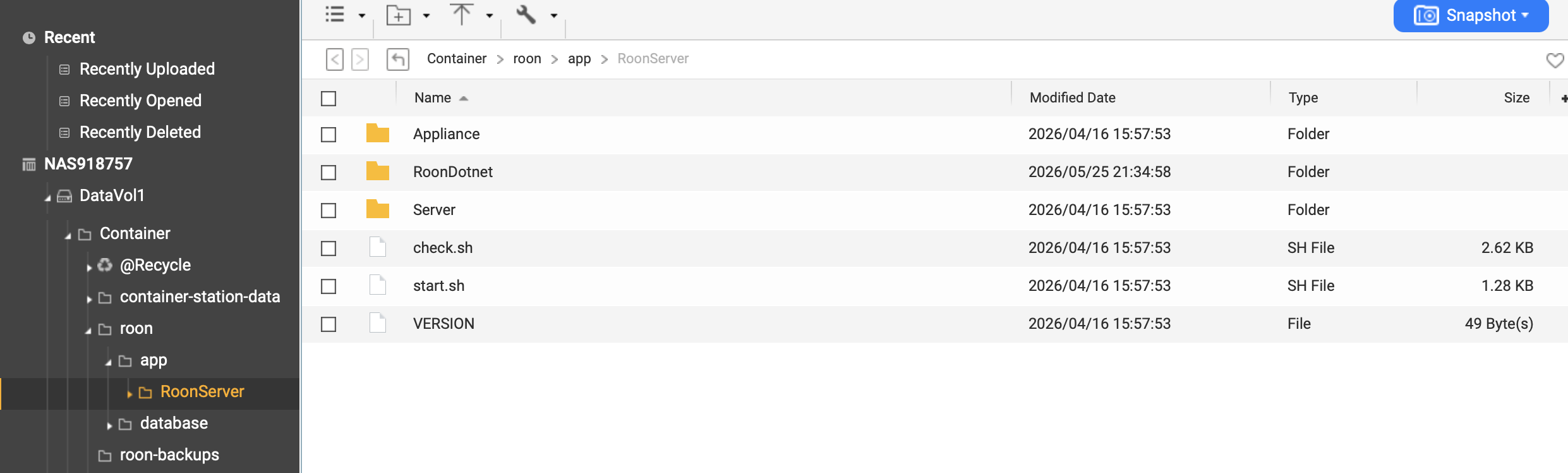

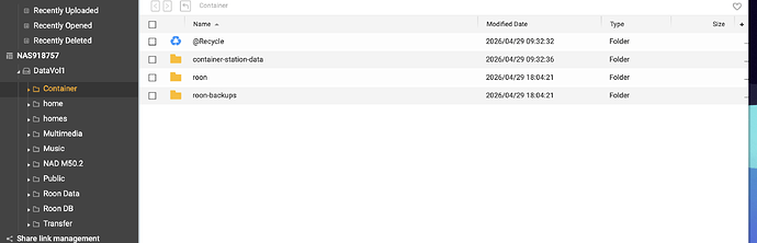

  1. Did you restore a backup? I dont remember doing it from scratch. Somehow, app-1 happened by chance. I was working on navidrome-1 as per prior instructions. The image below is what shows when I click on the app-1 in the container station. Does that help tell you anything?The image below is from my File 5 Station:

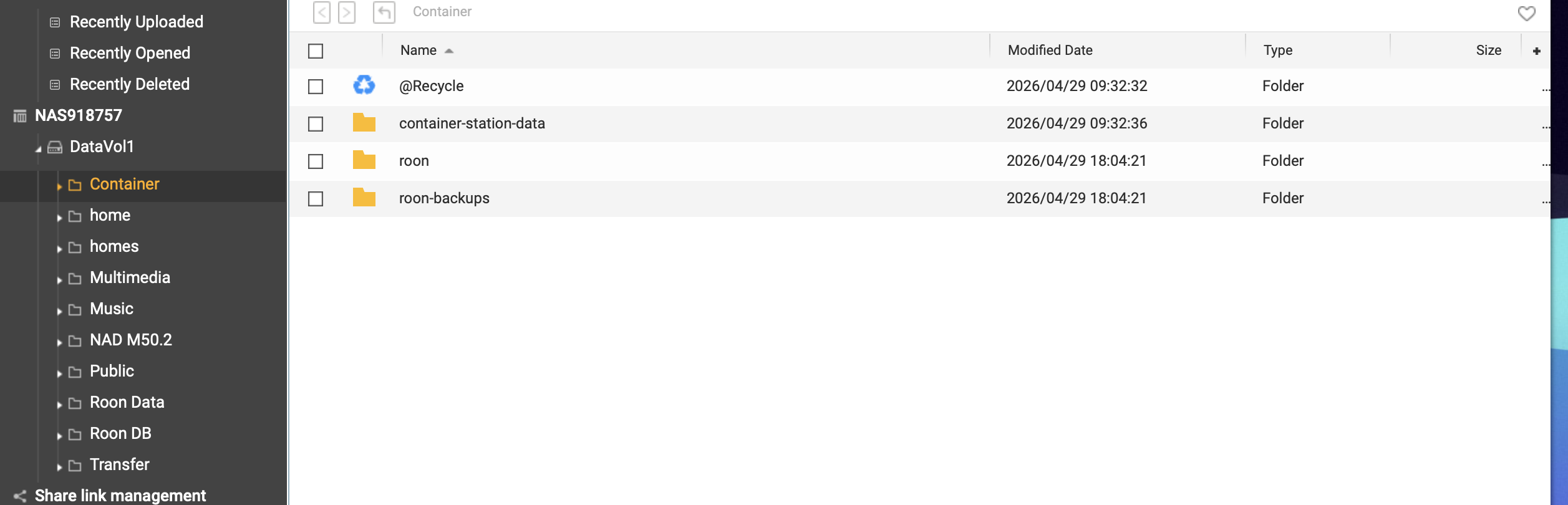

When I click on container-store data, I get:
When I click on roon, it takes me to roon server and following folders. below. ( at end of message. The roon-backup folder is empty.

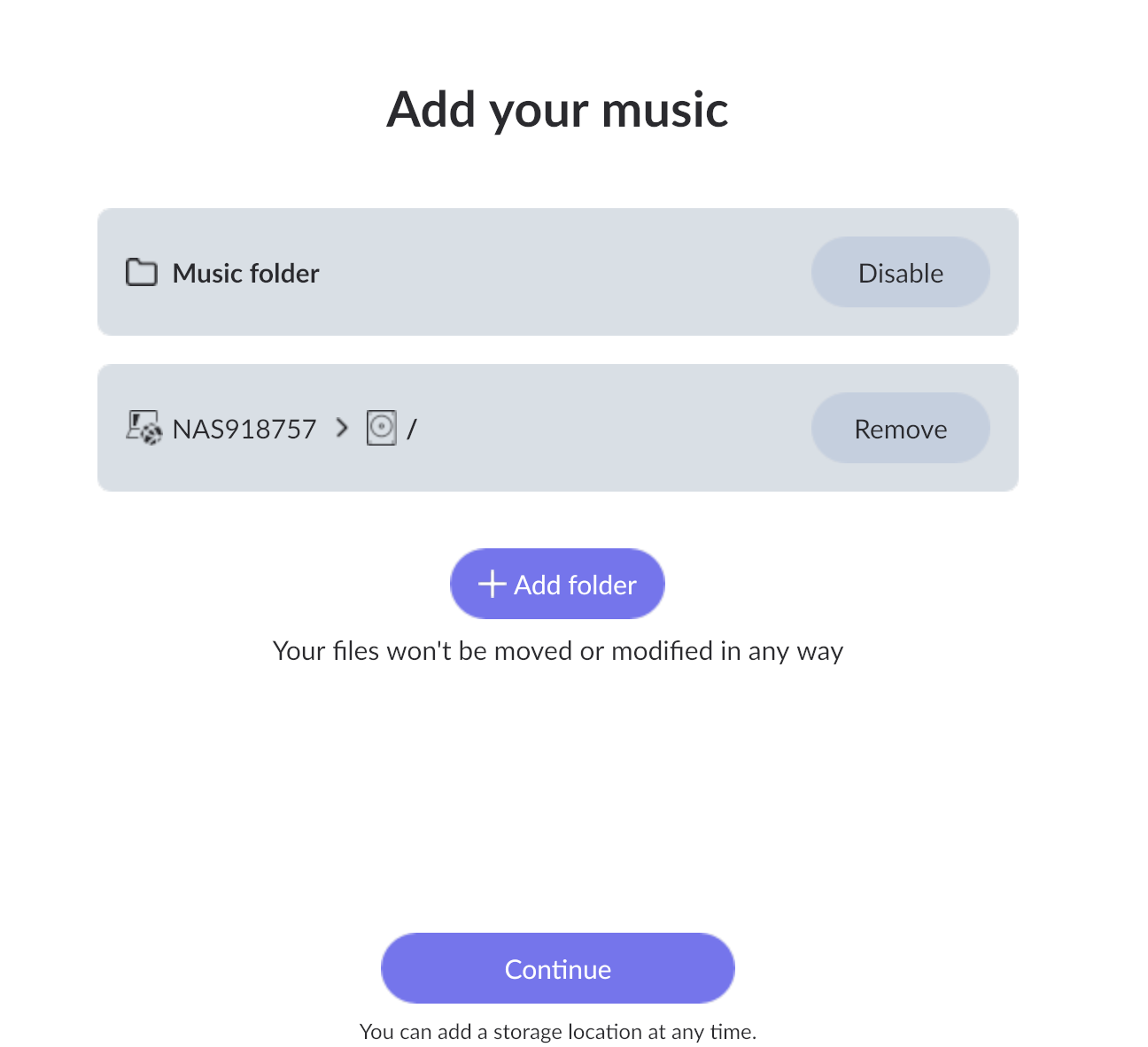

For # 2, I stopped the app-1 for 30 sec as directed. I was able to connect to Roon on my Iphone. I tried to connect using QNAP and the following window came up. Please advise on what I should do next.

Hey @MARK_SWIDLER,
Thanks for the follow-up and screenshots! Great progress, the fact that you were able to connect on your iPhone after restarting app-1 means your Docker container is working correctly. That’s the key milestone!
What you’re seeing now (the Roon setup screen on your iPhone) is Roon asking whether you want to set up fresh or restore from a backup. Since your roon-backups folder is empty, you’ll need to start fresh (unless you have a saved backup available elsewhere). Your library will need to be re-scanned but your music files are safe.
