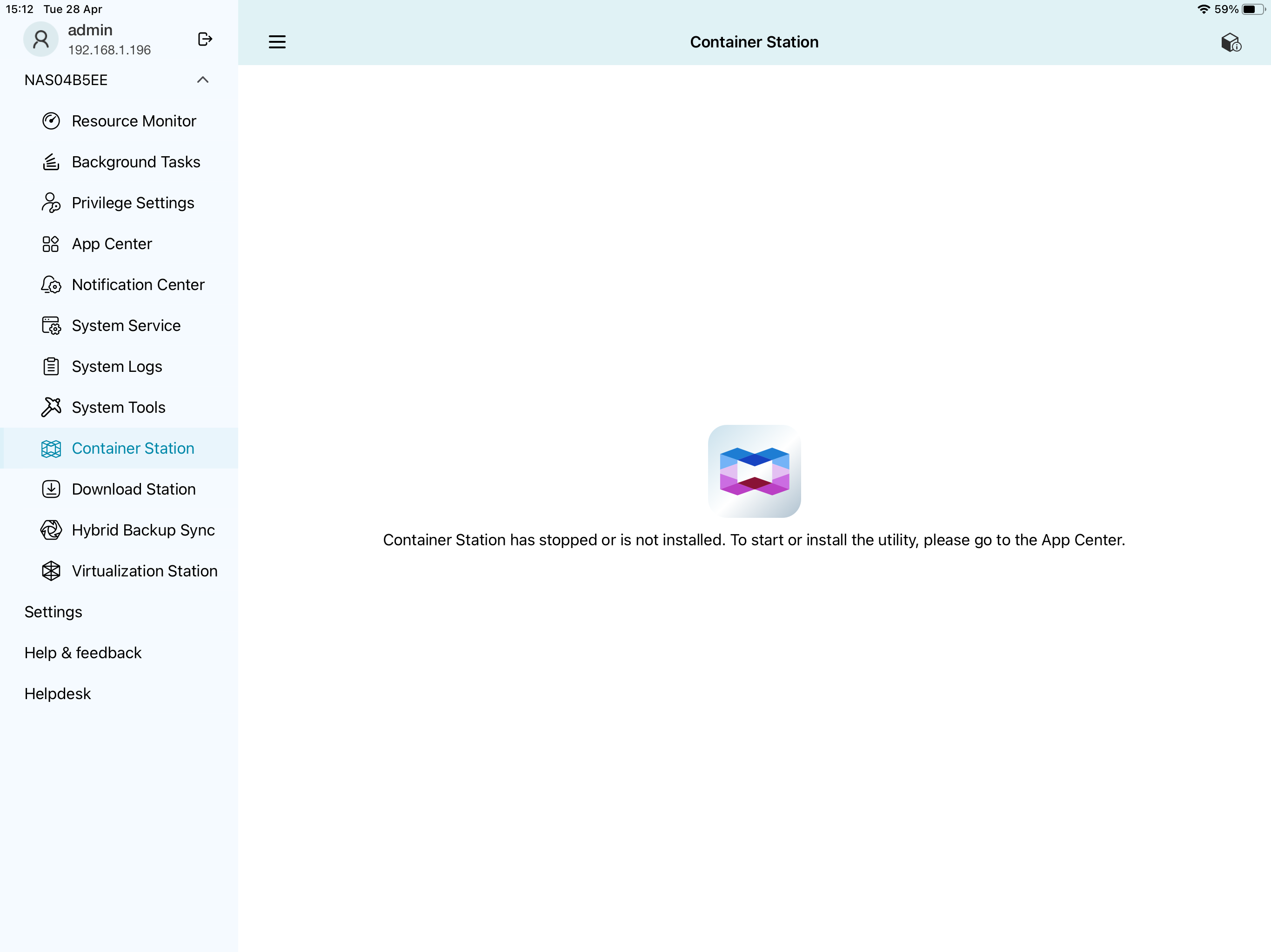

After installation of container station, it doesn’t prompt me to do anything, as described in the instructions. Back to where I started
When you open Container Station, what happens when you click on Create Application?
I don’t get there, just the image I posted earlier. That’s the problem. It installs but nothing happens. I did un install and re install.

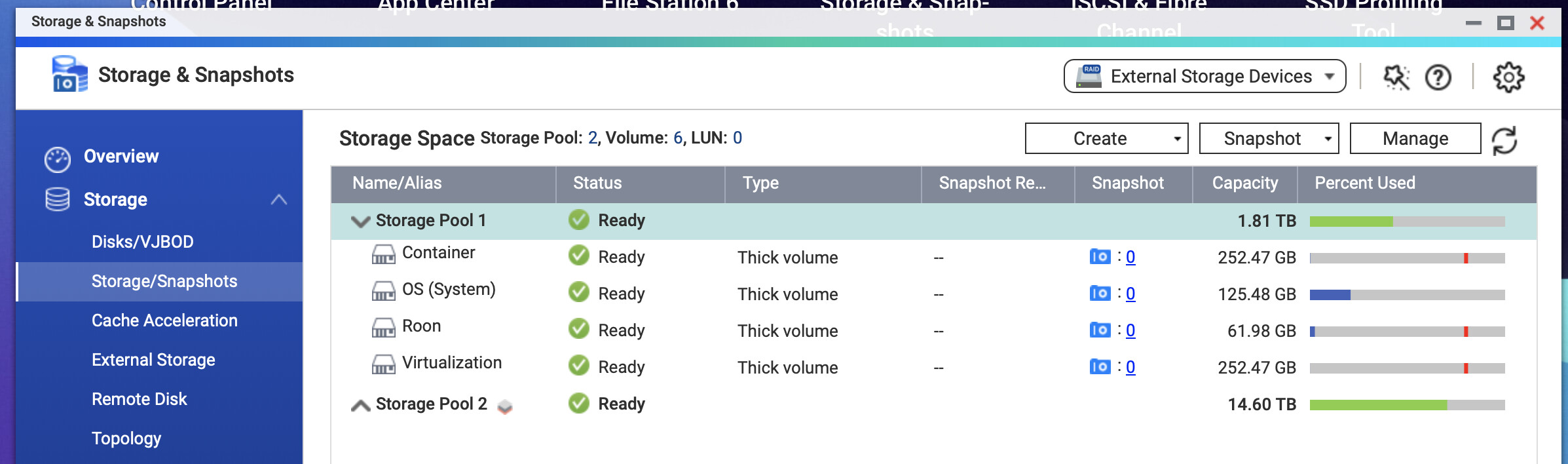

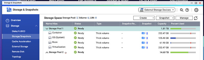

Where should I install Container Station? I have a choice of
SSD
Library or Back Up
It’s currently uninstalled till I have more of a clue what I’m doing wrong
i will guess that SSD (based on the name of the other 2 volumes); BUT, to be 100% sure, open “Storage & Snapshots” and navigate to “Storage/Snapshots” ; the volume marked as System , should be the one. NOTE: this is assuming , you were presented with that choice when trying to install “Container Station” from '“App Center”
Thanks again, mine doesn’t look like that at all, I’ll try to install in the library to see what happens. Nothing else I can do
What OS and version do you run on your NAS? Do you use the web interface of the NAS or some other administration tool?
I’m using the app on my iPad Pro
If I enter via a browser, I get Forbidden
Apache Server at 192.168.196.1 port 80
As far as I can tell, the app is to manage (Start/Pause/Stop) Container Station apps only. You can’t create new apps with it. That you don’t have any apps to manage currently might also be the reason for the message you see. Please use the web interface of the NAS to create the Roon Server Docker application. The web interface is also what the documentation is written for.
