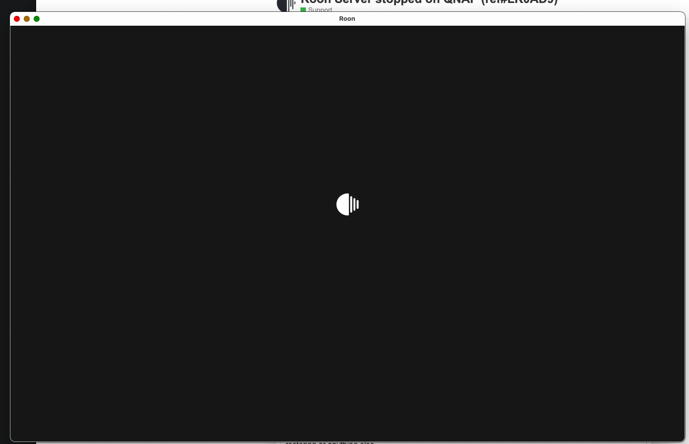

· The latest update forced the Roon application running on the NAS to stop. After researching the Roon community board, I followed all the instructions to install the QNAP container app, create the Roon application and then proceed to run Roon. The container application says Roon is running, but when I go to load the application on a desktop or mobile device, upon connecting to Roon, I get the white ball that shows it loading, but nothing comes up after that. The Roon applications see the server and want to connect, but the connection never completes bring up the server application. I have done the install multiple time with the same results. I was even able to go through a restore of my previous backup, but Roon on any device I'm trying to use to connect always stops at the same screen after linking to the server.

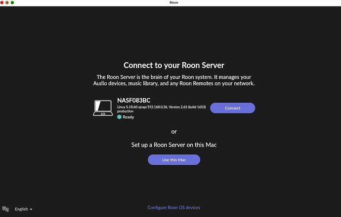

An additional screen shot that's displayed before connecting to the server.

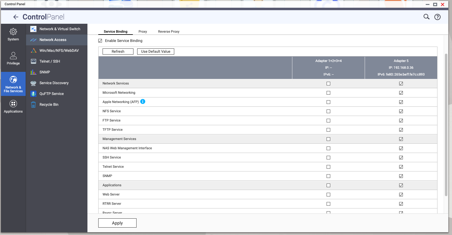

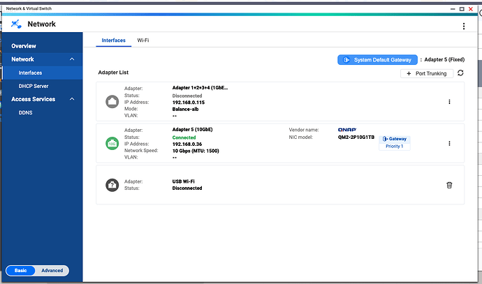

Hi Connor, I don’t have a firewall setup on my NAS and I do believe I turned off the other local IP ports on the NAS and only the 10GB port is connected to the network. Please see the attached pictures. That would be the only place I know to turn things off. Beyond that I’m not sure where to go to make additional changes and I dont have a clue what mode the Container Station is running in, I just installed the defaults and then followed the instructions on Roon to create the application. Also, the roon server in teh picture aboves IP address is pointing to the correct location. As far as I’m aware, nothing changed between the time of the update that failed and then my creating the oontainer and fllowing the docker application install.
