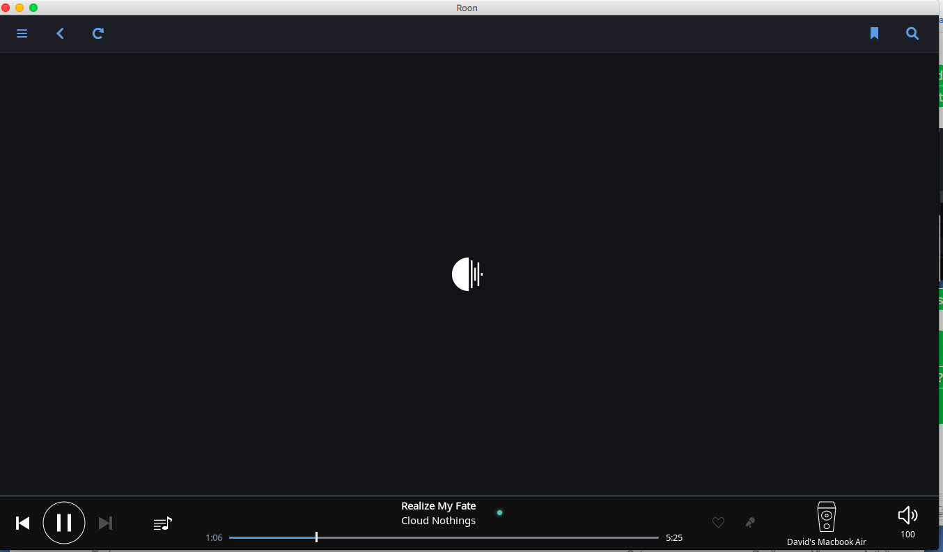

I’ve been having a bunch of trouble too. My QNAP is underpowered for sure, but it worked almost perfectly with 1.2 with only minor inconveniences where the remote would disconnect.
After updating to 1.3 (194), my processor is often pegged at 90-100% and RAM (8GB) is also often up in the high 80% range.
The symptom is that the system becomes totally unresponsive and hangs with the “looking for core” screen.
Is it possible that this new update is causing the processor to work that much harder, or does @crieke think that there might be something more going on with the QNAP implementation?

1.3 requires that all your files are re-analyzed, so that’s probably happening in the background and impacting performance. You can confirm this in Settings > Library.
Once that’s done, 1.3 should perform slightly better than 1.2, but generally speaking I would still recommend against an under-powered Core for a variety of reasons, including that you’ll probably have problems using DSP features.
Let us know how it goes once Analysis finishes @David_Korus. Thanks!

I’m getting this for long periods of time causing me to have to stop and re-start the Core.
