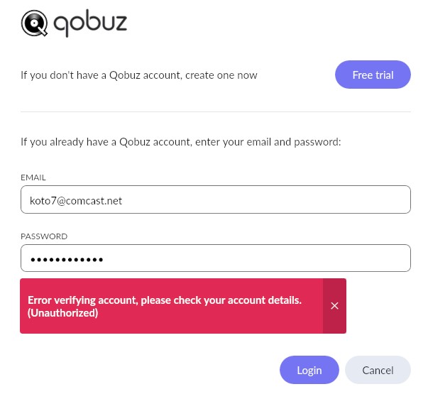

Cannot connect to Qobuz. In Roon, I get the following, "Error verifying account, please check your account details. (Unauthorized)".
Comcast Router - Innuos PhoenixNET Switch - Innuos Zenith Mk3 Streamer/Core. All firmware current and have been using Roon/Tidal for years without issue.
