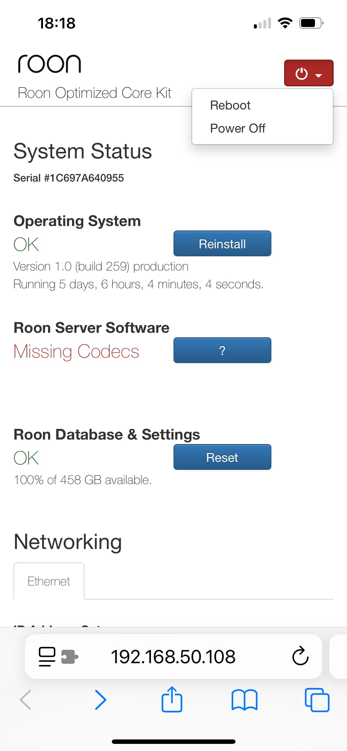

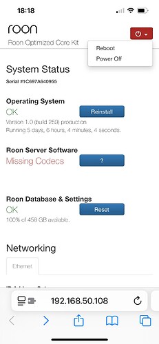

Hi,
Thanks for the response. I don’t see an option to halt the Web UI, only one to power off. I think this will shut down the NUC and I won’t be able to make the file changes you are recommending. What am I misunderstanding?

Hi @Rob_Eakins,
Thanks for the screenshot! Usually, you can stop Roon Server, but it looks like you’re running into a separate codecs issue here.
This KB should help you get things sorted out there:
Let me know if you have any questions and if you run into any hiccups along the way. Thank you! :+1:
Hi,
Thanks for replying. I have been using Roon for a number of years without ever setting up DACs on the ROCK. I am using external Roon-enabled devices to do the rendering. I can use Tidal and my stored music library just fine. I am just having trouble logging into Qobuz after the last Roon update.
Are you saying I need to set up DACs on the ROCK in order to have the option to stop the Web UI? I’m trying to follow the instructions in the first support response but I can’t complete the first step.

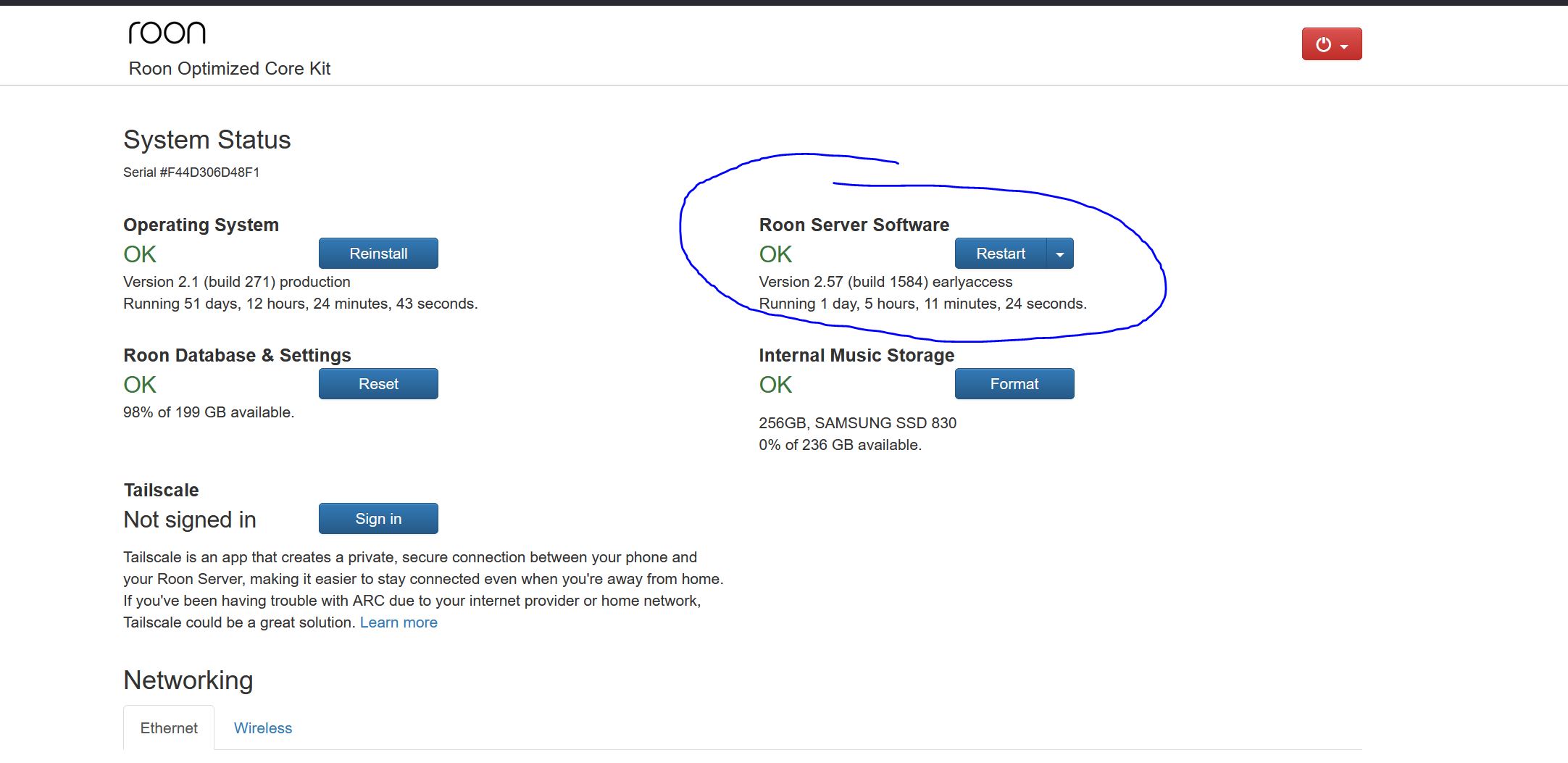

That looks like you are using a phone. Try using a Tablet or PC, and the screen should look like this…
If you click on the down arrow the button should present a drop-down with the STOP option to Turn the Server Software off.
Thank you for the quick reply, Daniel. Now I think I understand the confusion. I never installed the CODECs because I didn’t think I needed them but now I think that even if they are not needed to enable my DACs, I need them to enable all the server options. I’m going to follow the instructions to install the ffmpeg file and see if my screen has the restart option your screenshot shows.
