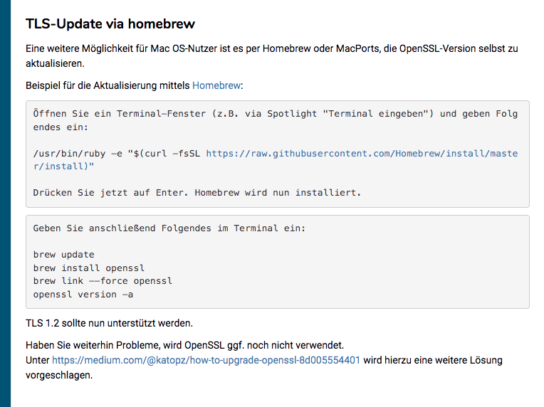

If the TLS version is the problem, could the following update help:
addition:
The error also occurs on my iOS devices. But tls 3 is installed there (checked with howsmyssl,com). Is the relevant tls version for the qobuz-api-request permanently specified in the ROON application?
Hello @Ralf_G ,
For your Roon Server to communicate with the Qobuz servers, you would need to be able to use TLS 1.2 or higher on the server. You can try the TLS homebrew update, it may help, but we cannot comment on specifics as we did not test it.
