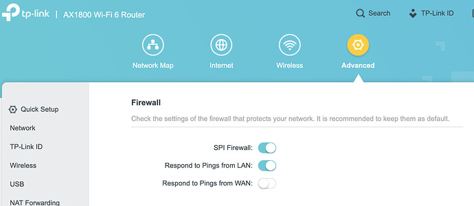

FIREWALL. Mac’s own firewall is off but in TP link router settings I found a firewall setting called ‘SPI firewall’ which is checked. Is that another firewall? Should I uncheck it?
thanks,
Thomas
Hey @thomas_barnes,
Thanks for the prompt follow-up!
Router firewalls are certainly important - keep it checked, on and active. This firewall helps protect your network by monitoring incoming and outgoing traffic. I don’t believe there are any granular options to make adjustments to this firewall, so keeping it enabled is our best bet!
Definitely keep us updated on how things perform with additional network allocation! We’ll be monitoring for your reply :+1:
