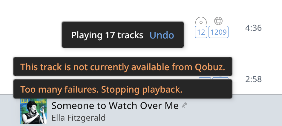

Can you please try to reproduce this issue and let me know the exact local time + date + track of the next issue playing Qobuz material? Once I have this information, I can take a look at the logs from the Core, thanks!

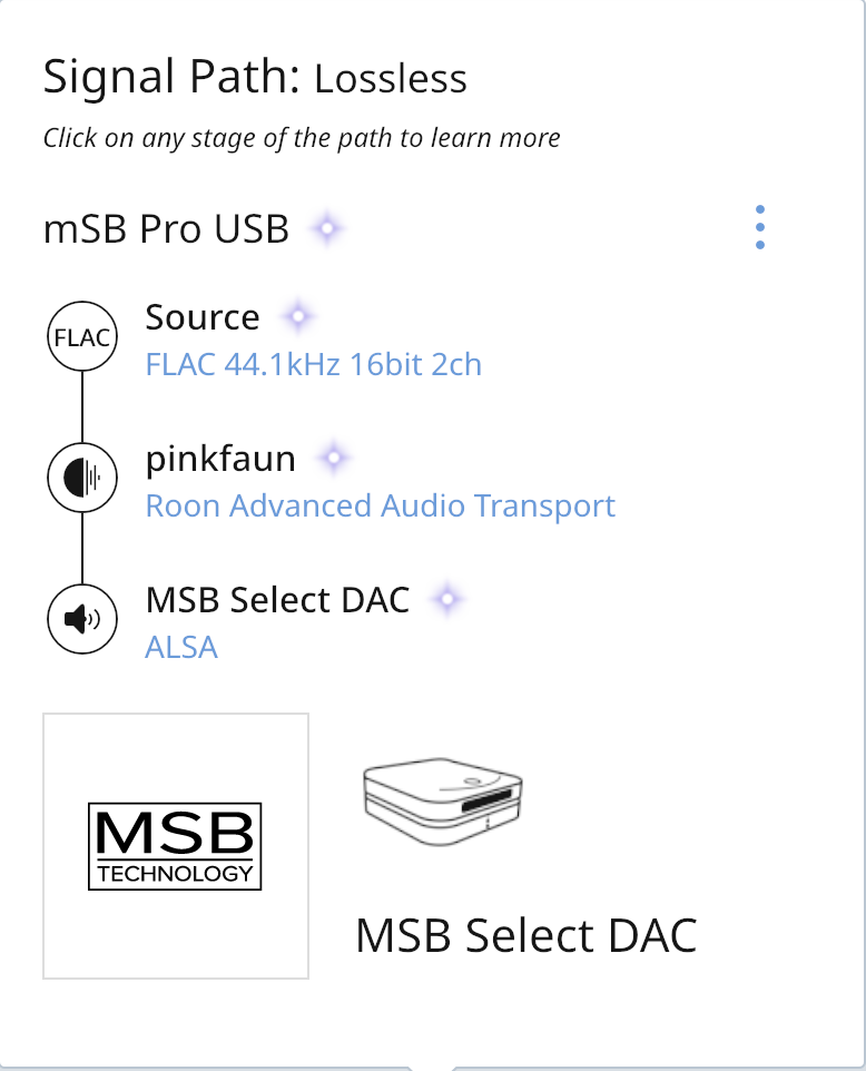

See the 2 screenshots.
I tried to play the track to the msb renderer and to the ipad i use as remote
When opening the qobuz application on the ipad and playing the same album it works
Time is Brussels time zone
Hi @Frank_VFS,
Thanks for sending those timestamps + screenshots, this is helpful.
