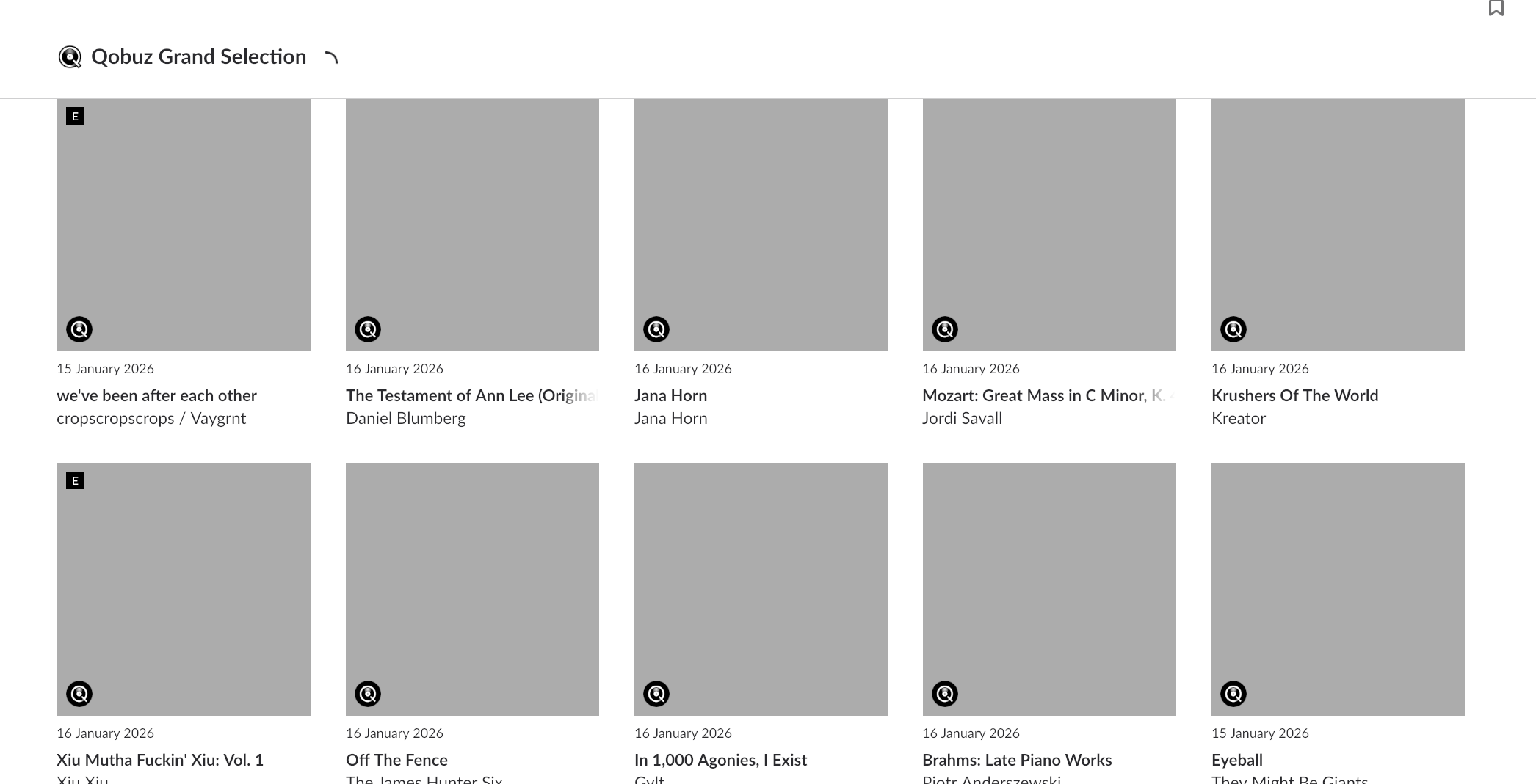

· Qobuz related pages are not working properly on client PC, they are freezed, loading and loading. The local albums look Ok, connection in Services Roon menu to Qobuz is alive, Qobuz app works. I have a feeling that smth wrong with Roon server connection to Qobuz. Can I check it somehow? Server installed on Linux machine. As an example: Qobuz Grand Selection screen freezed.

Hello @AllanB,
Based on the symptoms you’re describing — Qobuz pages and Live Radio loading indefinitely while local content works — this points to traffic being blocked or interfered with at the ISP or network level.
Roon relies on uninterrupted access to external services (Qobuz APIs, image and radio endpoints). ISP-level filtering, DPI, or partial blocking can result in exactly this behavior, where services appear connected but content fails to load.
Please note that ISP-level blocking or filtering is not officially supported by Roon. We recommend checking with your internet provider or testing temporarily via a different network connection to confirm.
Once unrestricted access is restored, Qobuz pages and Live Radio should load normally.
Vadim, thank you. Qobuz app works properly from my PC, no issues. I made internal check through another network - Roon became alive. Looks it is really ISP issue in some extra package filtering. Just contacted my ISP provider, they promised to check trace from my Roon server to the final package destination. Kind regards.
