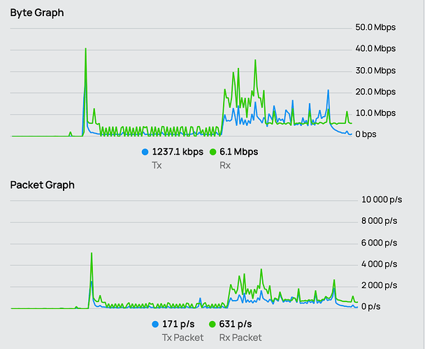

I have 2 network interfaces on my Mac mini; ethernet was enabled, wifi was disabled.
  1. [Hot spot] unplugged ethernet and connected via wifi to hot spot from my phone => no issues
  2. [Wifi] connected to normal home wifi => no issues
  3. [Ethernet] disabled wifi and plugged in ethernet => no disconnects, but log file is complaining “Warn: FTMSI-B-OE qo/C68D670A: poor connection kbps:6684,0 (min:6937,0)”
I have an unmanaged switch connected to the Mac mini on my desk; I will remove it from the chain and test again.
Re-tested without the unmanaged switch. No problems anymore.
So must have been the extra switch then…

Unfortunately problem is there again. The unmanaged switch is not there anymore.
As the problems went away after my previous testing, I tried that again.
Start is ethernet connected + continuous drop-outs.
Steps:
  • Enable Wifi on the Mac mini, disable Wifi on the Mac mini => issues still there
  • Unplug ethernet cable, plug-in ethernet cable => no issues anymore
So something must be going wrong over time, and replugging the ethernet cable fixes it?
Doesn’t take long for problems to re-appear by the way. Replugging fixes it again briefly, but this is not how to enjoy music… I’m switching to running the Qobuz app on the Mac mini. No drop-outs then. Just works.
