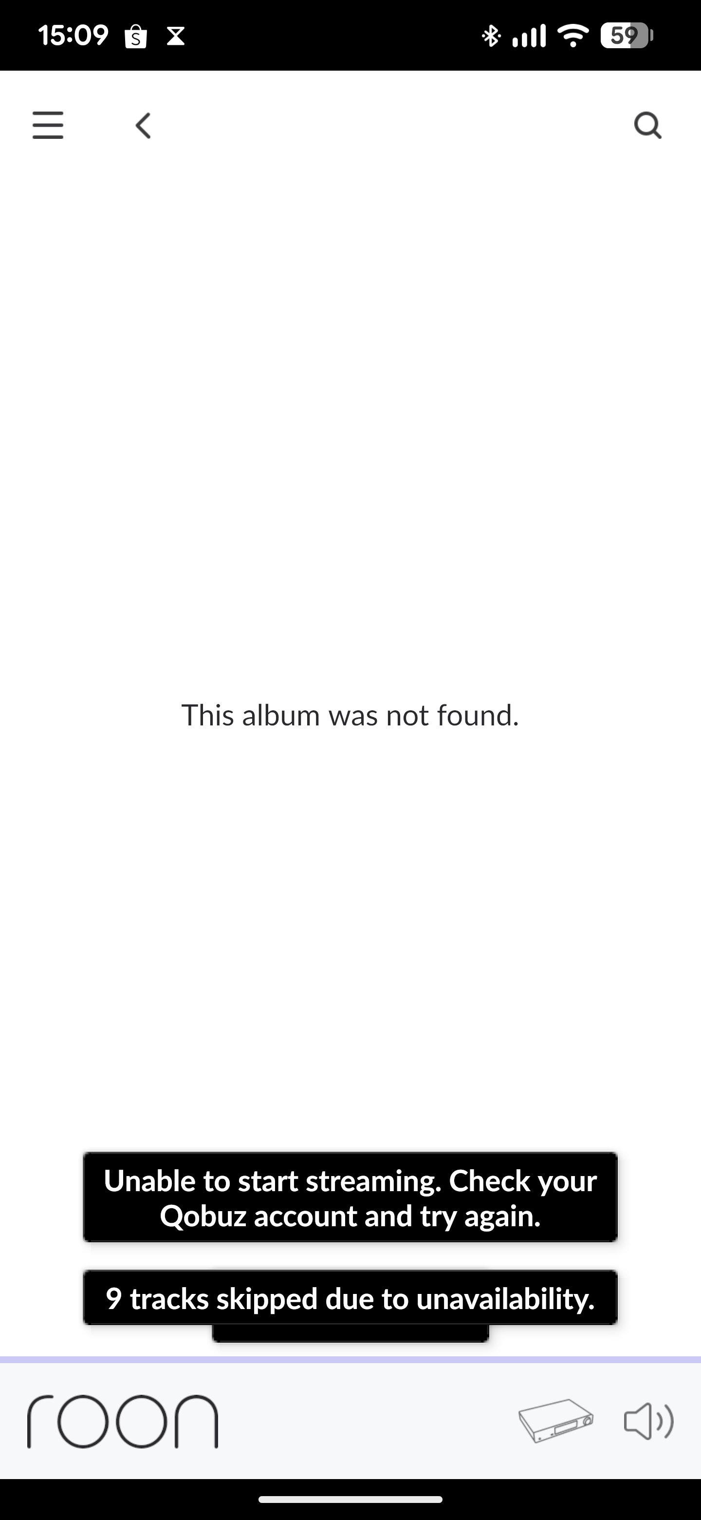

When the Roon system is idle for several hours (e.g., overnight or while I'm at work), attempting to play any Qobuz track results in a massive delay or failure.
Add images
Specifically:
  1. After hours of inactivity, pressing play on a Qobuz track causes Roon to hang.
  2. Sometimes it shows "Nothing to play due to unavailability".
  3. Other times, it shows "Starting playback on your device, this may take some moment" followed by silence, and the log shows RAAT dropouts or Endpoint disconnected.
  4. After waiting for about 30 seconds to a minute, or if I reboot the Roon Server package, playback returns to normal and I can skip tracks instantly.
