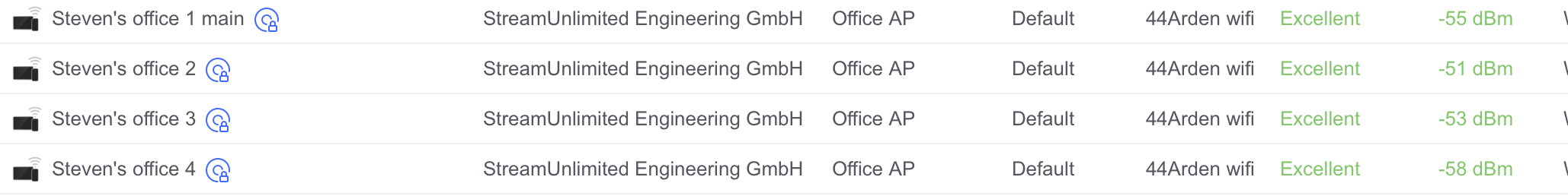

I have managed Unifi network. I run Roon Server on a M2 Pro 16gb. It is connected to the Unifi switch. I have multiple wireless zones. I am trying to play an album from Qobuz to my office zone. It plays about 10 seconds, stutters, stops, skips to the next track. Happens repeatedly and consistently. Have deleted and reinstalled Roon. No change. Hopeless. I also have an Innuos streamer connected to the same switch, which I use in my main hifi system. Using the Innuos Sense app (not the Roon endpoint) via uPnP I can play the same album from Qobuz to the same zone (as it does Roon Ready and uPnP) perfectly. So it's not my network, and as the Unifi app confirms excellent signal strength. I have turned off on-demand and background analysis. Please advise.
Unifi managed network. See main comment. One switch, multiple access points. It works perfectly with other audio systems.I've been Roon lifetime for perhaps 10 years, this network was installed in 2021, has up to 100 IPs running, never an issue, Roon never previously a problem. There is nothing else running in the M2 Pro.

This Zuma group is 4 devices. The main unit was .171, I did a restart and it transferred to .244, then back to .171 which was necessary because the bezel with Alexa was attached to that and needs to be on the primary. I tried again with the primary unit now .154. I’ll leave it there. The Alexa bezel is removed.
I also rebooted the AP. It’s pretty hot, so I’ve taken it off the wall, will let it cool a bit, and reattach. All the 4 Zuma devices are fixed to that AP.
All the AP’s are wired. Mesh is disabled.
The Roon Server is on ethernet but the wifi was on. I’ve turned it off.
“Is any UniFi bandwidth limit or User Group profile applied to the SSID or client for .171” I don’t know what that means, but I’ve got 25 of these units and I’ve not set anything.
I reattached the AP and the units are connected to other AP’s with much lower signals, but it’s sounding much better. See below - the signal is usually -45 to -55 give or take.
I’ve power recycled (the office power switch is on a Shelly relay) and hopefully I’ll get them to reconnect to the Office AP with a strong signal. It sometimes takes a bit of time for the switch to do what it’s told regarding AP fixes and then report correctly in the app.
It does seem the problem was having the wifi alive on the Roon Server.
If you want to check, it’s been on .154 for a while and I’ll leave it there.
Looking good, will test tomorrow.
All good now!
I must say, I’ve had my Unifi network for 5 years (24 port + 2 x SFP 95w PoE switch and 5 AP’s). I have 25 or more wireless Roon Ready audio devices working at up to 24/192 PCM and it’s never let me down.
Apple let me down by an update switching on the wifi.
