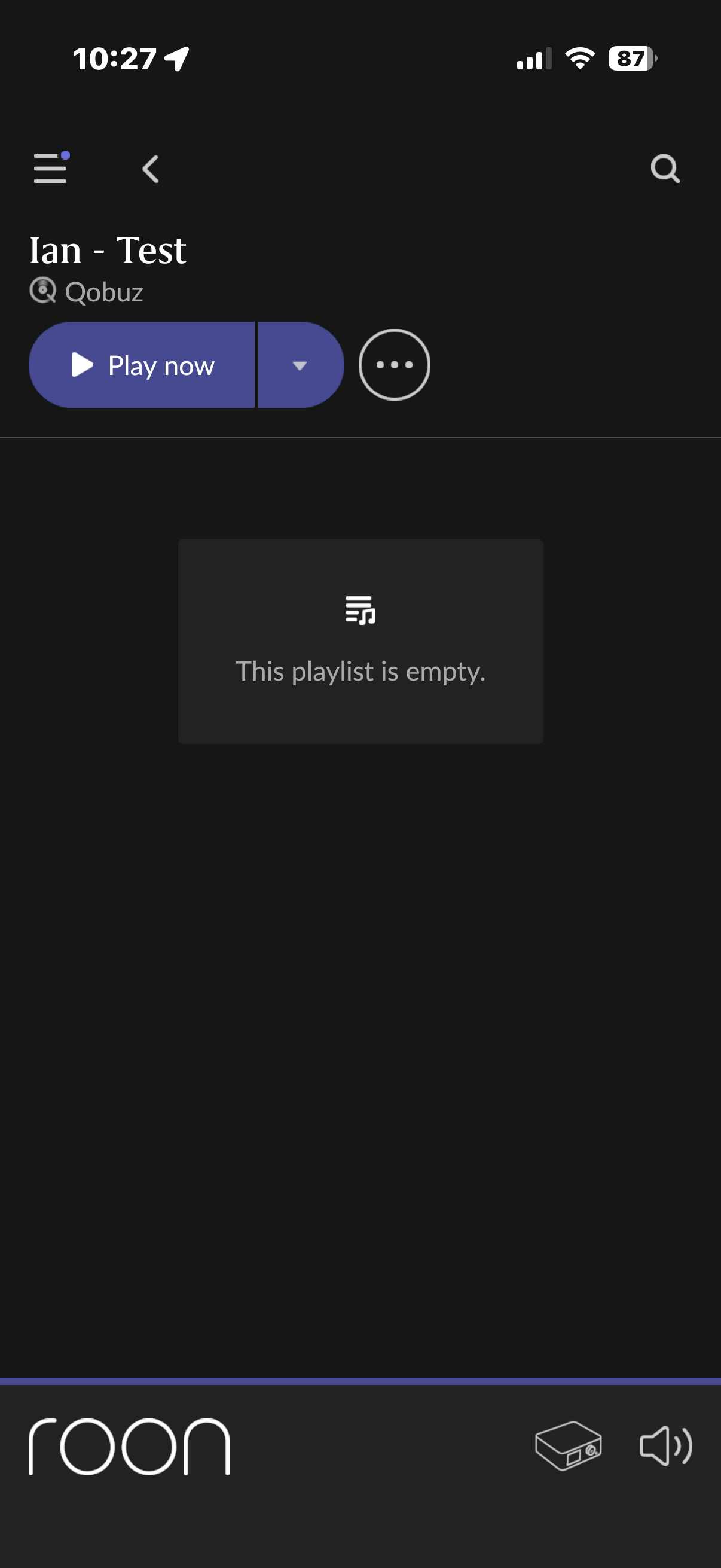

Qobuz playlists appear empty in Roon (ref#QFX1IU) [Resolved with Roon 2.71]
· Qobuz playlists that I created in qobuz are empty
· Ubiquiti dream router. Gustard N18 pro switch. Everything was working perfectly with these components, and all other aspects of qobuz / roon work, just the playlists are empty.

To the extent it helps, it seems that if I add a song to the playlist in qobuz, it then appears ok in roon.
I have a lot of playlists, so to manually go and add then delete a song from the playlist is tedious.
But it seems to somehow get roon to see the songs in the playlist again.

What you found fits how the sync works. Roon checks each Qobuz playlist for changes rather than re-reading all of them every time, so a playlist that looks unchanged gets skipped. Adding a track updates the playlist on the Qobuz side, which makes Roon treat it as modified and pull the full contents again. That is why your workaround works, and it also tells us something about where the fault sits, so it was worth reporting.
