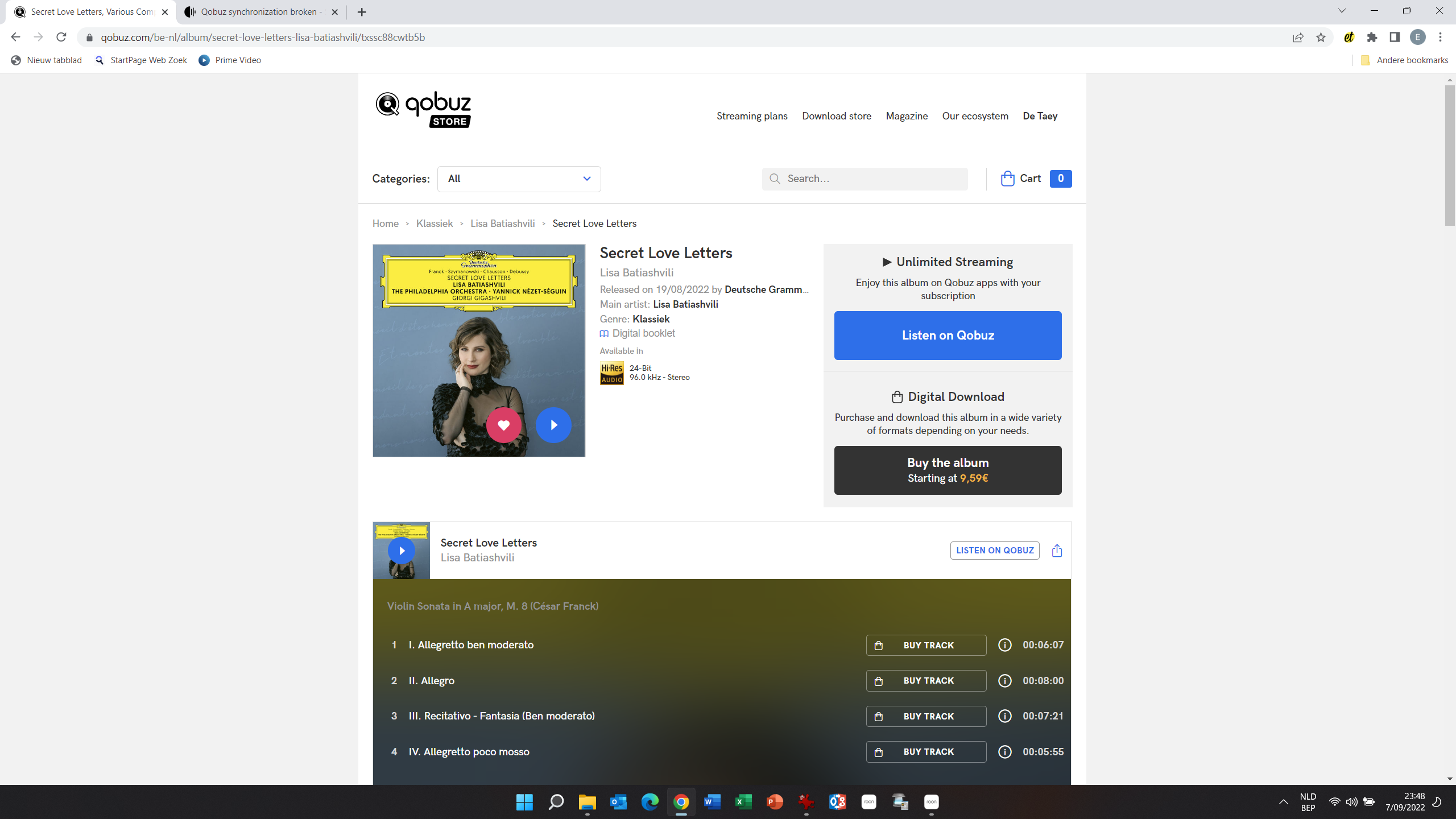

Important update and partial solution to this problem.
I have performed some additional tests, and came to the following bizarre result:
If I favorize an album in the Qobuz APP (on my windows PC), it is synced and added to My Library.
see the example of the Madonna and the Lisa Batiashvili albums.
If I favorize an album in the Qobuz webplayer, than the album is NOT syncronized and added to My Library. (initial problem).
@support: this is repeatable!!. Feel free to use my account to check for yourselves.
In Qobuz, I do not see any difference whether I favorize an album in either the APP or the website.
If I favorize in the APP, it shows favorized in the Webplayer, and is listed in in My Account- Favorites in the Qobuz account page.
If I favorize in the Webplayer, it shows favorized in the APP and is listed in my account details.
