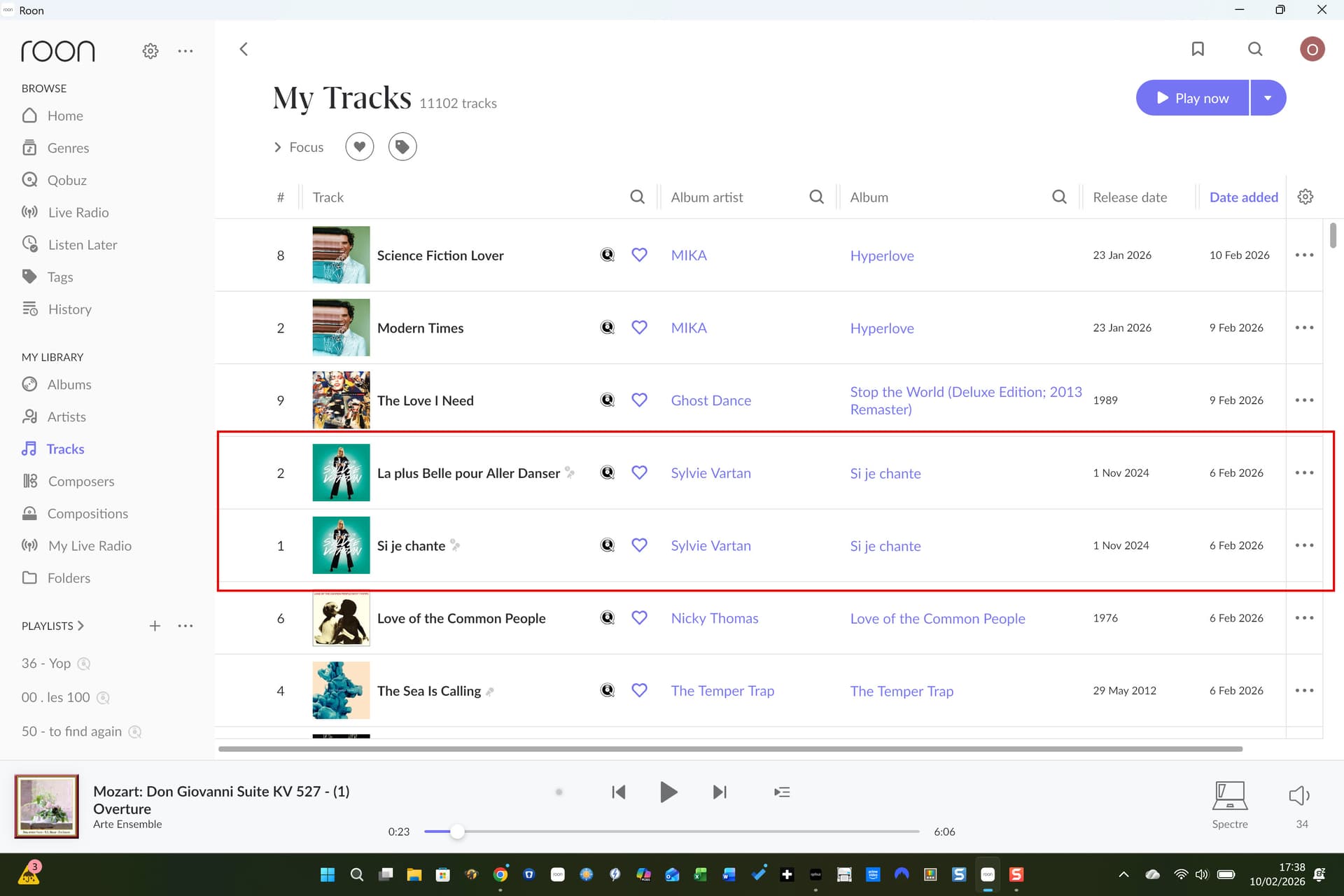

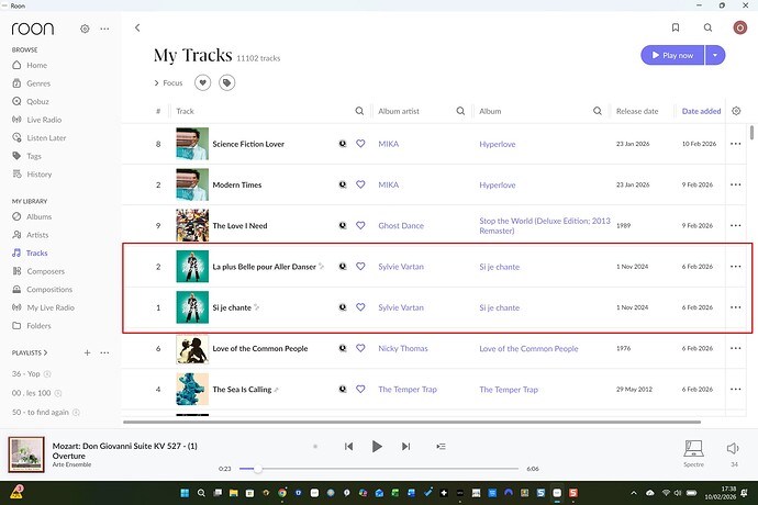

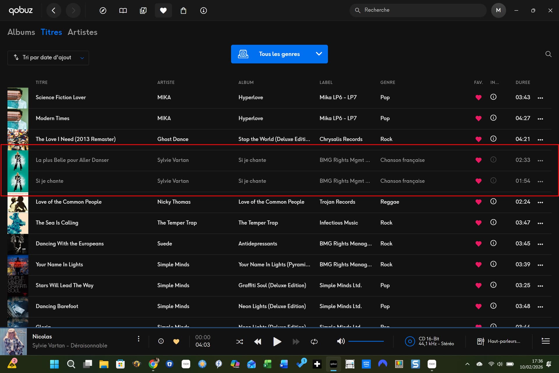

Hello @alex_h
Unfortunately, it’s very difficult to reproduce, and actually depends on Qobuz changing rights !
See below two screen copies, one from Qobuz, showing Sylvie Vartan’s tracks are not available, and one from Roon, with no special indication for Vartan’s tracks.
Note these I added 4 days ago only directly in Qobuz (they were ok at this time).
To be honest, this issue is probably caused by Qobuz, but Roon could remedy it and at least identify these tracks as unavailable.
If you look at this, you can see some clue that may help you spot the issue and offer a parade. I’ll be following this procedue this weekend (unless you tell me not too).
Hope it helps - thanks in advance for looking into this inconvenience.
BR
