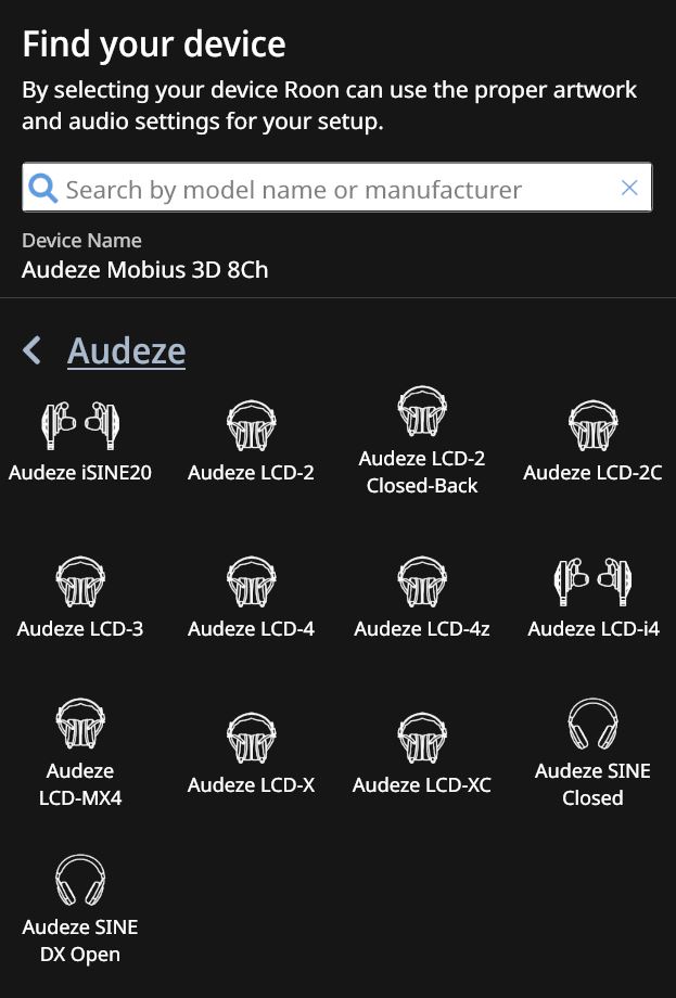

  1. Is it Roon that will add Mobius setting in the Find My Device page, or Audeze has to supply info? Please see below with all the Audeze models except Mobius.

Devices which pass our Roon Ready/Roon Tested certification are added to the device database. Since the Mobuis is not part of this program at the current time, it is expected that it would not show up in the find your device list.
@noris, thanks. Any chance Mobius will be added to Roon’s program?
