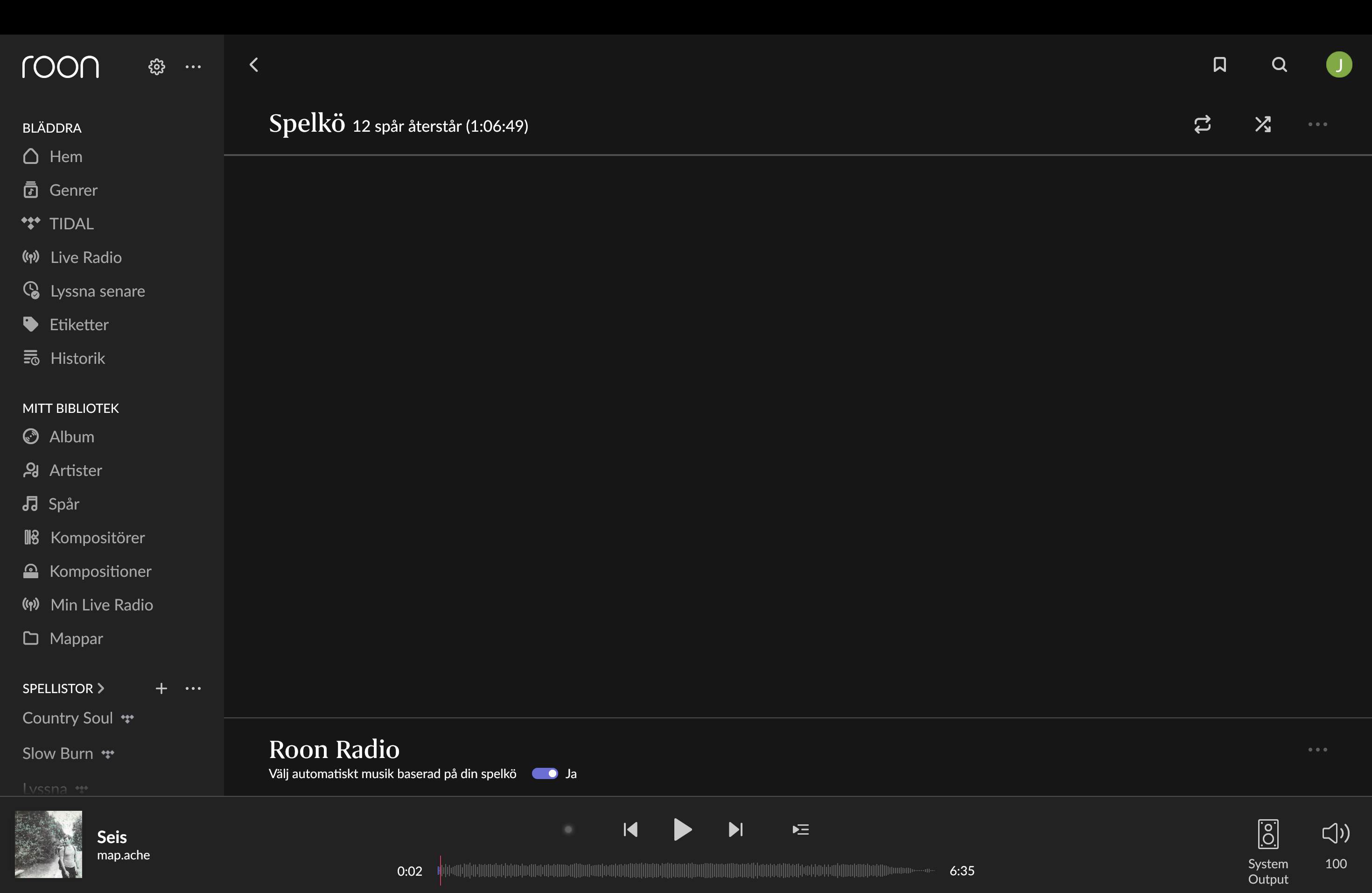

There seems to be a problem with the play queue. Does every zone have a separate queue? When I change output (from my McIntosh amp to System Output) it looks like the whole queue changes. Sometimes when this happens I think there is a bug. For example, it says that there are 10 songs in the queue and it’s 1 hour left, but there are no tracks to be seen in the queue. And when I press play, nothing happens. If I change the output there is a different queue, still empty, and it can’t play any audio here either. The song doesn’t even start

But this has happened a few times now. That when I press play nothing happens. I can use the interface, browse and everything, I just can’t play music. Not in any of the zones. And the queues look like the screenshot. It’s cleared, but at the same time it says that there are several tracks queued

If you try to scroll up/down on the queue screen, do the tracks then appear? What happens if you try to restart the Roon UI aspect (while leaving the RoonServer instance in the task bar active), does that correct the issue, even temporarily?
Restarting the UI didn’t help. Next time it happens I’ll try scrolling. And see if it’s there. Thanks!

@noris Hi, tried scrolling up/down when the problem happened again today. Didn’t solve it.
I restarted the UI and quit the whole app up in the taskbar and after that it worked again! The queue came back.
So hopefully, as long as this problem doesn’t happen too often, this could be an alright solution
