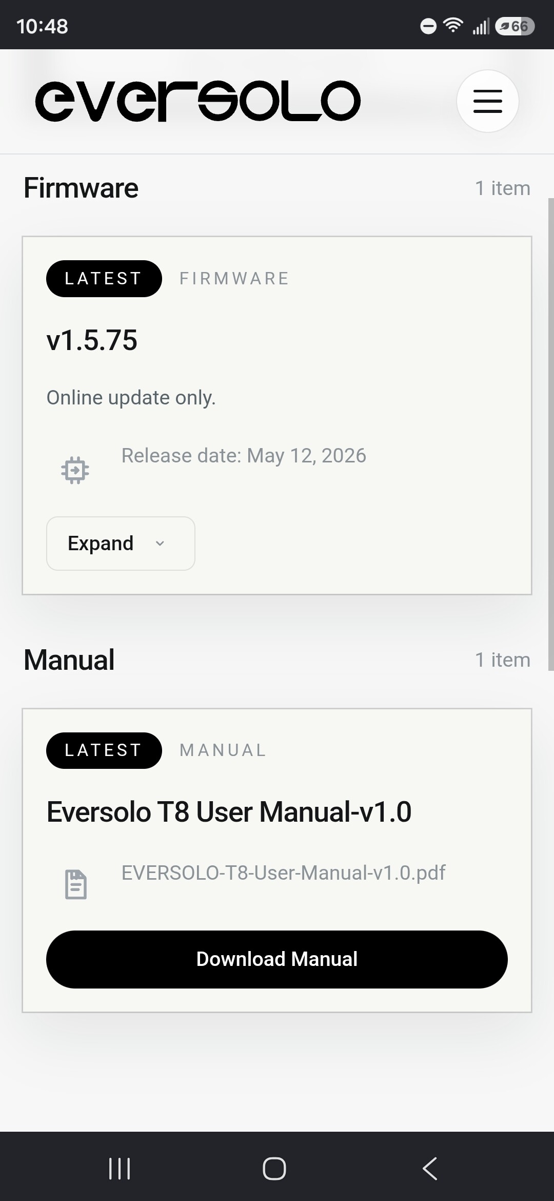

I’m confused the most recent firmware is v1.5.75 which I’m already running.
And Roon in device setup says max pcm rate is 384, when my DAC can do 768. I can get 768 pcm using hqplayer to the t8 but I’d rather use roon.
Hi @Rugby,
Sorry for the confusion. The firmware number to which we were referring previously was on a testing track.
V.1.5.75 was released in early May; from our communications, Eversolo should be restoring this compatibility with the subsequent update.
