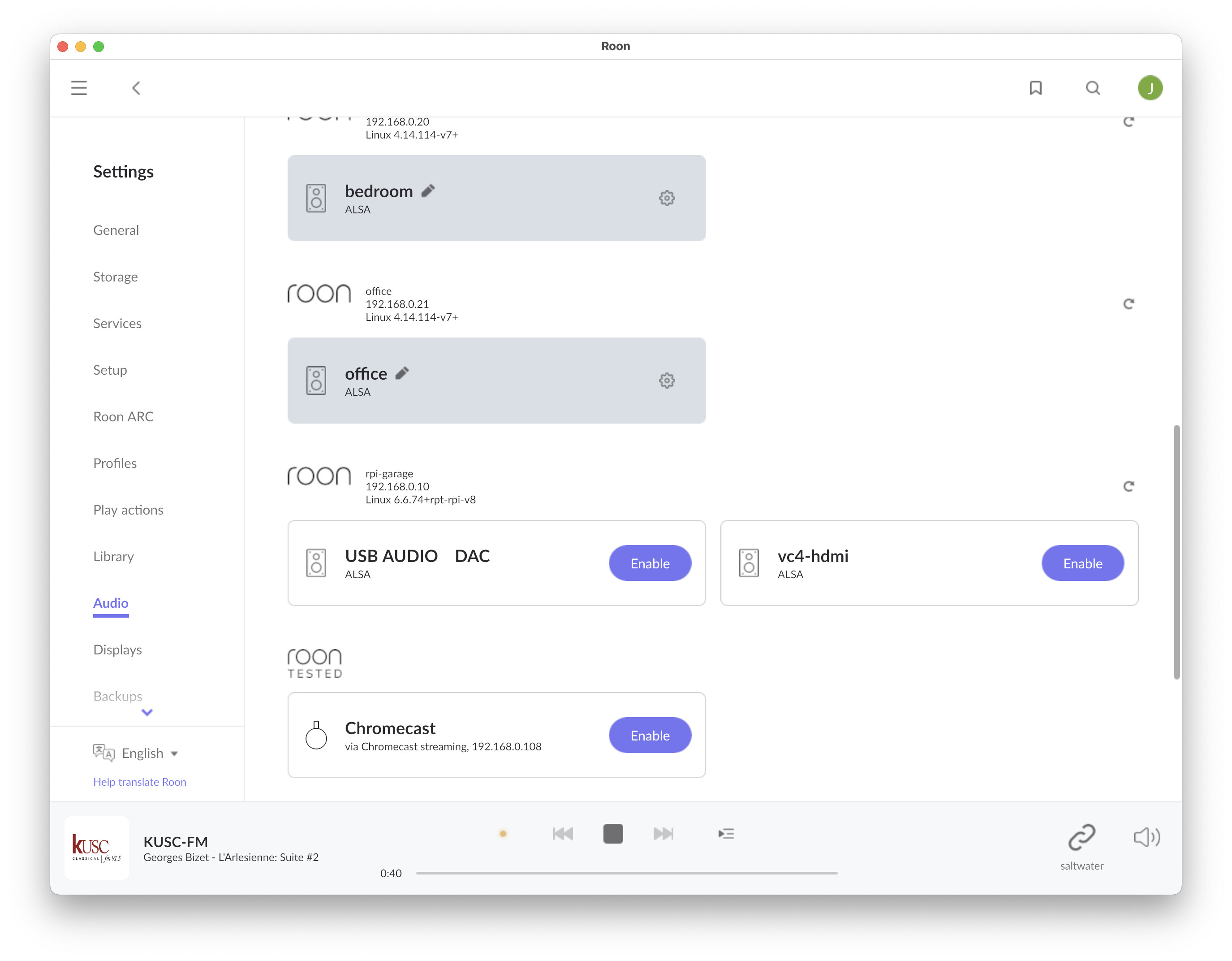

I have several Roon zones using Raspberry Pi 3B+ with HifiBerry audio hardare, chromecast, and android devices. Wifi is Netgear Orbi with repeaters and all wifi devices are on 5GHz band. Everything works fine. If I start getting latency and Roon issues I reboot the Orbis and the DGS-1210-10 Gigabit Ethernet Switch, which always resolves any issues.
This specific problem, which your support wizard is incapable of diagnosing, is that I have a Raspberry Pi 3B+ (armv8 64bit) for which I want to use the HDMI output and Roon Bridge to use a cheap soundbar that has only HDMI input.
The HDMI audio works OK. I’m using a LG monitor which has speakers and can be used as a TV for testing. I’ve disabled (in config.txt and the raspi-config) the brcm2852 audio interface leaving only the vc4-hdmi audio device.The following shows the audio device info and example music commands which cause music to play through the monitor:

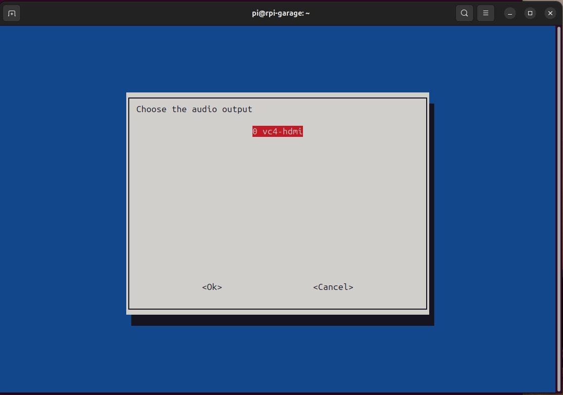

ALSA finds the device OK but I’m not sure how to interpret this:
$ cat /proc/asound/vc4hdmi/pcm0p/info
card: 0
device: 0
subdevice: 0
stream: PLAYBACK
id: MAI PCM i2s-hifi-0
name: MAI PCM i2s-hifi-0
subname: subdevice #0
class: 0
subclass: 0
subdevices_count: 1
subdevices_avail: 1

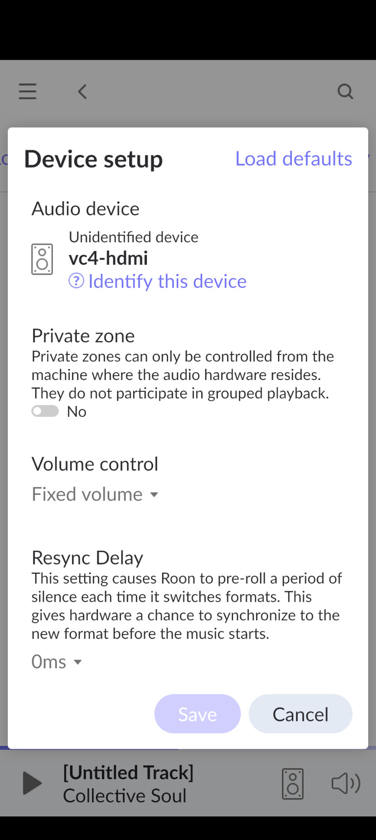

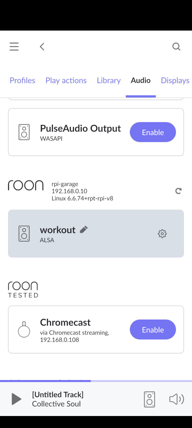

After installing Roon Bridge for armv8 linux the zone shows up in the app as shown in the attached screen shots.

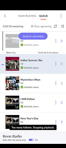

Nothing will play however and RAATServer logs the error RAAT__OUTPUT_PLUGIN_STATUS_FORMAT_NOT_SUPPORTED in /var/roon/RAATServer/Logs/RAATServer.log.txt:

I should mention I’ve mucked around with /boot/firmware/config.txt and cmdline.txt:
pi@rpi-garage:/boot/firmware $ cat cmdline.txt
console=serial0,115200 console=tty1 root=PARTUUID=fd2b6370-02 rootfstype=ext4 fsck.repair=yes rootwait cfg80211.ieee80211_regdom=US vc4.force_hotplug=1
and
pi@rpi-garage:/boot/firmware $ cat config.txt
# For more options and information see
# http://rptl.io/configtxt
# Some settings may impact device functionality. See link above for details
# Uncomment some or all of these to enable the optional hardware interfaces
dtparam=i2c_arm=on
dtparam=i2s=on
dtparam=spi=on
# Enable audio (loads snd_bcm2835)
#dtparam=audio=on
dtparam=audio=off
dtparam=hdmi_drive=2
hdmi_drive=2
hdmi_force_edid_audio=1

Hi @James_Ockers,
Thanks for reaching out to us about this issue. Are you still having trouble after setting up MUSE?

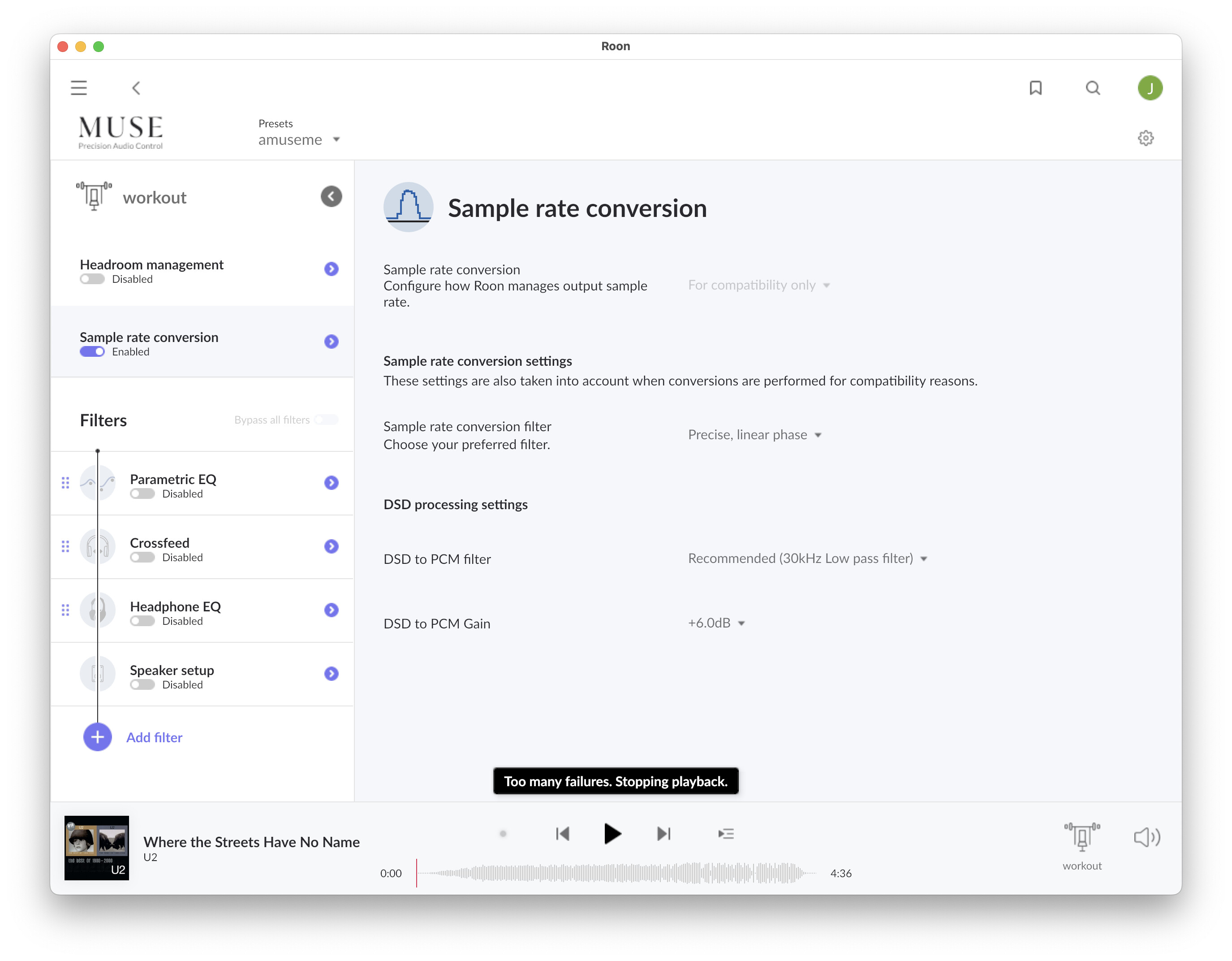

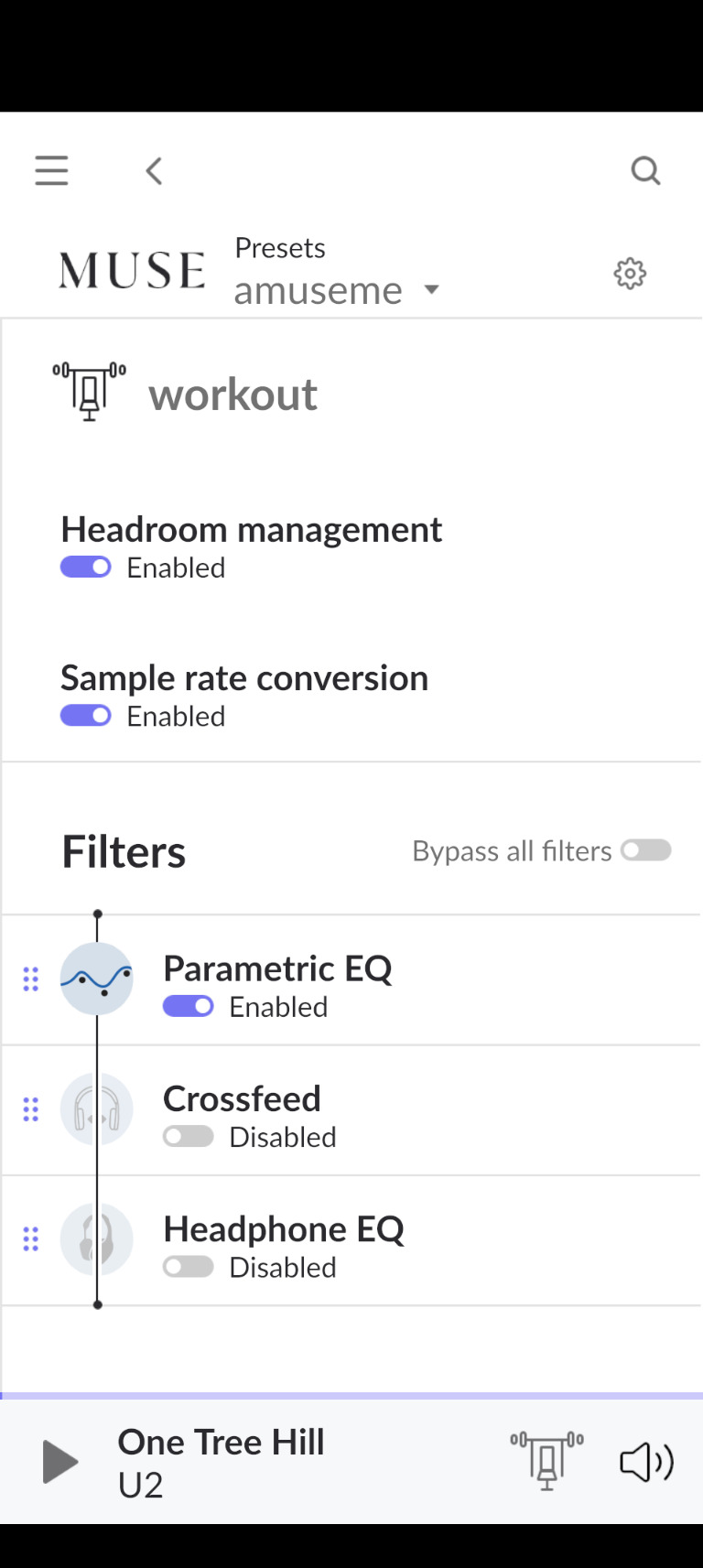

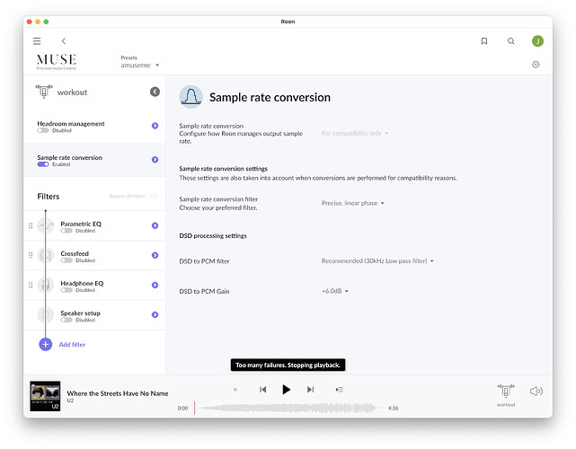

Hi,
I “set up” MUSE for this zone but since I’ve never used MUSE before on any zone it’s a fair bet I don’t know what I’m doing.
Having set it up as per the attached screen shots I still can’t play audio to this zone. What else could I try?
Also, here is the RAATServer.log.txt from today. Note the plethora of error messages “Warn: [RAAT::vc4-hdmi] [lua@0x7f7c0a14e8] [192.168.0.19:58867] setup failed: RAAT__OUTPUT_PLUGIN_STATUS_FORMAT_NOT_SUPPORTED”

03/21 12:37:24 Trace: [RAAT::vc4-hdmi] alsa output setup: format is pcm 44100/16/2
03/21 12:37:24 Trace: [RAAT::vc4-hdmi] opening [hw:CARD=vc4hdmi,DEV=0] 44100/16/2
03/21 12:37:24 Warn: [RAAT::vc4-hdmi] [lua@0x7f7c0a14e8] [192.168.0.19:58867]  setup failed: RAAT__OUTPUT_PLUGIN_STATUS_FORMAT_NOT_SUPPORTED
03/21 12:37:24 Trace: [RAAT::vc4-hdmi] [lua@0x7f7c0a14e8] [192.168.0.19:58867]  SENT [6] {"message":"RAAT__OUTPUT_PLUGIN_STATUS_FORMAT_NOT_SUPPORTED","status":"UnexpectedError"}
03/21 12:37:25 Trace: [RAAT::vc4-hdmi] [lua@0x7f7c0a14e8] [192.168.0.19:58867]  GOT [7] {"request":"setup","format":{"sample_type":"pcm","sample_rate":44100,"bits_per_sample":16,"channels":2,"sample_subtype":"none"}}
03/21 12:37:25 Trace: [RAAT::vc4-hdmi] alsa output setup: format is pcm 44100/16/2
03/21 12:37:25 Trace: [RAAT::vc4-hdmi] opening [hw:CARD=vc4hdmi,DEV=0] 44100/16/2
03/21 12:37:25 Warn: [RAAT::vc4-hdmi] [lua@0x7f7c0a14e8] [192.168.0.19:58867]  setup failed: RAAT__OUTPUT_PLUGIN_STATUS_FORMAT_NOT_SUPPORTED
03/21 12:37:25 Trace: [RAAT::vc4-hdmi] [lua@0x7f7c0a14e8] [192.168.0.19:58867]  SENT [7] {"message":"RAAT__OUTPUT_PLUGIN_STATUS_FORMAT_NOT_SUPPORTED","status":"UnexpectedError"}
03/21 12:37:25 Trace: [RAAT::vc4-hdmi] [lua@0x7f7c0a14e8] [192.168.0.19:58867]  GOT [8] {"request":"setup","format":{"sample_type":"pcm","sample_rate":44100,"bits_per_sample":16,"channels":2,"sample_subtype":"none"}}
03/21 12:37:25 Trace: [RAAT::vc4-hdmi] [lua@0x7f7c0a14e8] [192.168.0.19:58867]  SENT [8] {"message":"RAAT__OUTPUT_PLUGIN_STATUS_FORMAT_NOT_SUPPORTED","status":"UnexpectedError"}
03/21 12:37:25 Trace: [RAAT::vc4-hdmi] [lua@0x7f7c0a14e8] [192.168.0.19:58867]  GOT [9] {"request":"setup","format":{"sample_type":"pcm","sample_rate":44100,"bits_per_sample":16,"channels":2,"sample_subtype":"none"}}

How could I get RAATServer to write audio to the HMDI device same as these other programs?
Thanks
James
The Android app doesn’t show the MUSE settings so here’s a screen shot from a mac. Note the same error stopping playback due to too many failures. RAATServer.log.txt shows the same RAAT__OUTPUT_PLUGIN_STATUS_FORMAT_NOT_SUPPORTED error messages repeating.
Note that “sample rate conversion” field is greyed out. Maybe the vc4-hdmi ALSA device is incompatible with this or something? Anyway I can’t upsample or downsample any audio, I think, because it’s greyed out. The other settings don’t make any difference to whether or not audio plays.
Hey @James_Ockers ,
Have you tried setting the default audio output on the RPi to HDMI? Might be worth a shot:
https://forums.raspberrypi.com/viewtopic.php?t=322634
Hi,
Yes of course I did that. vc4-hdmi is the only audio output, because I disabled snd_bcm2835 in the config.txt.
Did you see above the output from aplay -l showing only vc4-hdmi audio out? Here it is again:
pi@rpi-garage:/boot/firmware $ aplay -l
**** List of PLAYBACK Hardware Devices ****
card 0: vc4hdmi [vc4-hdmi], device 0: MAI PCM i2s-hifi-0 [MAI PCM i2s-hifi-0]
  Subdevices: 1/1
  Subdevice #0: subdevice #0
Screen shot from raspi-config:
I plugged in an el cheapo USB DAC and Roon and RAATServer work right away. I still would prefer to have RAATServer write the audio to the vc4-hdmi so please look into how we could get that to work.
Here’s how it looks with the USB DAC plugged in:
pi@rpi-garage:~ $ aplay -l
  Subdevices: 1/1
card 1: DAC [USB AUDIO    DAC], device 0: USB Audio [USB Audio]
  Subdevices: 0/1
Screen shot, when I click Enable, all the Roon things work on as expected.
Therefore I still think the RAAT__OUTPUT_PLUGIN_STATUS_FORMAT_NOT_SUPPORTED is a compatibility issue somewhere in RAATServer, ALSA, and/or vc4-hdmi hardware (?), so please let me know what else I could try to get that to work.
Thanks
James
