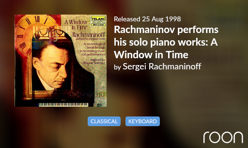

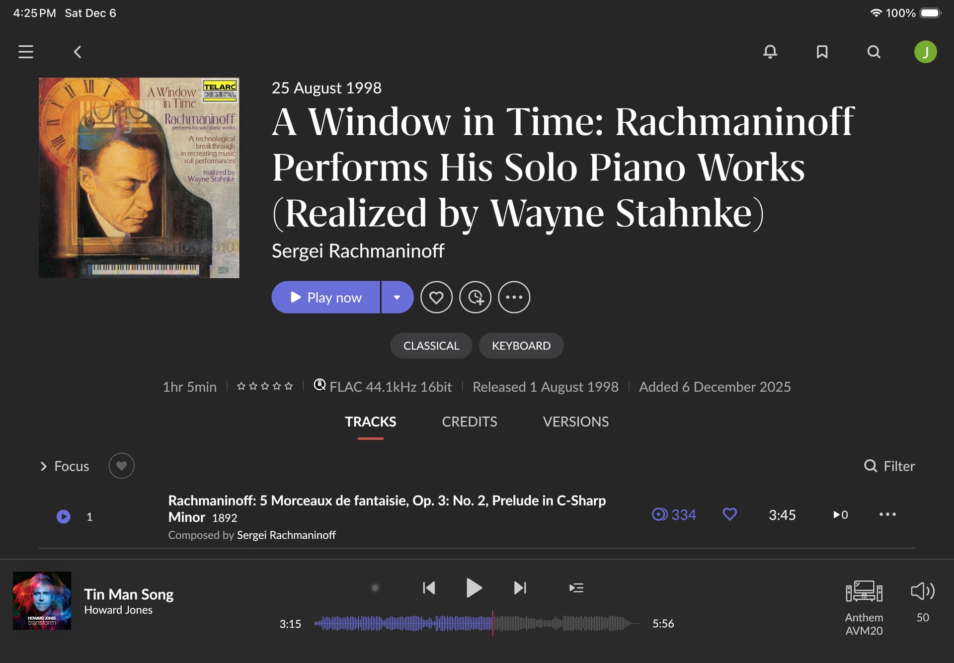

Rachmaninoff album does not appear under Rachmaninoff
Does anyone else here have this album?
Despite all the metadata appearing correctly, this album will not appear under Rachmaninoff as Composer or Artist. This is true for my local copy or the Qobuz version.
This album has multiple composers in the credits, including Rachmaninoff. This album appears under every one of them except Rachmaninoff.
Roon has no trouble correctly identifying this album, so I don’t understand why it will not appear under Rachmaninoff.
Any clues on what’s going on or how to fix this (if possible)?
Could it be because, as shown in the illustration, it is categorized under RachmaninoV?
Thanks for pointing that out. I wondered about that before, but I believe Roon understands both spellings are the same person.
Here is the Qobuz version where the spelling matches. I added it to my library, but it still doesn’t show under Rachmaninoff, just like my local copy doesn’t show.

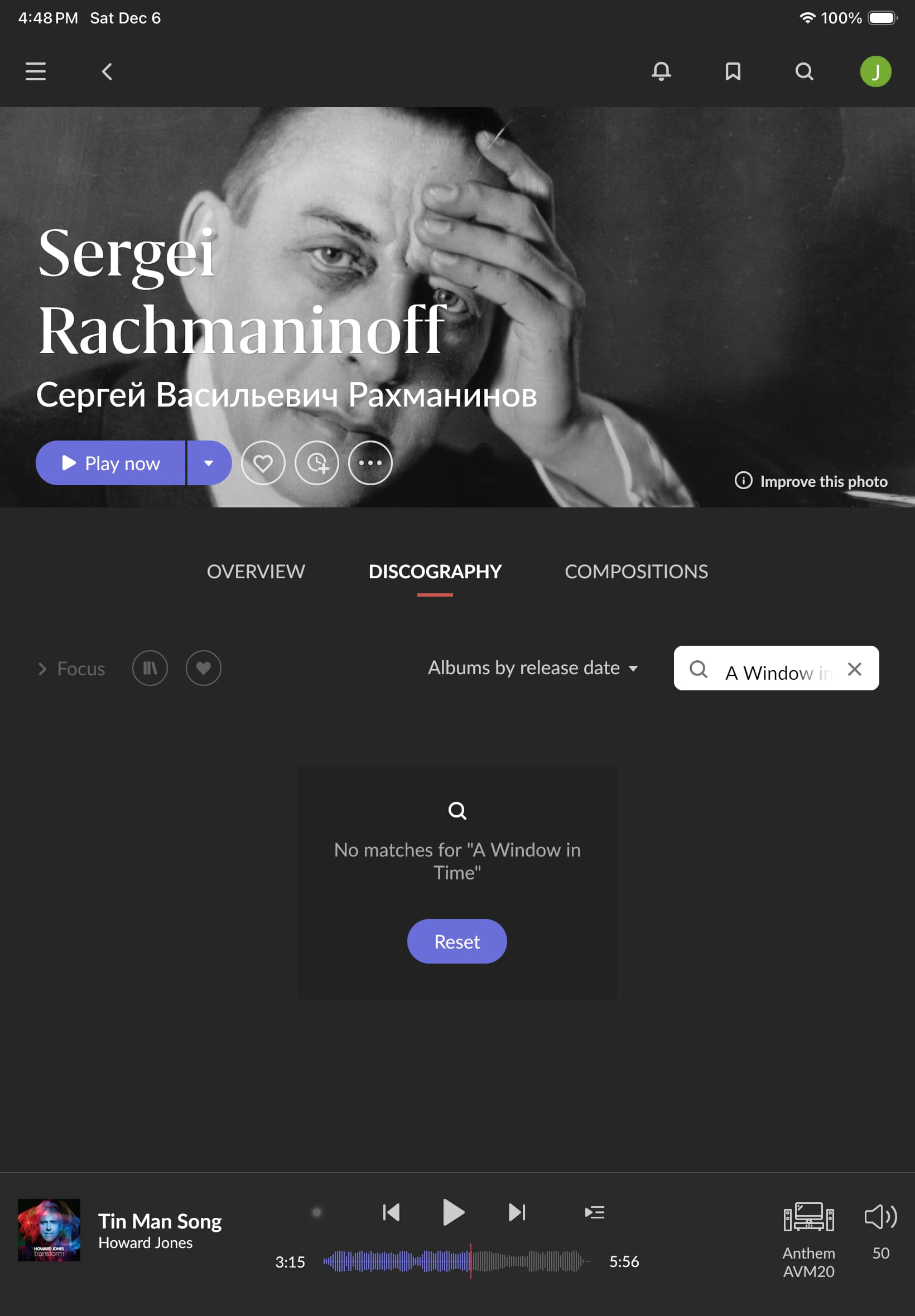

It’s also odd if I filter for “A Window In Time” in all the albums by Rachmaninoff, both local and Qobuz, including Qobuz albums not in my library, nothing comes up.

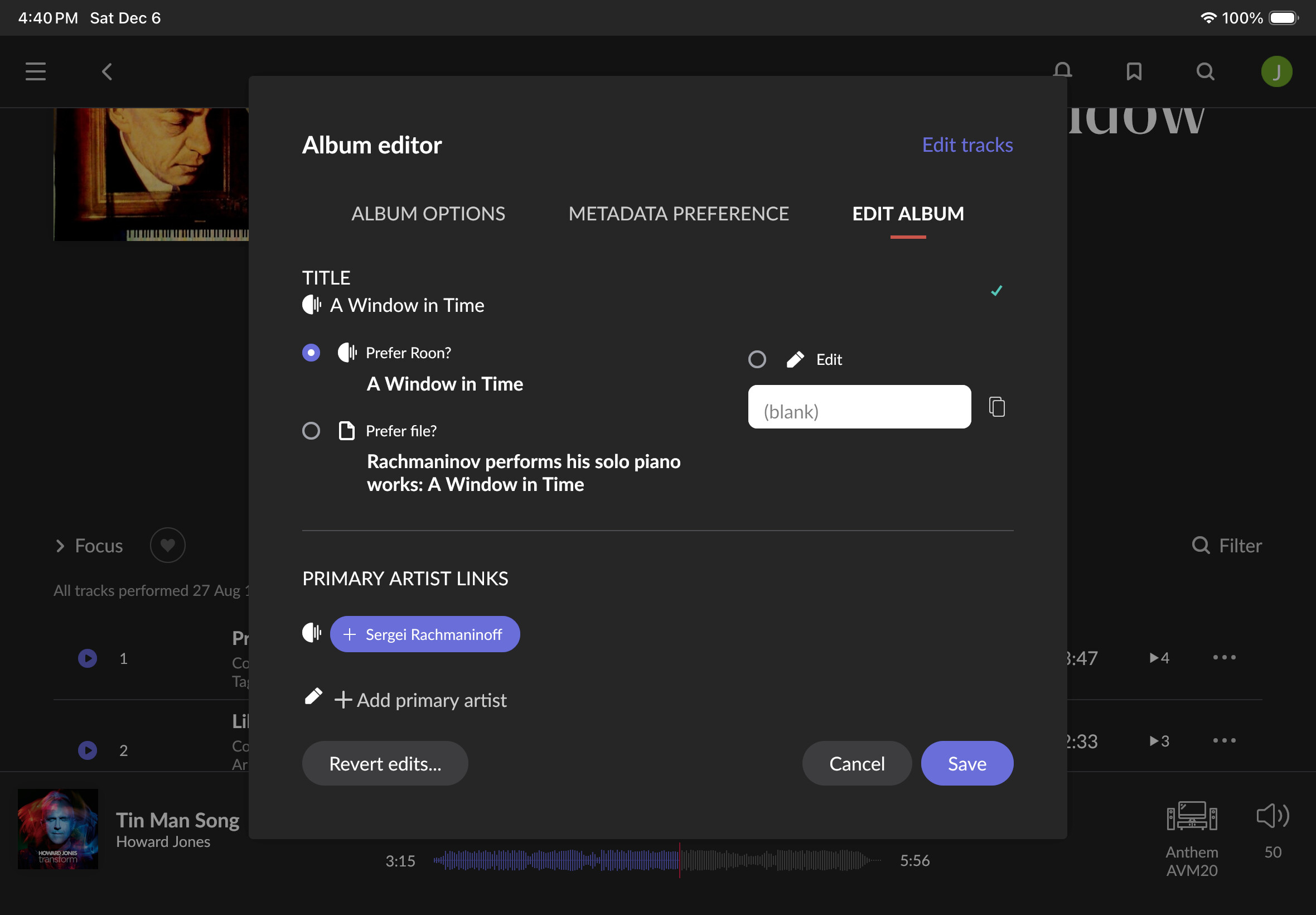

I also went through the option in Edit Album and selected Prefer Roon for everything, but that didn’t help.

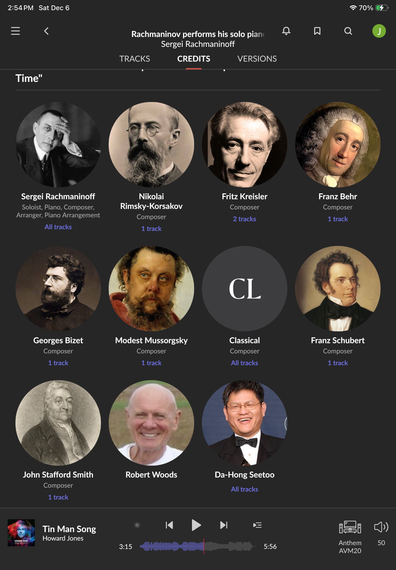

Had a similar problem with several classical composers who are long dead but appear both as a composer and a performer (Richard Strauss, Benjamin Britten and others). If I recall it correctly, removing ´Rachmaninov´ from all other roles than composer and primary artist, solved the issue. Reason being that roon files albums on the artist´s and composer´s page either under ´composed by´, ´main albums´ or ´appearances´, not several at the same time. So if one is both a composer and ´Soloist´, ´Piano´ in your case, the album does not appear as classical composers before the age of mass recordings seemingly do not have an ´appearances´ section.
Make sure you edit the credits correctly both for all tracks of the album containing any Rachmaninov credit other than ´composer´ and for the album itself.

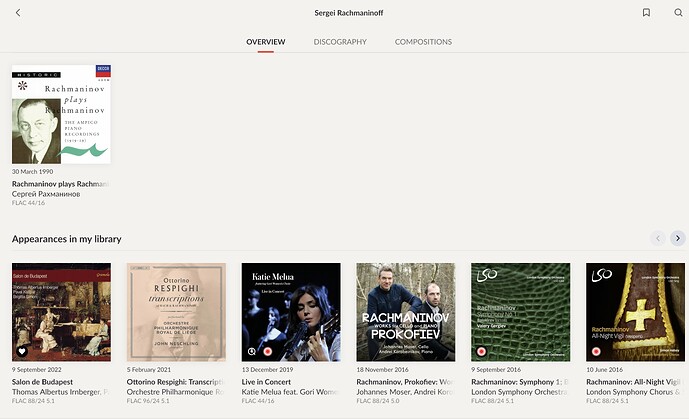

PS: Found the ´Rachmaninov plays Rachmaninov´ album on my HD, but I cannot replicate what I did to make it show up on Rachmaninov´s composer page.
I can deny Sergey Vasilyevich the status of a classical composer by editing the profile, so the album appears under ´Albums in my library´ and ´Main albums´. That’s not a solution, though
As the album is correctly shown in the global library album overview, focus-filtered to the performer being Rachmaninov, I can kind of live with the result. Not ideal, though, if you are a fan of original performances by the composer.

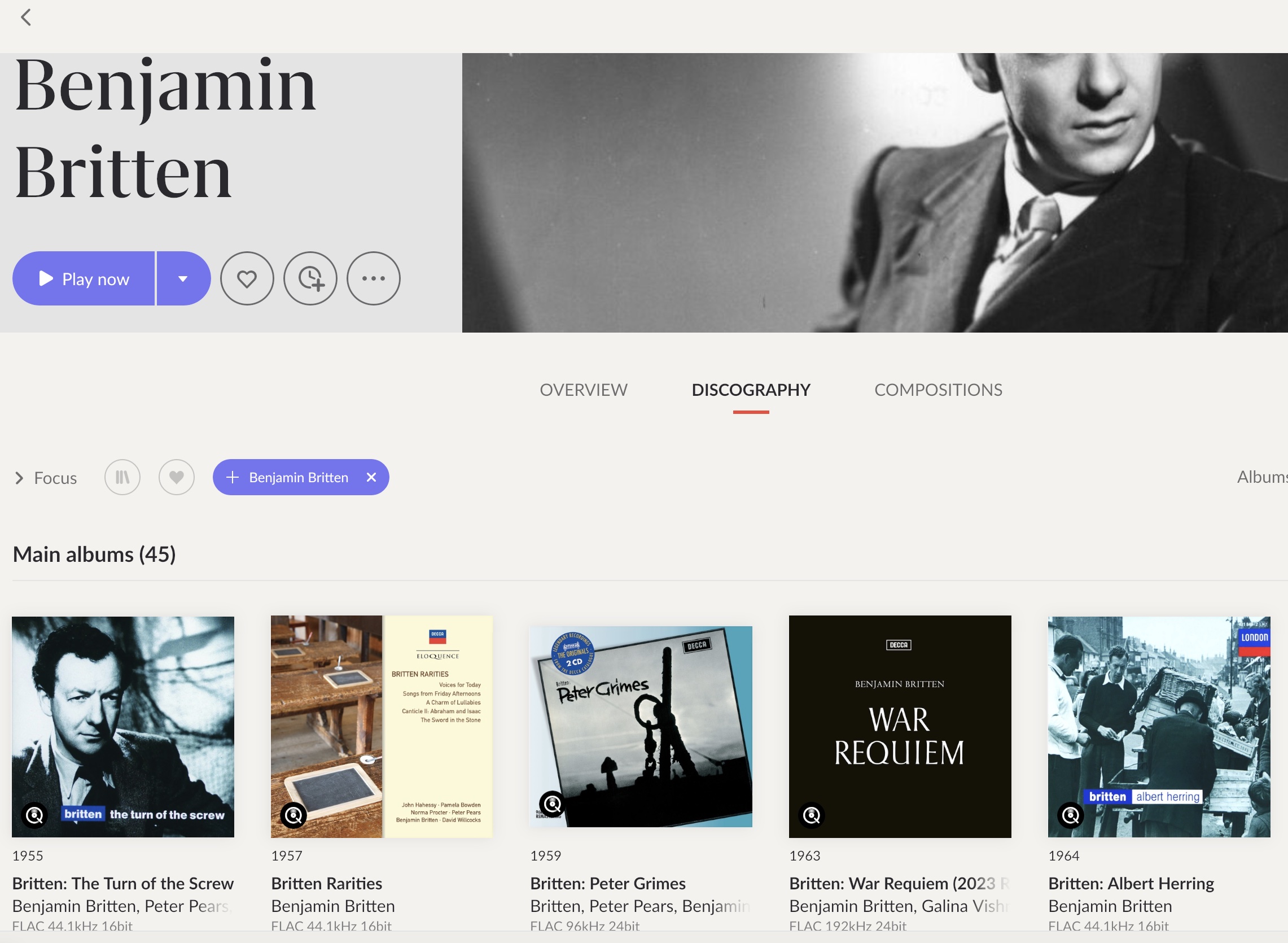

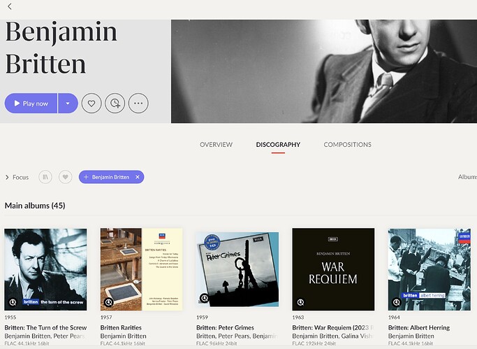

Interestingly, some classical composers are treated as both composer and performer, being granted a role as ´Conductor´ for example and their own ´Main albums´ section in the discography:
So no problem with Benjamin Britten, Aaron Copland and Igor Stravinsky. Weirdest yet most prominent examples, whom I would expect to appear as a conductor or performer as well as as composer, are Richard Strauss, Sergey Rachmaninov, Sergey Prokofiev and Dmitri Shostakovich.

It’s apparent Roon “understands” Rachmaninoff is a composer on the album in question, but for some unknown reason it refuses to display it on Rachmaninoff’s composer or artists page.

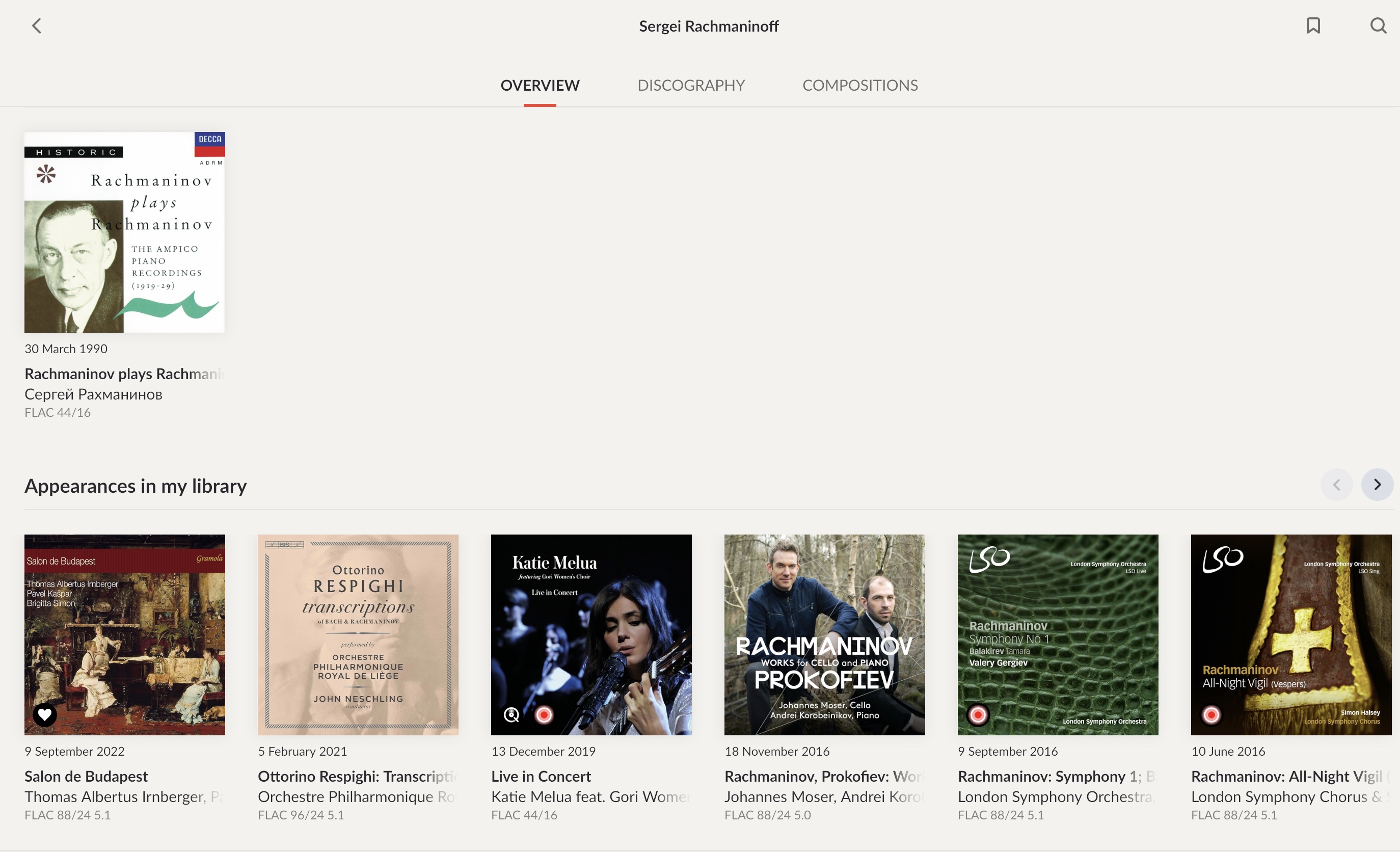

The moment a person is primary artist or performer, the album in question would not show up under ´composed by´. Problem here is that Rachmaninov is not granted a ´main albums´ or ´appearances´ section, so the album is invisible on the composer´s page.

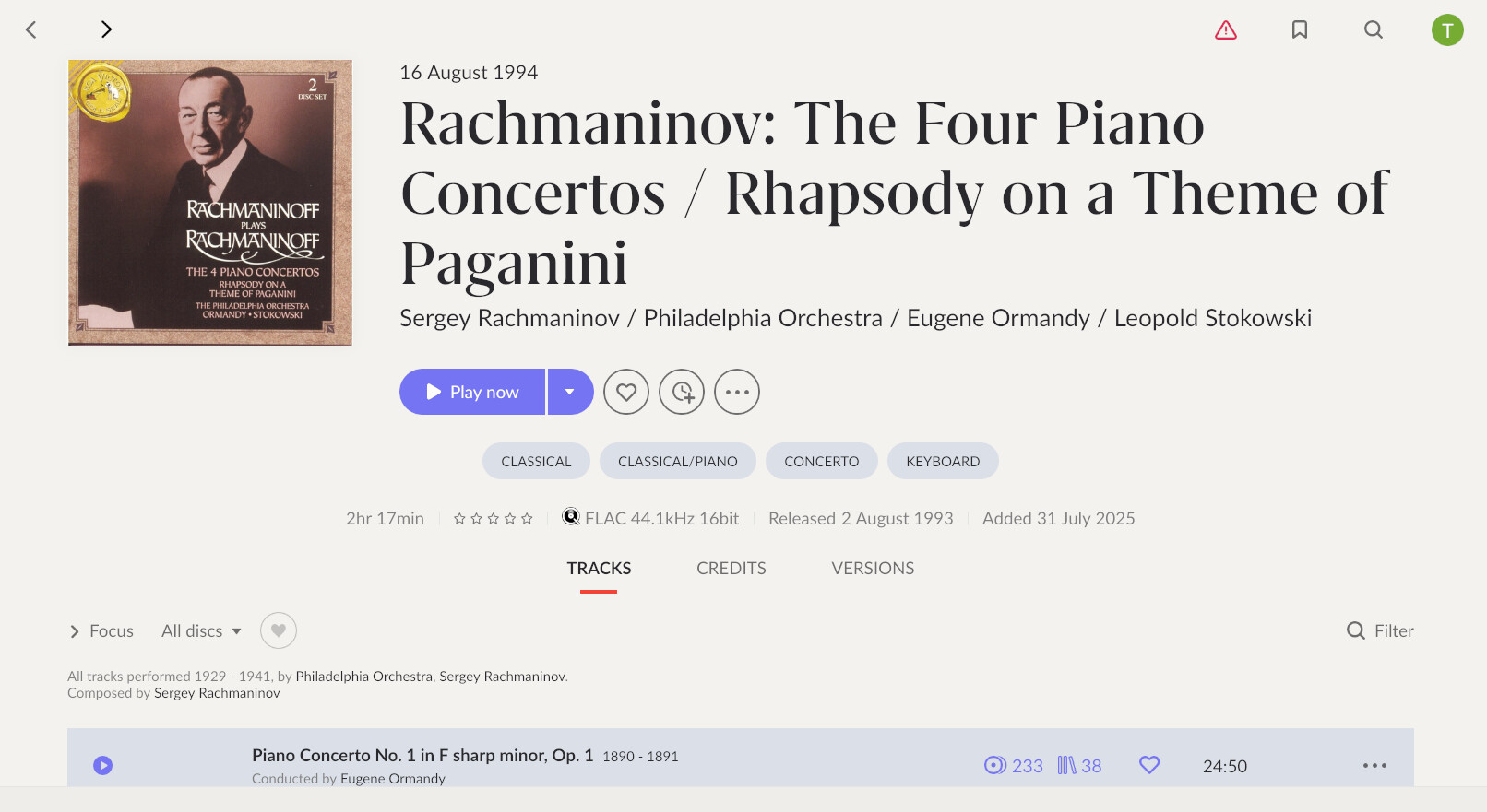

I have that album and it doesn’t appear in the Rachmaninov section for me either. Also the four famous recordings of his piano concertos do not appear.

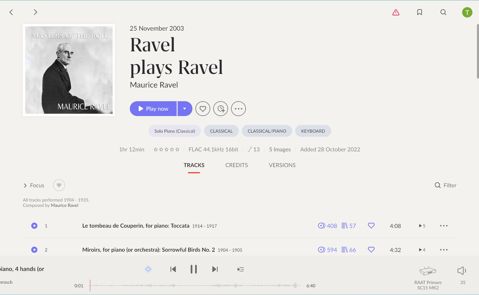

It seems to be a general problem for dead pianist composers who lived into the early recording era. For example, Qobuz has many piano roll albums of long dead pianist composers, including Ravel, none of which appear in artist or composer sections:

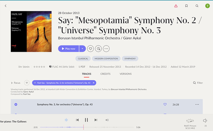

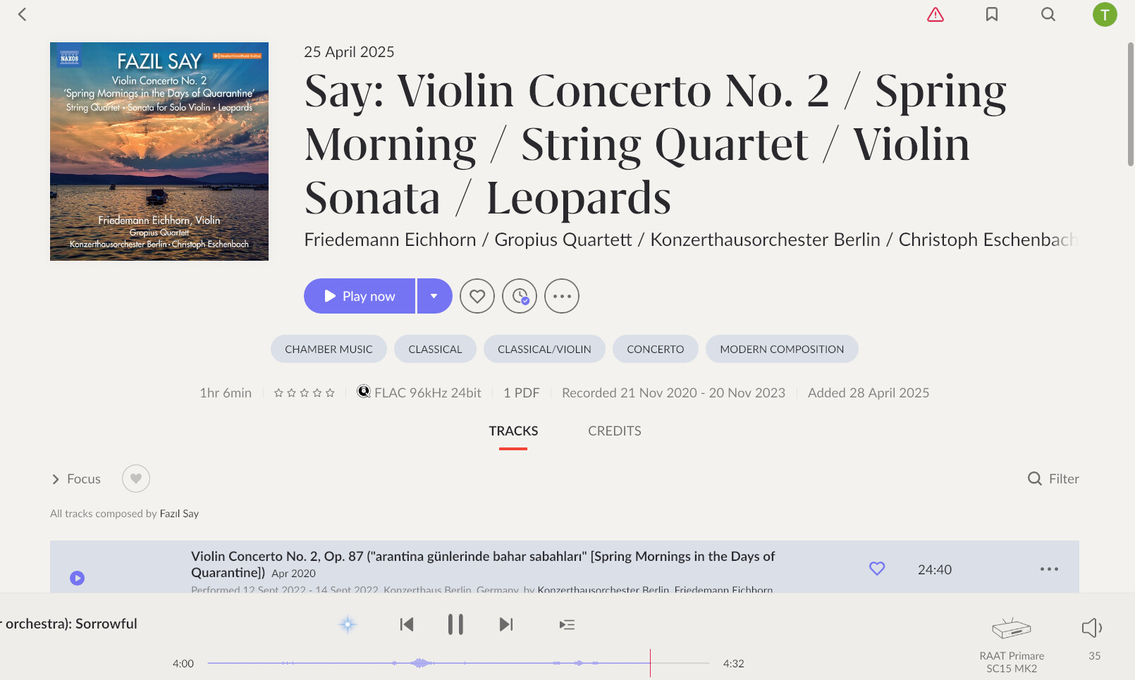

Also more contemporary examples of living pianist composers like Fazil Say are quite hit and miss. This album of Say compositions where Say does not have a piano performer credit does not appear:
But this album of Say compositions where Say does have a piano performer credit, does appear:

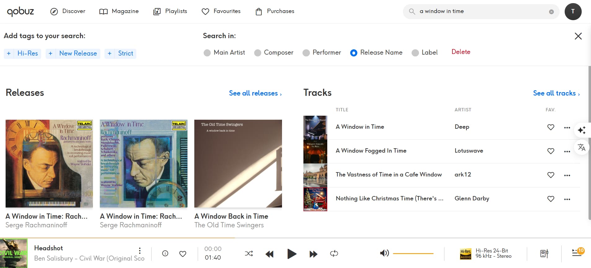

Do you have any suggestions in how to navigate the Qobuz app to find such recordings? I tried using the search feature for Rachmaninoff, but it just shows me every album where Rachmaninoff is the composer as well (too many to search through!) but not the artist.
These days I use Google in AI mode to find the exact title of the album I am interested in. It’s often quicker and easier than allmusic.com. Then in Qobuz I make sure I have set the “release name” button. Most of the time that is enough. You can see there was actually a companion album of Rachmaninov playing other composers works:
If Qobuz returns a data set too large to browse, I just right click and do a browser search on the page (chrome). Seamless integration of AI is the way forward I think to significantly improve search, library management etc. but I have the impression that roon has other priorities.

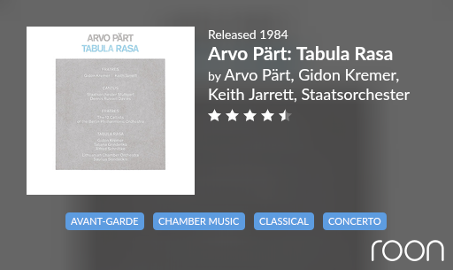

PS - I came across another example with the same issue. :frowning:
I can find this using the Focus feature (select Composers) in My Albums, but it’s not listed on Arvo Parts’ composer page.

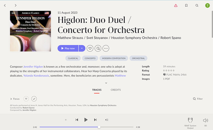

If you play a lot of contemporary Classical music it is not difficult to find examples but I don’t know what the pattern is. Very hit and miss. This one from Jennifer Higdon doesn’t list:

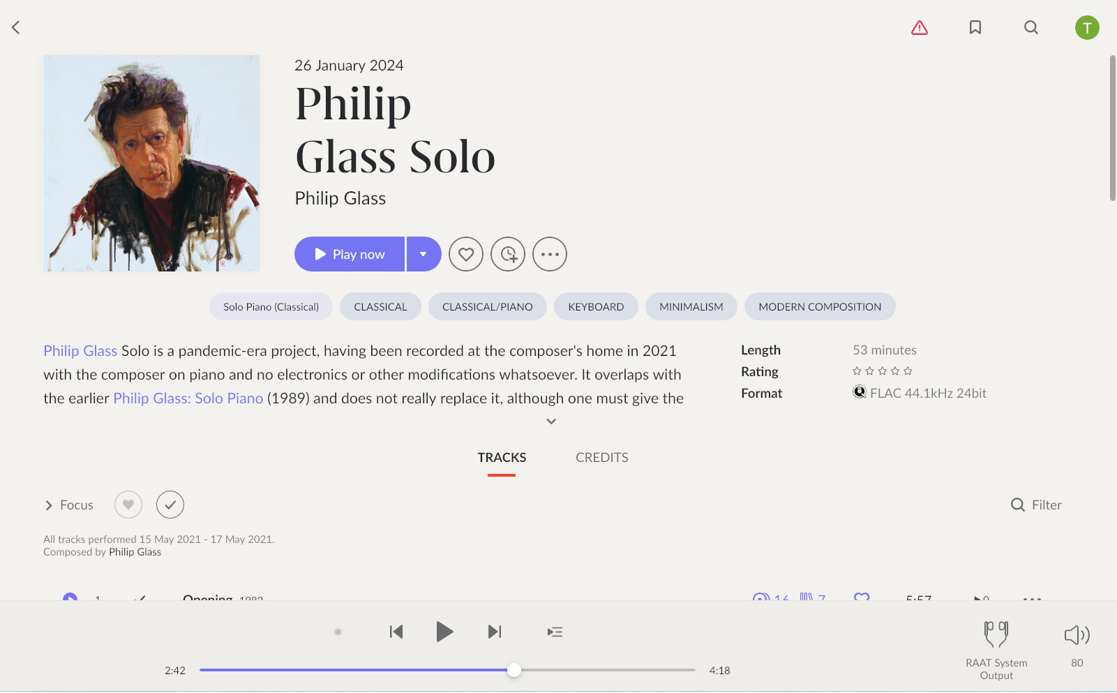

But this one from Philip Glass does:
