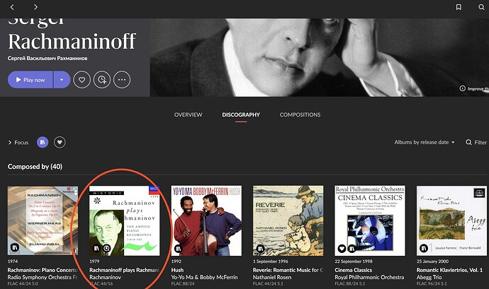

Rachmaninoff album does not appear under Rachmaninoff
Yes, a perfect description of this issue. :+1:
The logic of the discography on an artist’s page is such that an album would not appear twice. If it is listed under ´main albums´ or ´appearances´, it will not appear a second time under ´composed by´.
My understanding is that the composer-performers in question are correctly recognized as performers or main artists, with the album rightfully not listed under ´composed by´. The main problem seemingly is that ´main albums´ or ´appearances´ sections are missing. Can only make a wild guess, why is that so: maybe to prevent albums which should be filed under ´composed by´ coming in with flawed metadata, i.e. the composer wrongly tagged as main artist, for composers who are not known to having ever released albums as a performer (because it is not known, or they died before albums have ever been released).
I suggest we create a list of affected composer-performers, and inform roon team that these should be handled as contemporary composer-performers with main albums being shown. This should solve the issue IMHO.

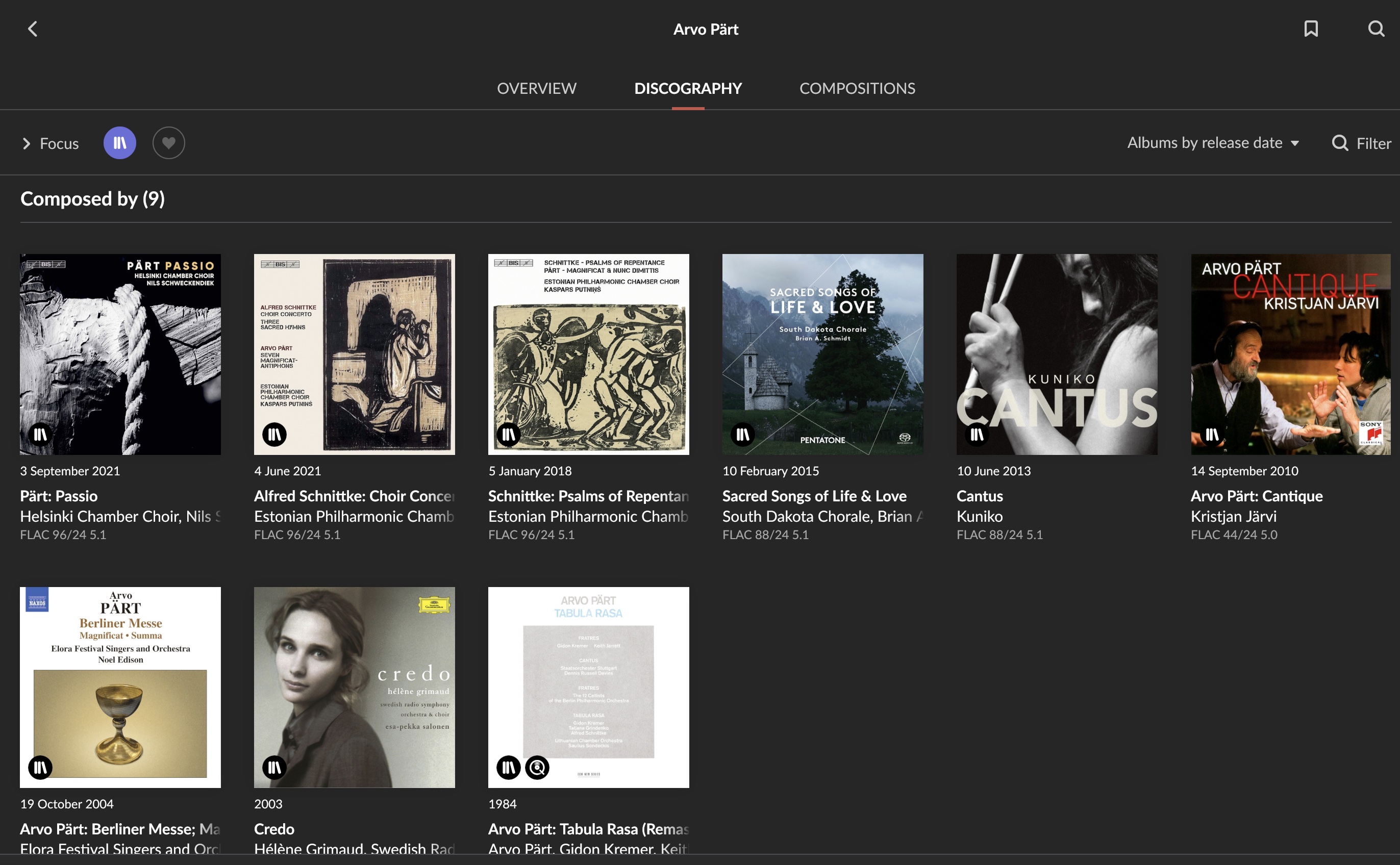

Zero problems with Arvo Pärt and this album despite from him being (wrongfully) tagged as a main artist:
´Hit and miss´ in the sense that a composer is either always granted performer sections, or never? That’s what I have observed, and there should be a clear fix on roon´s template side. Or that the situation can be unpredictable with different albums of one and the same composer? Have never witnessed that tbh.
Thanks. I appreciate your input on what may be going on here.
Regarding the Arvo Part album I mentioned, I noticed your version is from Qobuz. Mine is a rip from a CD in my disc collection.
I added the Qobuz version to my library, and like yours, it displays properly under Arvo Part. Perhaps there’s a difference in the metadata on my CD rip that’s causing the issue. I’ll compare the two and see if I need to make corrections to my CD rip.:+1:

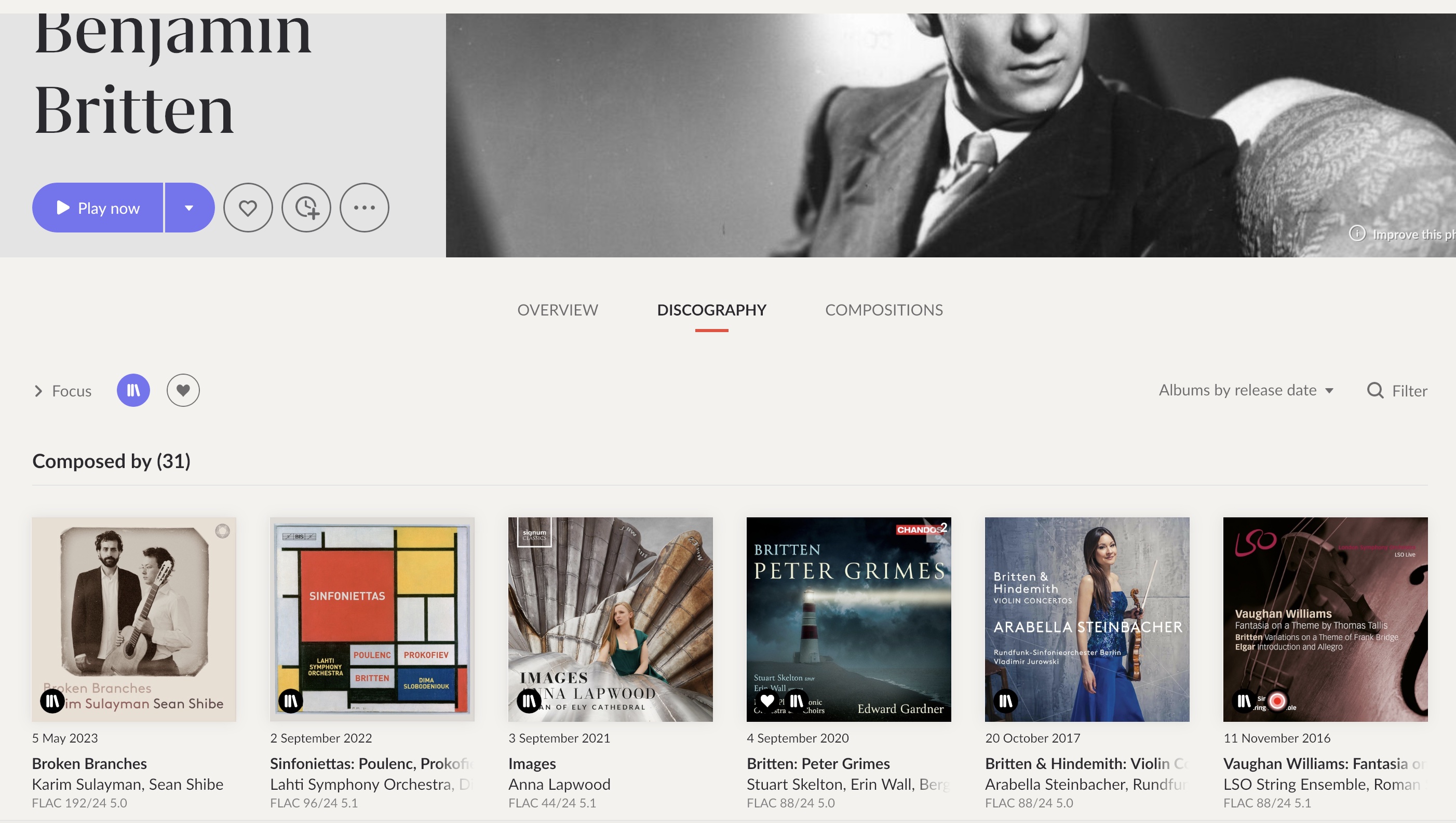

Had similar cases with other composers, like Benjamin Britten who was credited as ´Liner Notes´ which prevented him from being recognized as the composer.

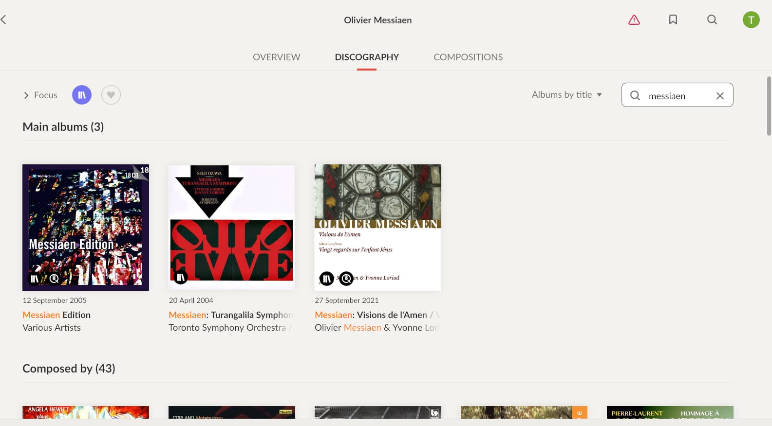

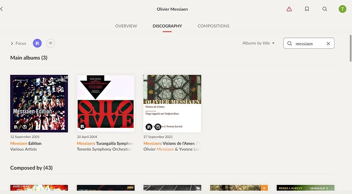

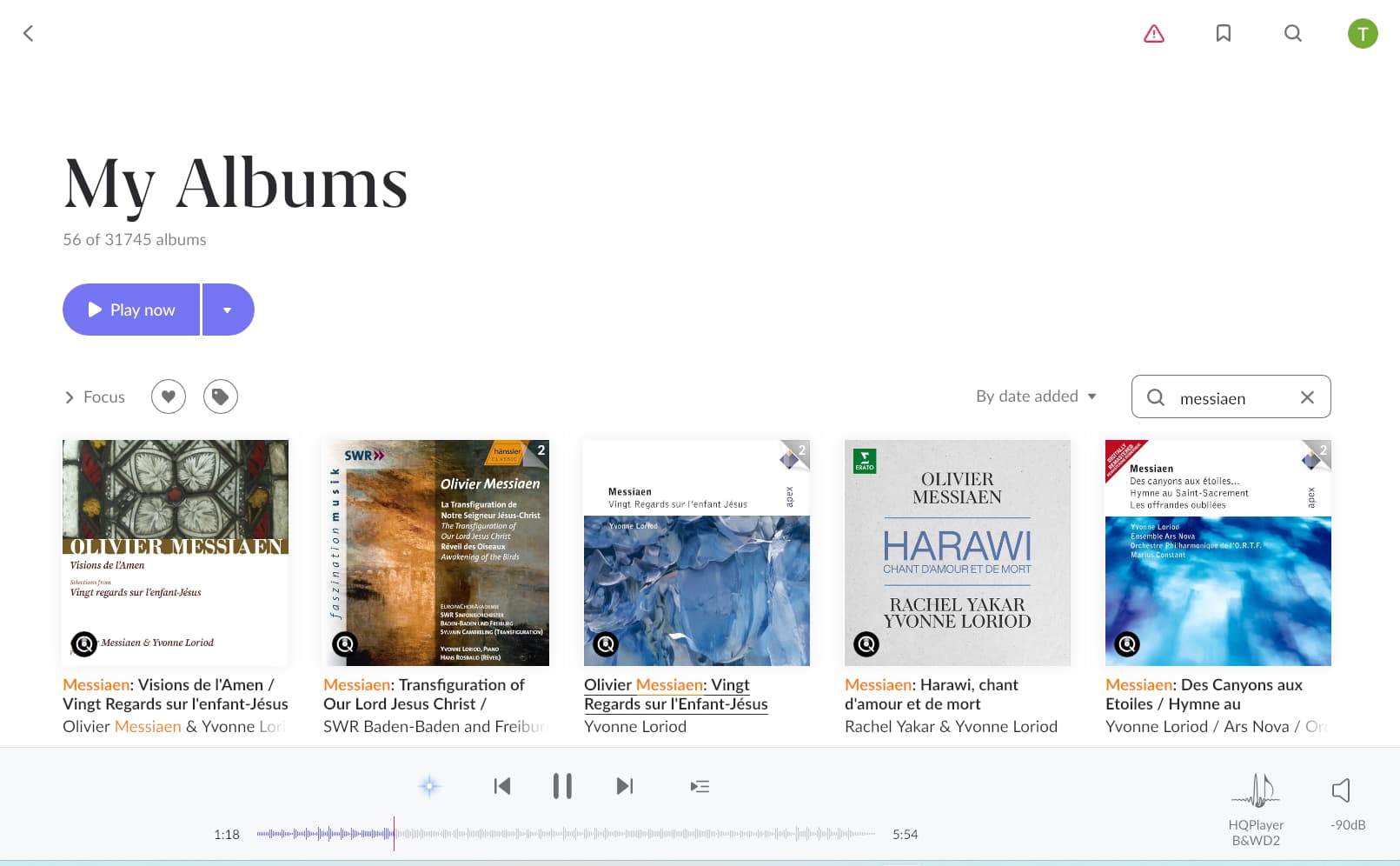

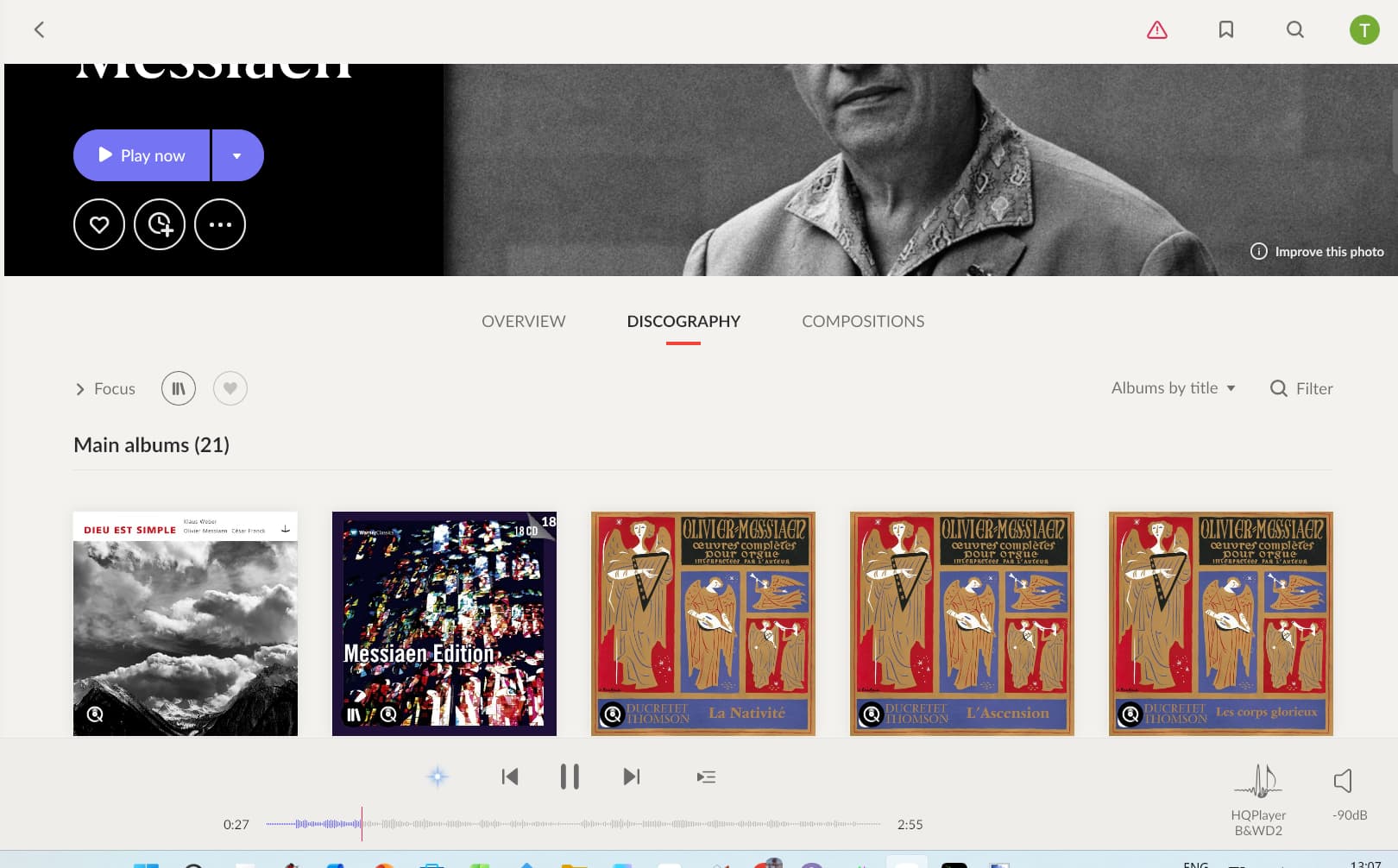

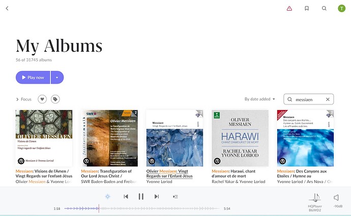

I don’t find it difficult to find contrary examples with contemporary Classical music, some quite striking. For example, I have at least 56 Olivier Messiaen albums according to a string search in the main albums screen. This is a combination of local and Qobuz albums:
But in Messiaen’s discography only 21 albums are showing of which only 3 are library versions. This seems to be an example where only performer albums are being shown rather than composer albums of this major contemporary composer. There are no separate composer/performer sections. I don’t think this is a question of spurious tags like “liner notes” or other obvious things like setting the classical composer switch. I have done several rounds of tag clean-ups, although you never know as roon seems to be near constantly updating tags in background.

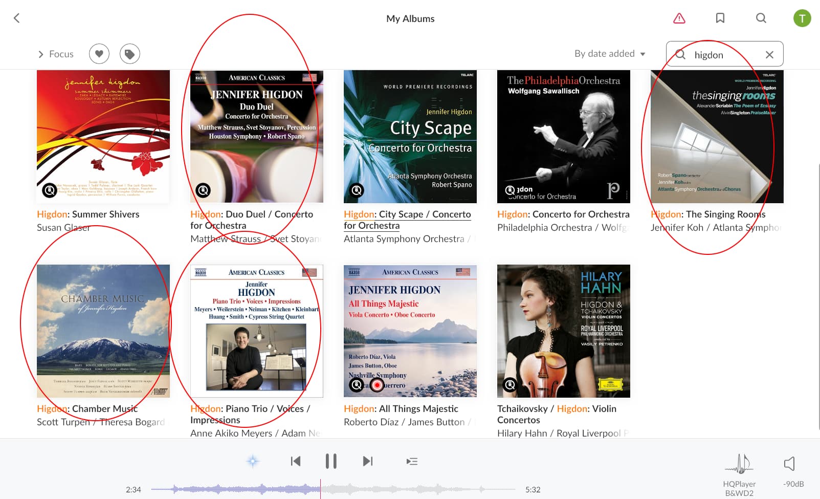

Have a wild guess why is that so: Jennifer Bigdon seemingly is credited for things like ´Liner Notes´ or ´Production´ on exactly all of the missing albums. For unknown reason, this might be bringing roon to not show them in ´Composed by´ section, or not show them at all, if the composer in general is not granted a ´Main albums´ or ´Appearances´ section - let us call it Morbus Rachmaninov ;-))

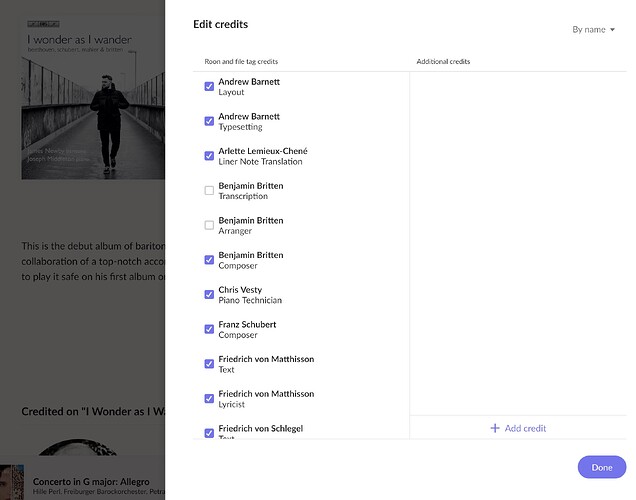

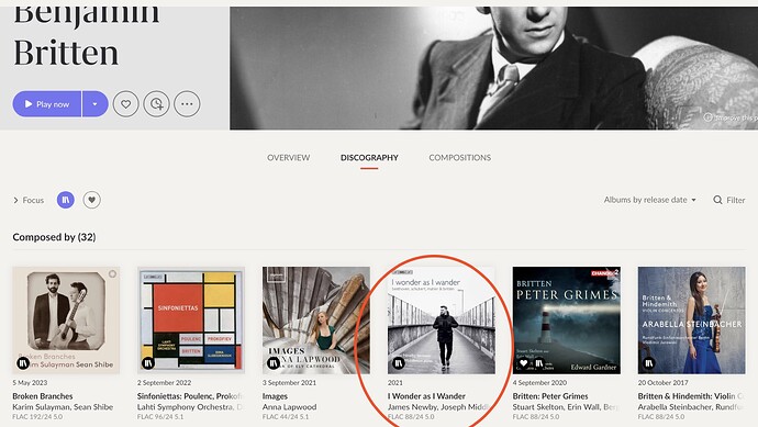

Try to remove the ´Liner Notes´ or ´Production´ credits from the album in roon, please. Had several albums with compositions by Benjamin Britten with the very same problem, and it helped.

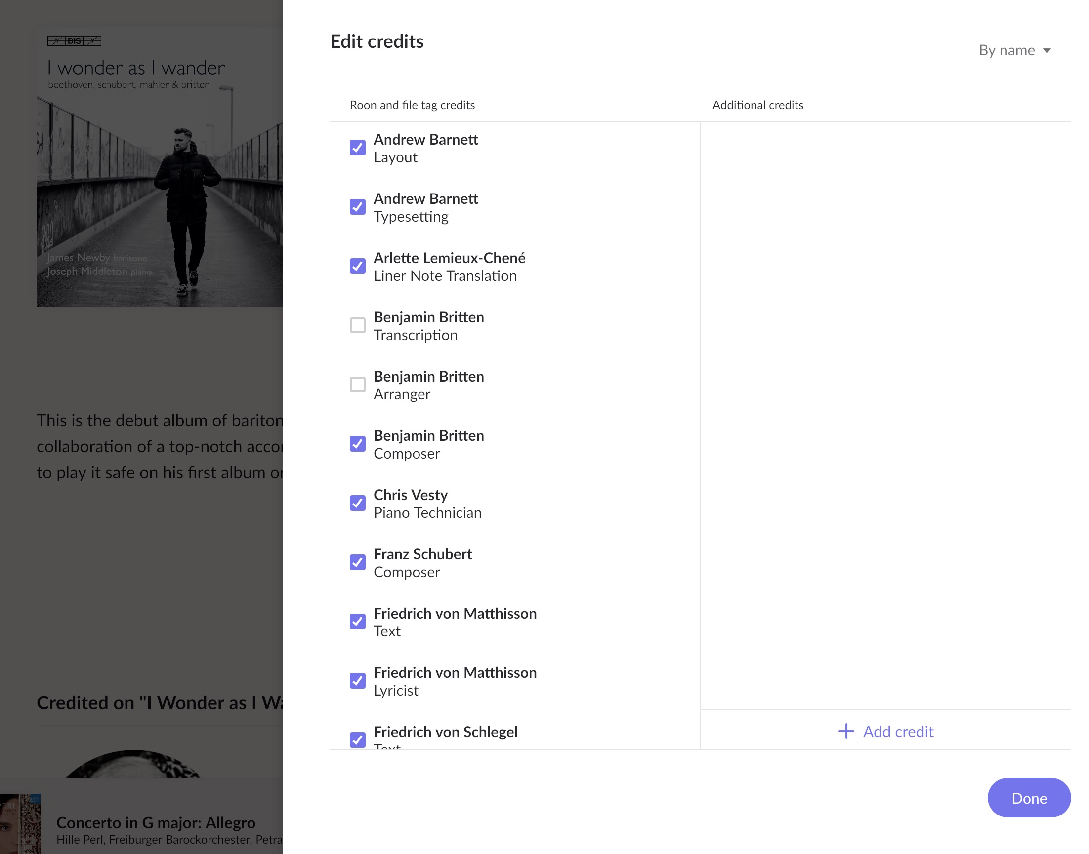

Where is James Newby´s recital album ´I wonder as I wander´ with Britten songs?

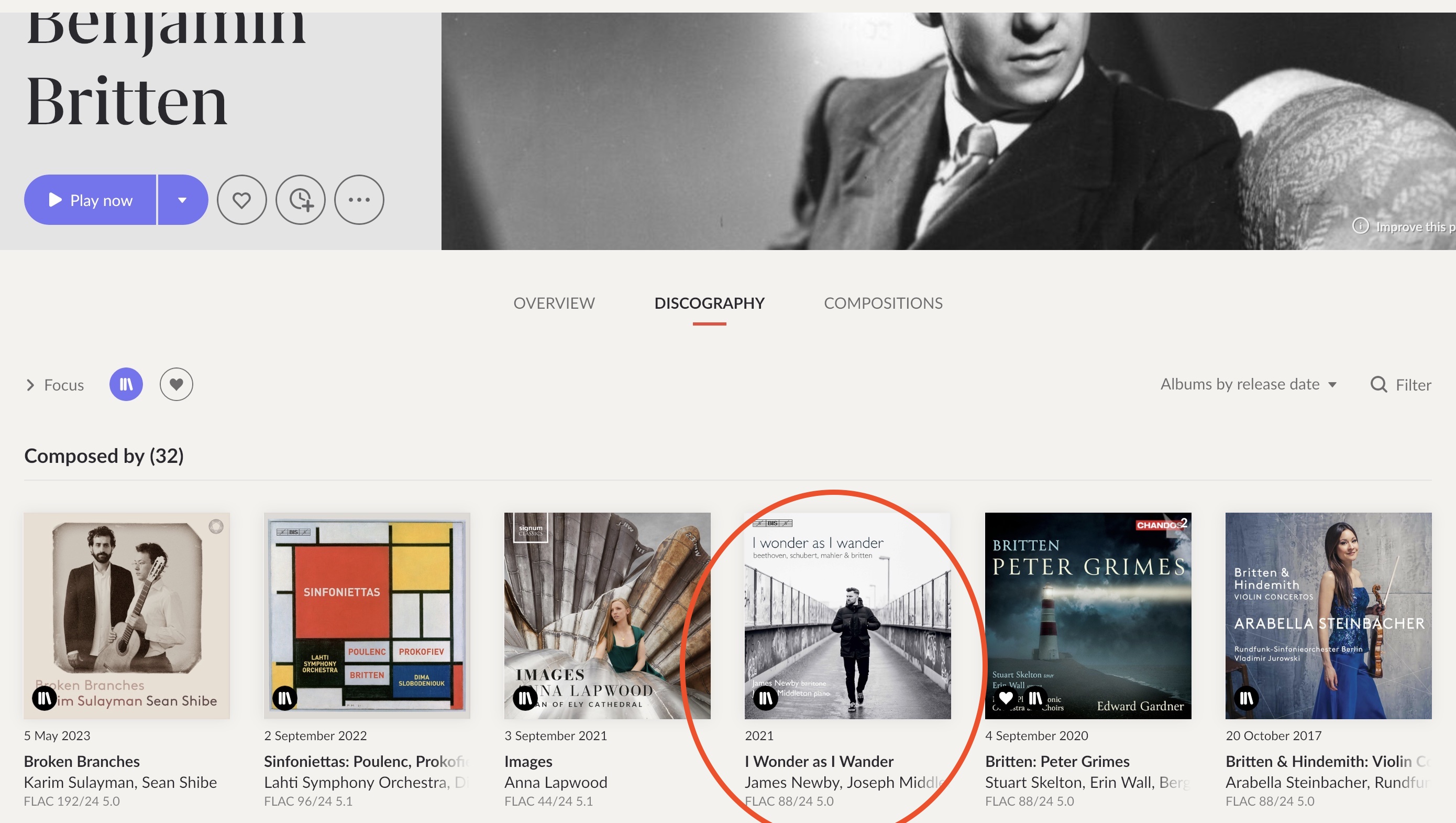

Ah, he is credited as arranger and for transcription as well, so we remove this from the whole album until he is a composer, and solely a composer:
Voilà, the album appears under ´Composed by´:
Really curious, if removing the ´Linear notes´ or ´Production´ credits will do the job in your case. Please report, if you find the time to try. Will dive into Messiaen later.

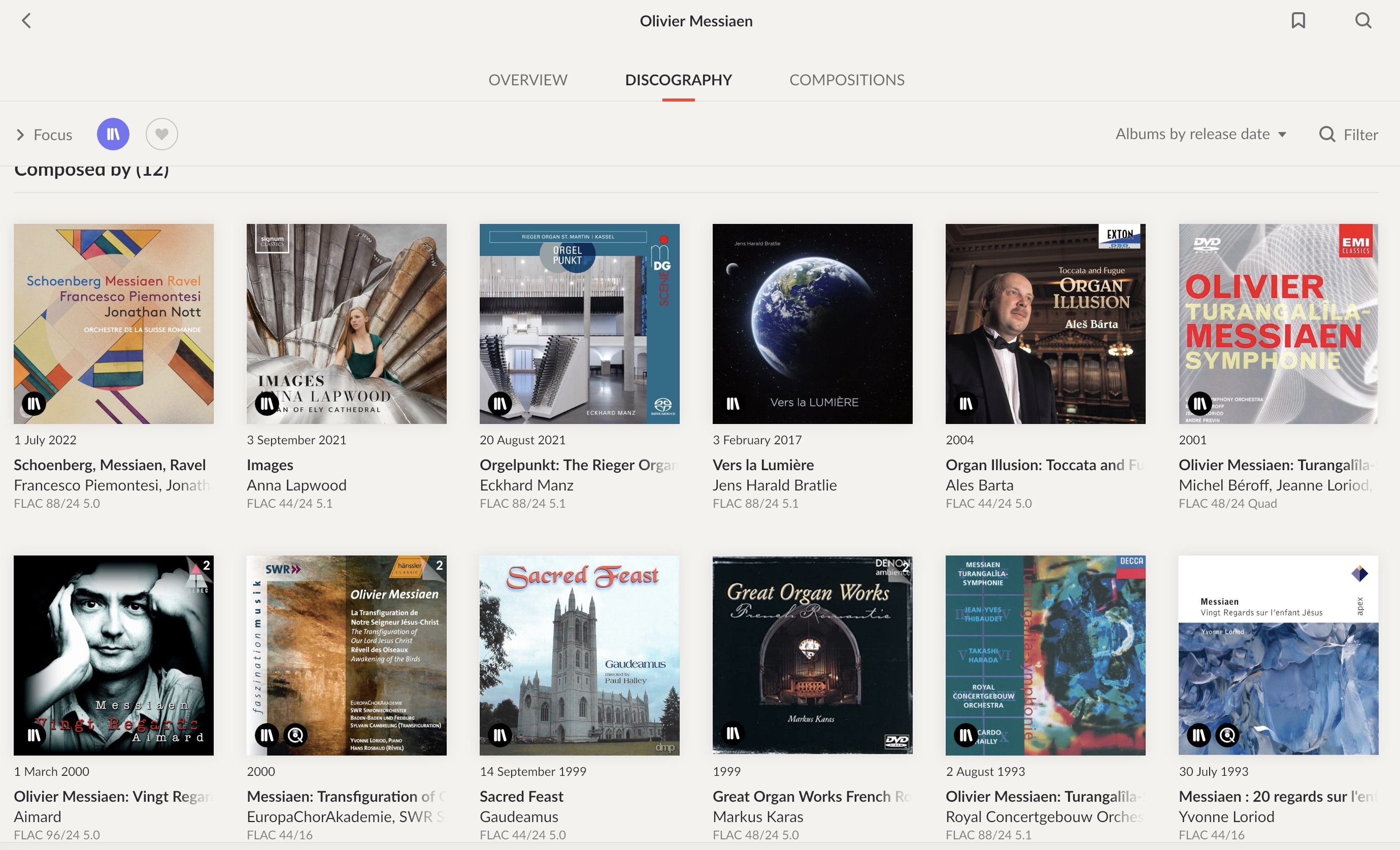

I have double checked Messiaen and there are separate sections (I didn’t scroll properly). So 3+43=46 albums are showing when I am expecting 56, so it’s not as bad as I thought but still, at least 10 are missing.

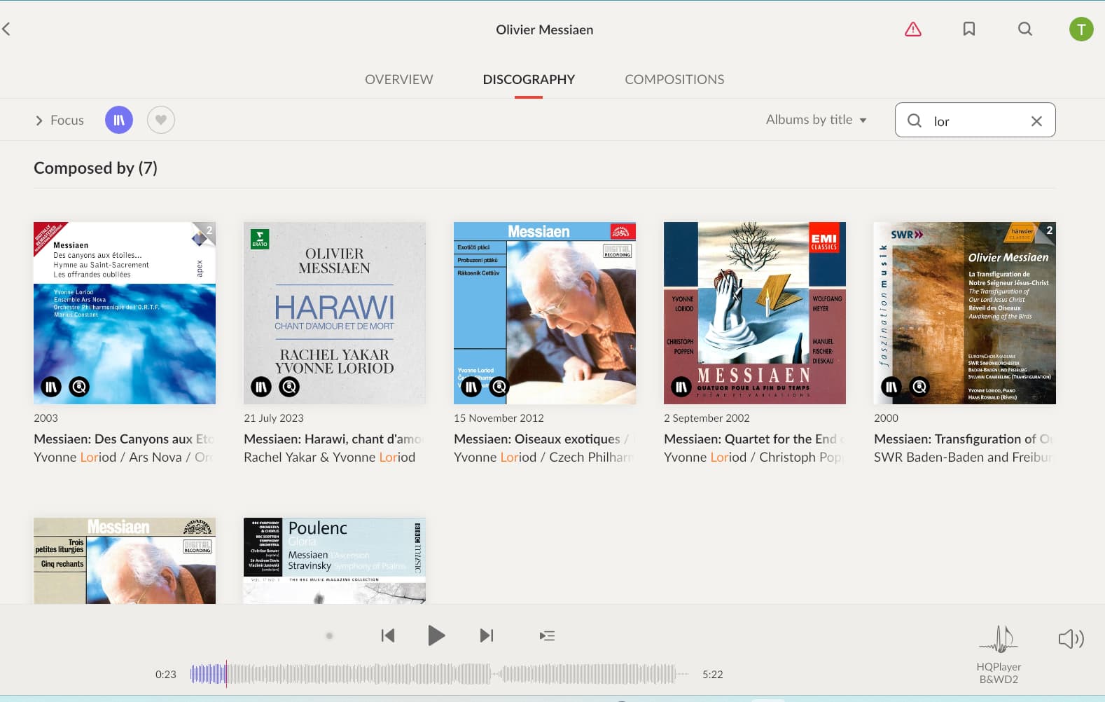

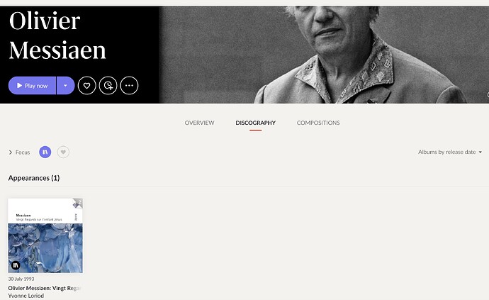

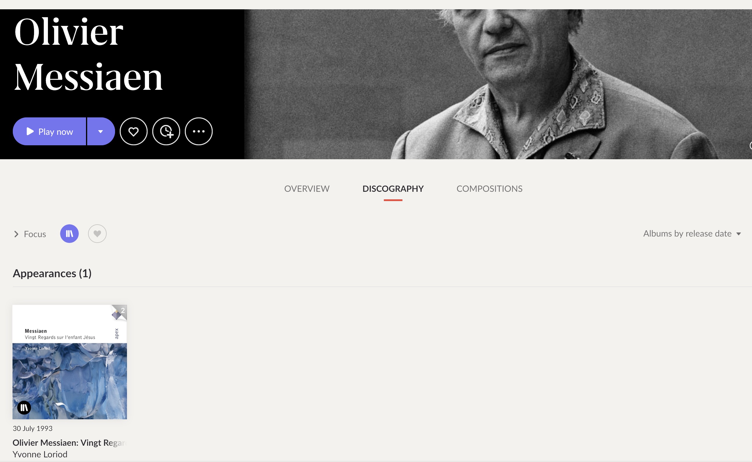

Tried to replicate your problem, and while all my local albums are listed (my Messiaen collection is not as big), one (“Vingt regards” by Yvonne Loriod) was hidden. Again removed credits such as ´Liner Notes´ for Messiaen, ét voilà:
My Loriod of “Des Canyons . . .” shows but by Loriod of “Vingt Regards . . .” (same Qobuz “apex” release as yours I think) does not:

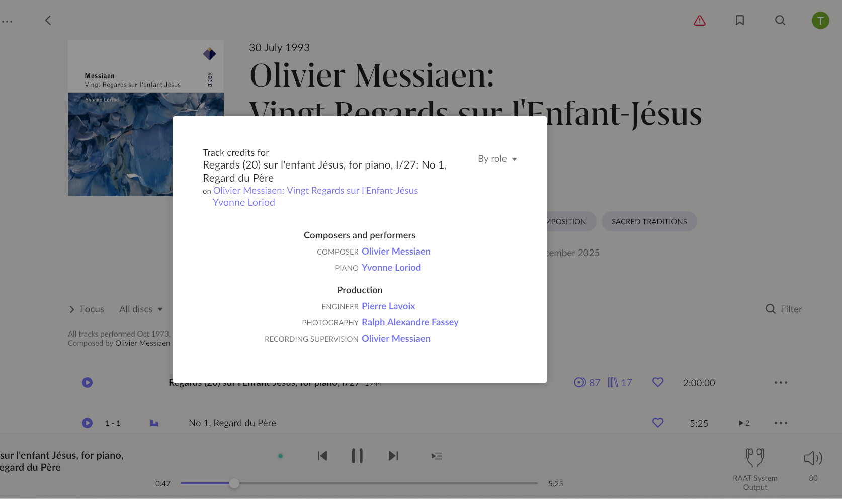

As it happens Messiaen does get a production credit on the Vingt Regards . . . but not for “liner notes”. It’s for “recording supervision”:
So I removed it but it made no difference so I put it back. The bigger point here is that Yvonne Loriod was arguably the most important interpreter of Messiaen’s piano work. She was also Messiaen’s second wife. That Messiaen supervised this particular recording of the Vingt Regards . . . by his wife is by far the most interesting thing about this recording and is the whole point of roon for me. So at a certain point hacking tags to get basic navigation functionality to work is throwing the roon baby out with the foobar water and is missing the whole point.
Are you sure you have removed the non-composer credits from both all the tracks and the album? As soon as I remove both ´Liner Notes´ and `Recording supervision´ for Messiaen, I get the following result:

Yes You are right. I didn’t remove “liner notes” at both the track and album levels. Now it works for this particular case. It is not necessary to remove “recording supervision” so the behaviour must be sensitive to certain production credits. I am aware of the liner notes trick and regularly remove that credit on a case by case basis but unless there is a way of batch removing composer liner note credits from Qobuz favorites it is way too late for any systematic solution for me. I have never experimented systematically either so I don’t know what other production credits consistently produce this behaviour. I was surprised (but pleased) that “recording supervision” doesn’t appear to have an effect on my library.
It certainly helps but I still come across examples with no liner note credits all the time. For example, the OP’s original Rachmaninov example. I have no interest in liner note credits so removing them is not an issue but I listen to a lot of Classical electronic music and Cross-Over electronic where production credits are part of the creative process and I do miss them if I remove them. So outside core Classical repertoire I often find navigating roon very hit and miss. I would prefer not to play the plusses and minuses of tagging strategies off each other depending on genre but I don’t see this ever being fixed.

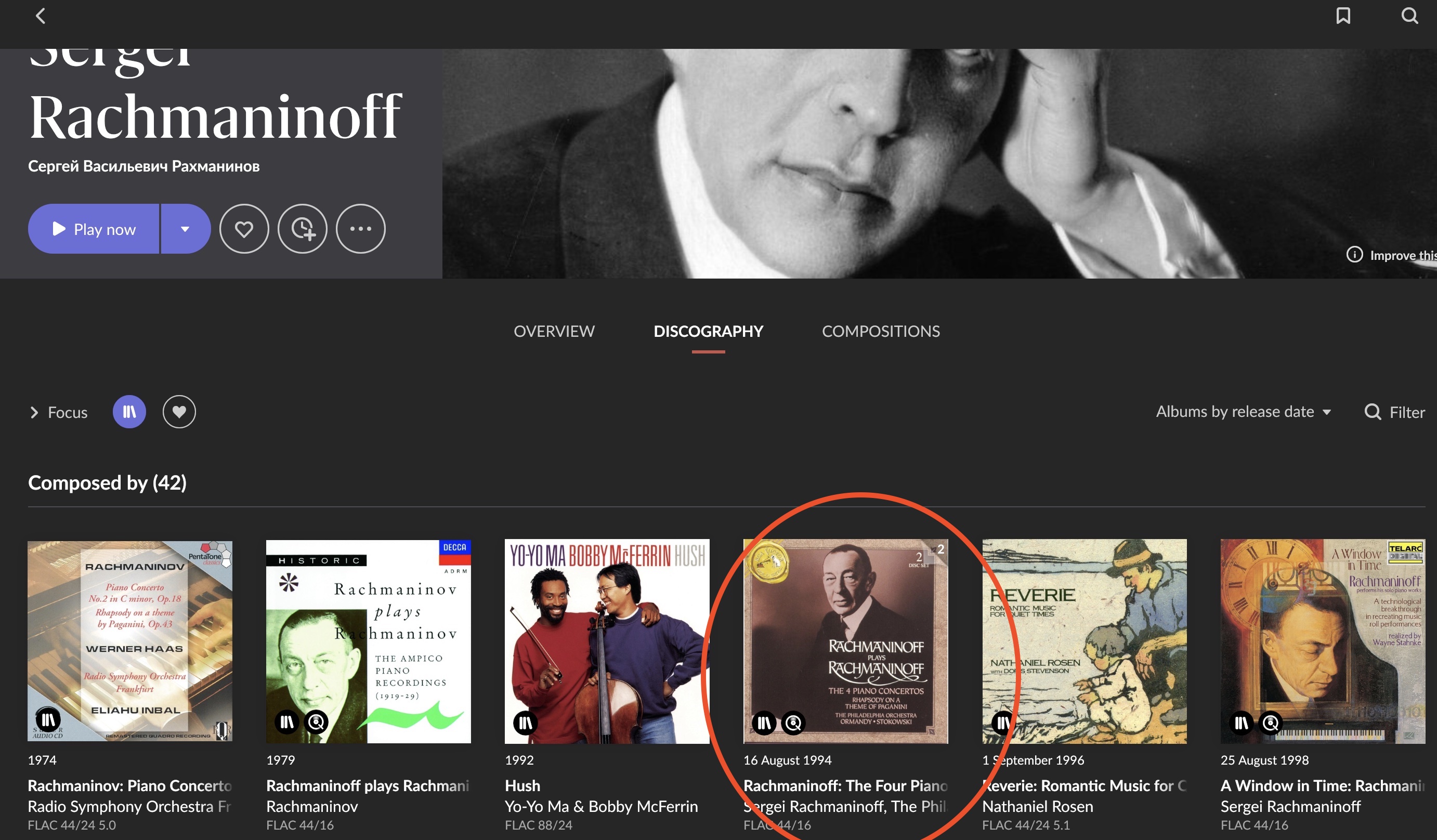

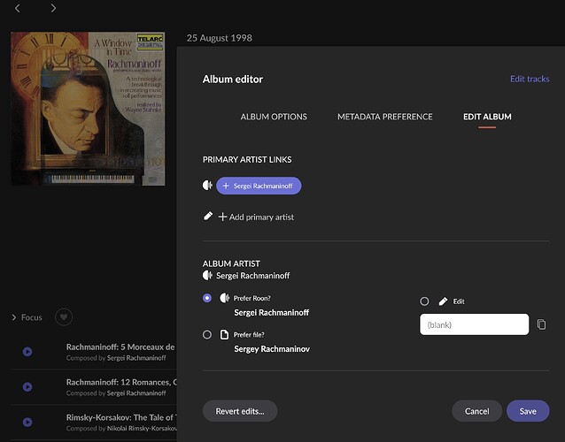

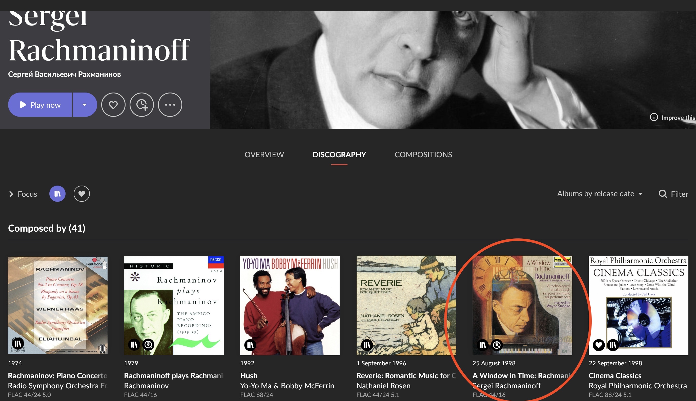

However, no matter what I do with the Rachmaninoff album, it will not display properly under Rachmaninoff as the composer. Perhaps if there was a way to prevent Roon from adding additional credits that do not appear the the file’s metadate, it might work. But I don’t see how to make Roon do this for just this album. Still, the idea of removing correct metadata (ie removing Rachmaninoff as the artist when it is him performing) just to try to appease Roon really bugs me. I’m at the point of giving up on this one. It’s not worth all this hassle. :face_with_symbols_on_mouth:

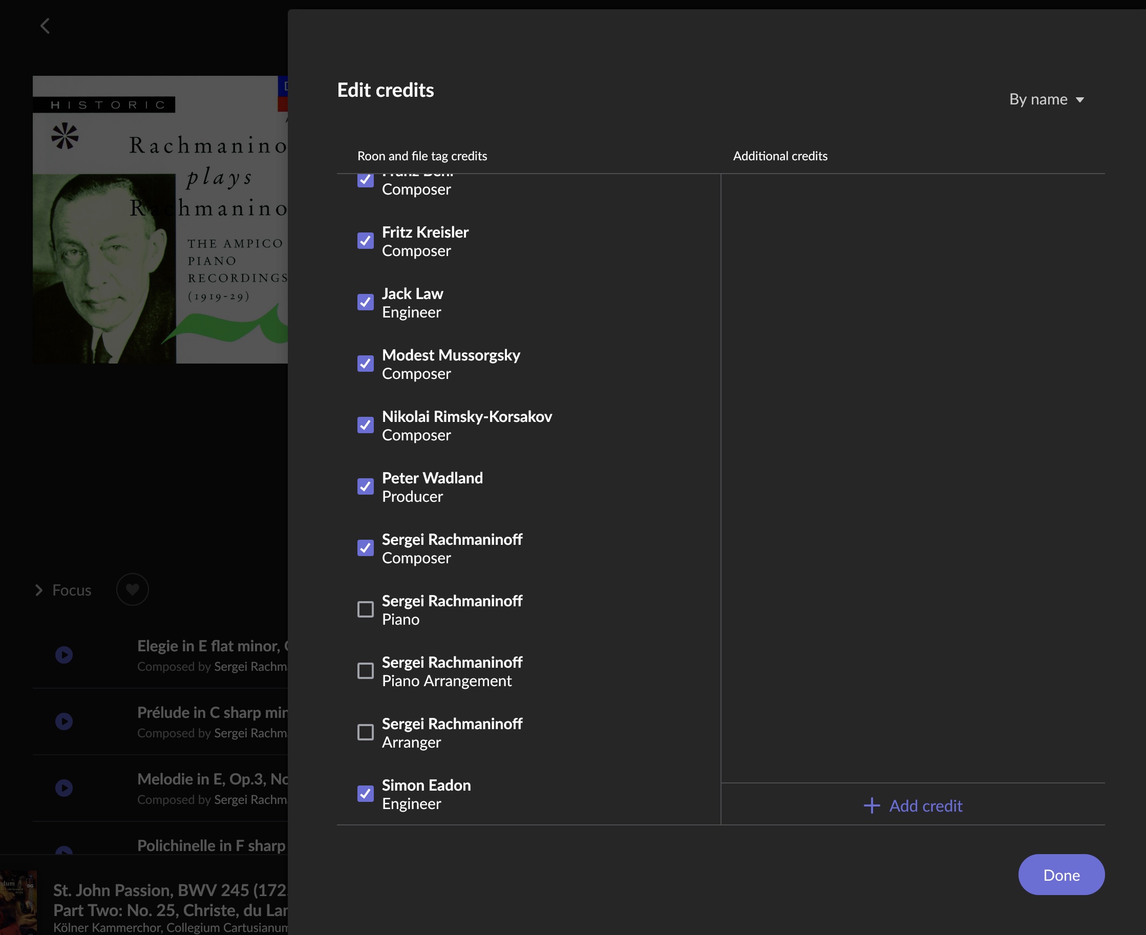

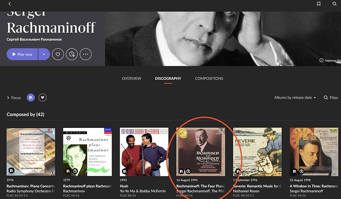

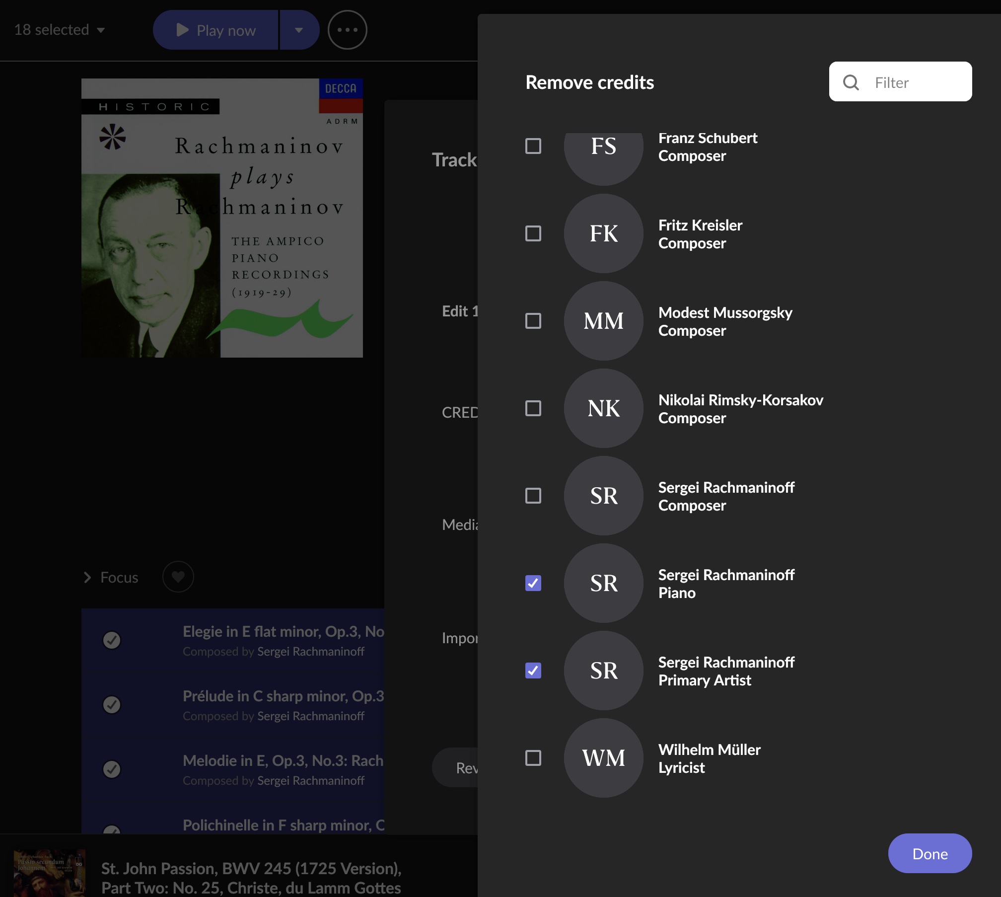

Kind of remembered what had been my initial workaround for these albums. The trick requires 2 editing steps, i.e. removing the composer-performer from the non-composer credits of the album AND the non-composer credits of all the tracks on the album.
Step 1 (Mark and edit tracks, make sure all tracks are marked):
Step 2, edit the credits of the album, remove all but ´Composer´:
Interestingly, primary artist and album artist can be left untouched, they don’t interfere in this case. The album will appear under ´composed by´ section as a result:
Admittingly weird logic and a lot of work, and it took me quite some time to figure that out. I don’t really blame roon for this glitch, it is weird metadata plus a pretty implausible scenario of a composer who had died in the 1940s, playing the piano on a recording made in 1998.
Removing Tovarish Rachmaninov in certain roles such as ´arranger´ or ´piano´ does not bother me that much, as he still is recognized as composer, main artist and album artist.

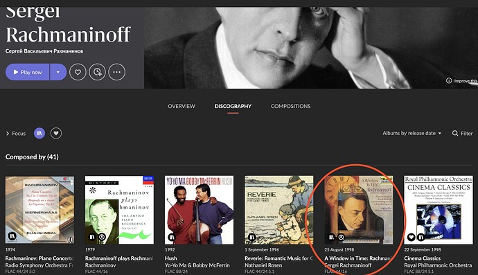

PS: If this one ´A window in time´ is the album in question, it works with my roon and the album being sourced from Qobuz:
Does it work with your local copy as well? Would love to know..

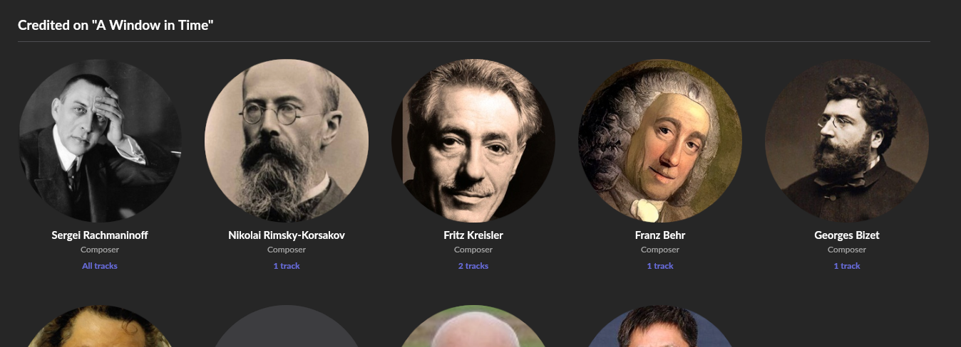

That is the album in question. Doesn’t work for me or the OP. I have a Qobuz version as well. I don’t see any production credits that may explain it.

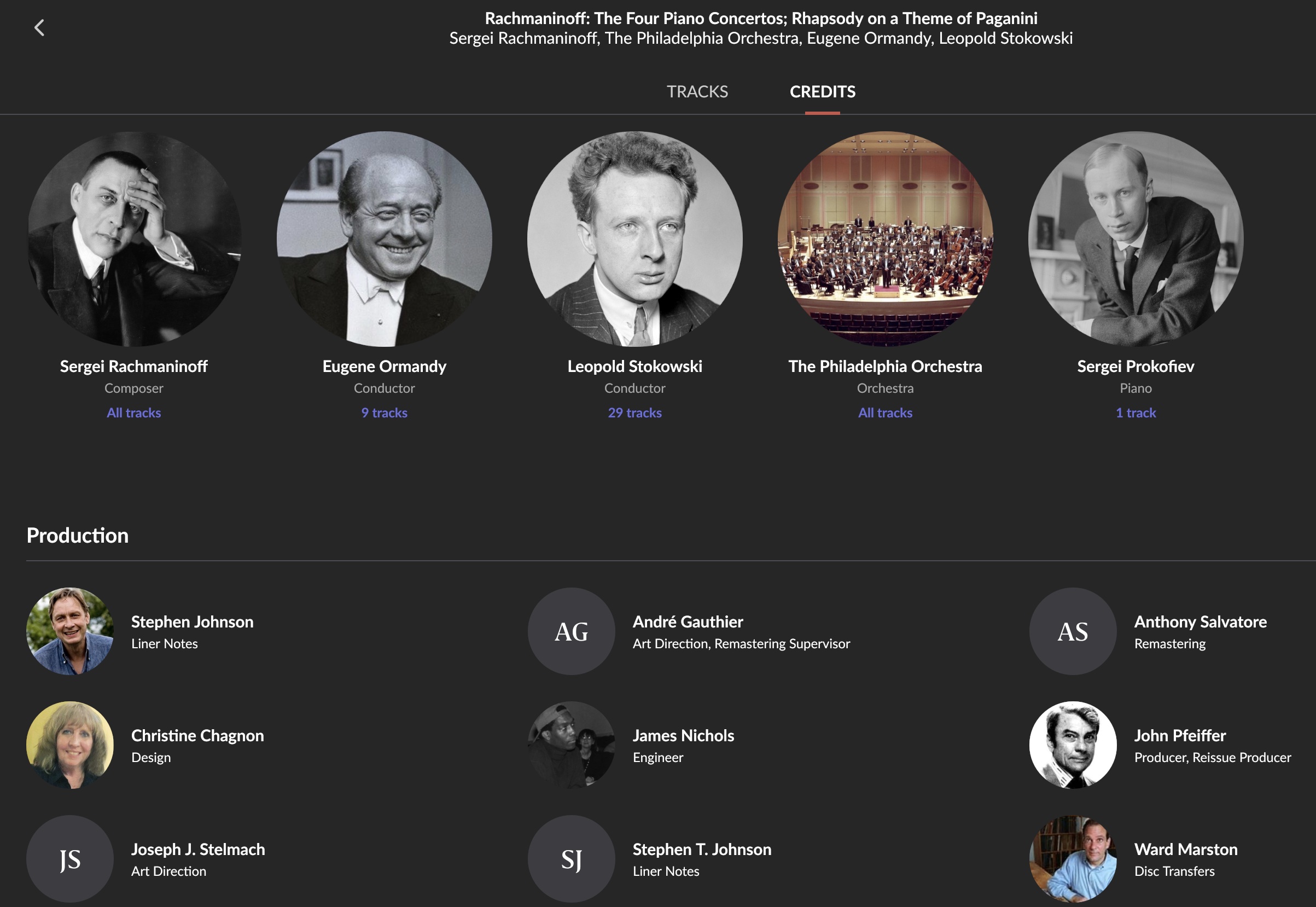

Could you please check for Rachmaninov´s roles in the credits and make a screenshot? I have a suspicion, some credit has survived, preventing my trick from working. It should look like this, solely ´Composer´ and no entry in the production section:
If one other credit than ´composer´ has survived, may it be ´Primary artist´ for the album OR for the tracks, it would not work like with your Ormandy/Stokowski album here:

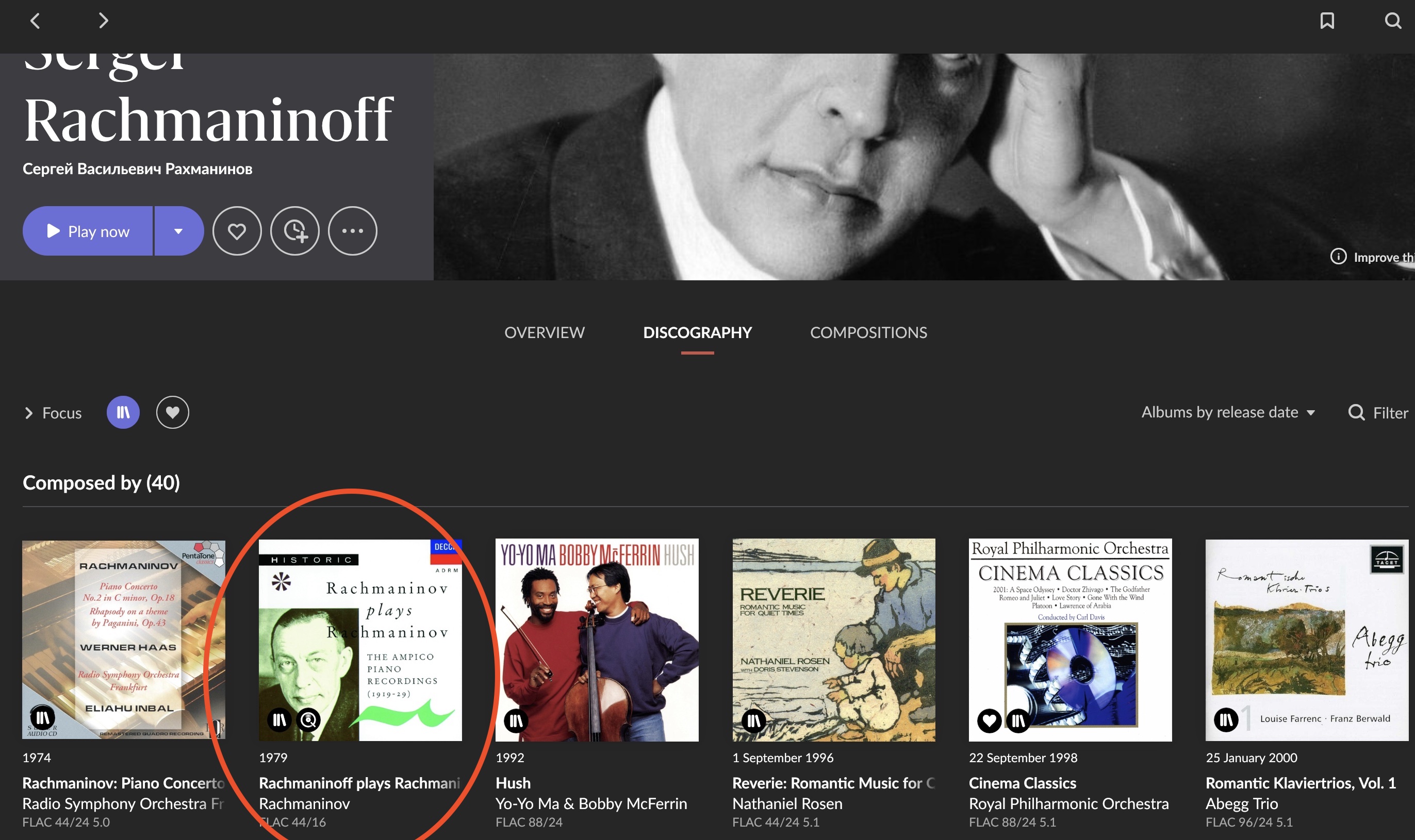

I tried it with my local copy of “A Window in Time”. If I remove all Rachmaninoff credits except for Composer, it will show under Rachmaninoff’s composer page. However, if I leave him as Artist, or Primary Artist, or Album Artist, or anything else besides Composer, it will not show.
You mentioned this in your other example (Rachmaninov Plays Rachmaninov):
This doesn’t seem to be the case for “A Window in Time”. As I mentioned, on this album if Rachmaninoff has any other credit in addition to Composer, the album will not show. :confounded_face:

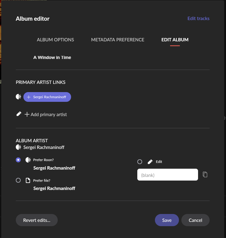

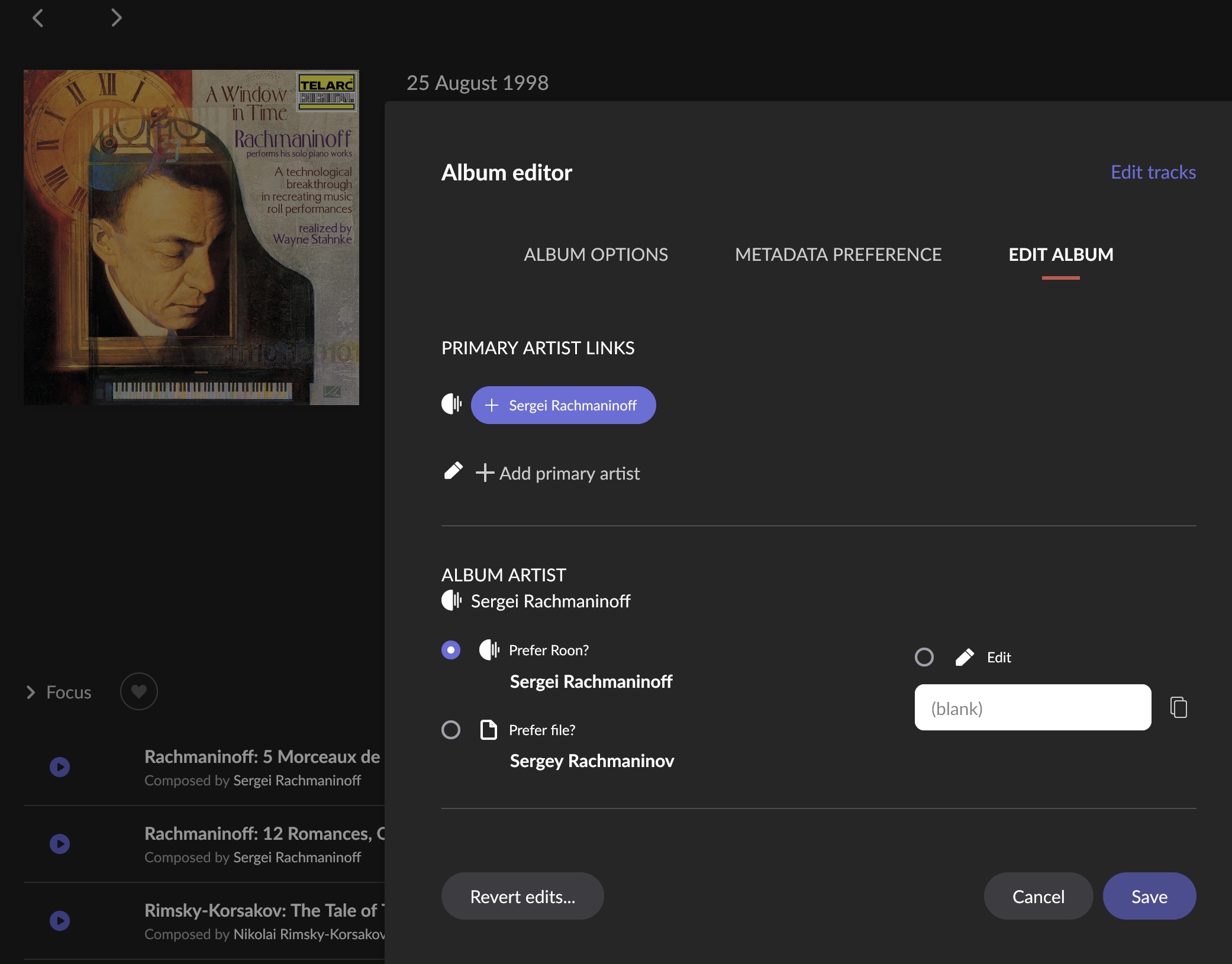

To clarify things: I did not mean a credit ´Primary artist´, in this case you are absolutely right. I meant the album artist link and name under the album title, which can be left unchanged, at least with my Qobuz version.
Thanks for the clarification.
So, what’s the difference between what Album Editor shows and what is shown when looking at the album credits? I see Rachmaninoff listed in Primary Artist Links and Album Artist in the Album Editor, but in the album credits Rachmaninoff is just credited as a Composer.
(My brain hurts… :face_with_spiral_eyes:)
