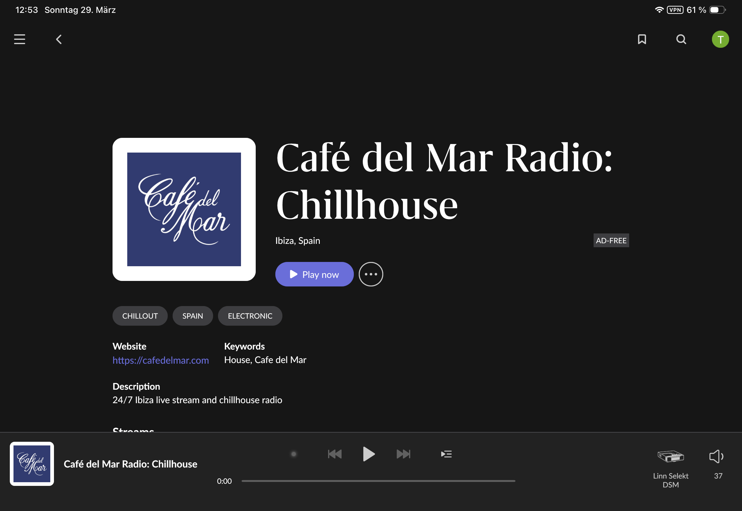

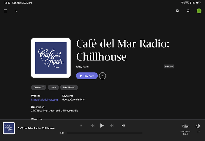

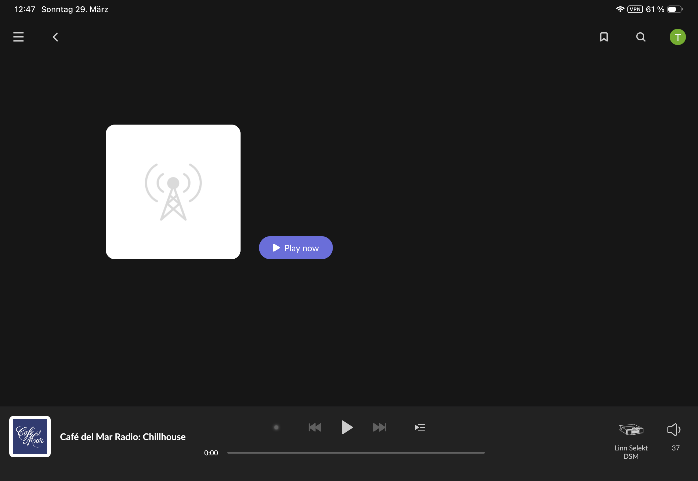

When my Intel NUC13ANHi7 is beeing powered on in the morning the radio stations are not working - not on iPad, iPhone and Windows PC.
After a reboot is works again
It has been the problem since the latest update (2.62 - 1641)
There are no problems in playing lokal files or Qobuz when the NUC is powered on in the morning. Only radio is a problem. It needs a reboot every time.

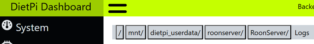

Our apologies @Torben_Rick we’re unable to review a diagnostic report from your server, could you please use the directions found here and send over a set of logs to our File Uploader? Once logs have been uploaded, please let us know so that we can check the server for your files, thanks!
Hi @benjamin I have uploaded Roonserver_log from 04.04.2026 where the problem happens again.
