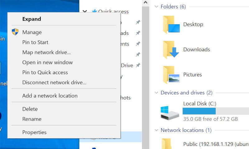

You are using Nucleus as your Roon Server.
You’d need to connect to it via SMB like on the photo (add network location).
and then you need to enter address, for your case it should be this :
\\192.168.12.10\Data\Storage\InternalStorage
If you are prompted to enter credentials it should be “Guest” for both username & password.
Then please find “Roon Server” folder - compress to zip archive and send to us folder “Logs” from it.
