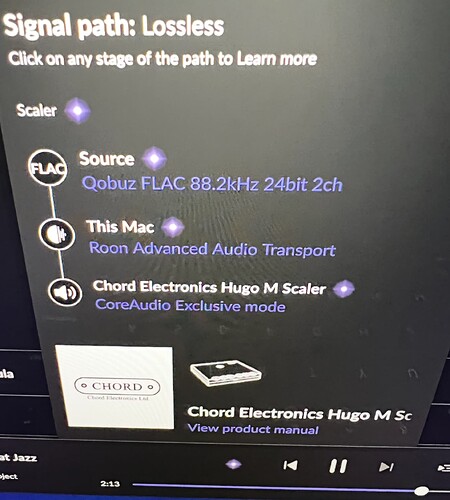

Diagnostics indicate that RAATServer on this Mac has intermittently crashed and restarted in the last few weeks - if this is occurring during playback, it could quite possibly cause the symptoms you’re describing. However, the last instance we can pinpoint in logs occurred nearly a week ago. We don’t see any network errors affecting audio transport or any logged transcoding/DSP issues in the last week.
Can you provide the name of a track, or an approximate timestamp, of when the last audible artifact occurred? Please also share a screenshot of the Signal Path in Roon. This should expedite our investigation.

Hi Connor. The glitching just happened about 6 times during the last two tracks from the album “Shades of Sound” by Ryan Truesdell. Screenshot of the signal path is attached.
@connor It also just happened about 1:30 into Beauty Pill’s “Rideshare” from my library, and then again at 2:50 as I typed this. The signal path is the same except that it now originates with the local ALAC file so it shouldn’t be related to internet connection.

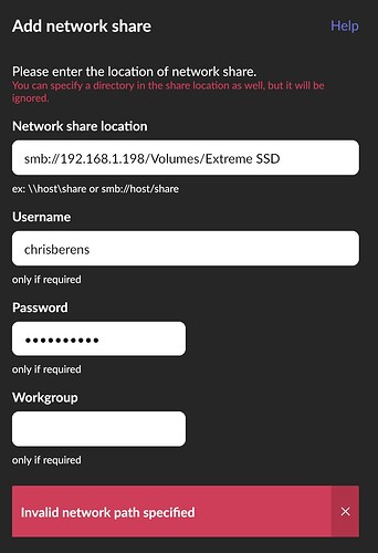

Tried that, but Roon says “invalid network path”
Did I do something wrong?
There is a space character in your network path. Perhaps that’s the problem?
Thanks, I already tried it without the space too, same result.
FWIW I also tried replacing the space with underscore, and replacing smb://IPaddress with \host\share just to cover bases.
