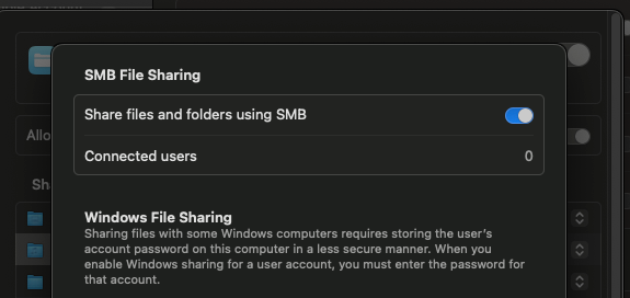

Another area to review - within your macOS Folder share settings - toggle ‘share files and folders via smb’ on and off:
I’d also check your ‘Full Disk’ macOS settings and toggle Roon on here.
Let me know if any of the above help! :raising_hands:
Thanks @benjamin I tried those things and nothing has changed. It still says “invalid network path” regardless of how I enter info there.

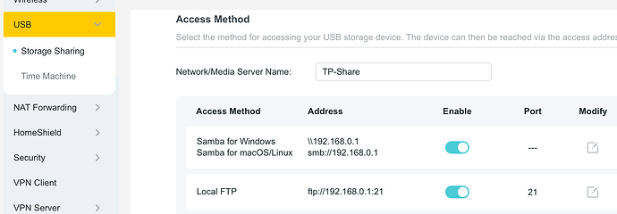

Just another thought… maybe it’s not relevant for you but maybe it’s useful…
Does your router offer you the opportunity to plug in an external drive? Mine does. When I do it, the disk shows up as a network drive which is reachable by Roon. Is this an option for you too, assuming the SSD you mentioned is portable?
Thanks Arlen. There’s a USB port on the router so I plugged the SSD in but don’t see it on the network.
I decided to just move on and set up the iMac as server again. This means starting over without a database, but oh well. I’ve been using it most of the day without any glitches and that’s much more important!
You will have to enable it in your router’s settings in order to see it. Something like this:
