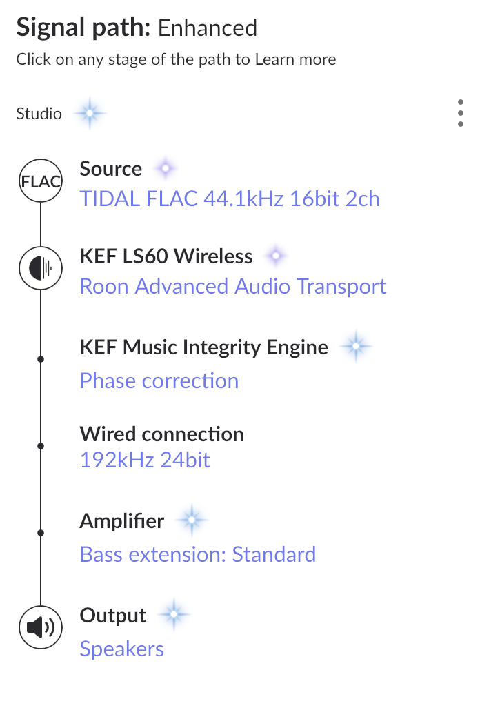

Thank you for your report. Roon Ready shouldn’t introduce audible artifacts unless DSP has been inadvertently applied or there’s a problem with the analog stage itself. You’ve ruled out the latter by testing other digital inputs and software, so let’s see what Roon is sending when you’re connected to the KEFs and playing.

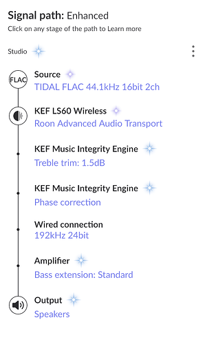

Can you please share a screenshot of the Signal Path within Roon? This will be fully transparent to the stages in the digital chain.

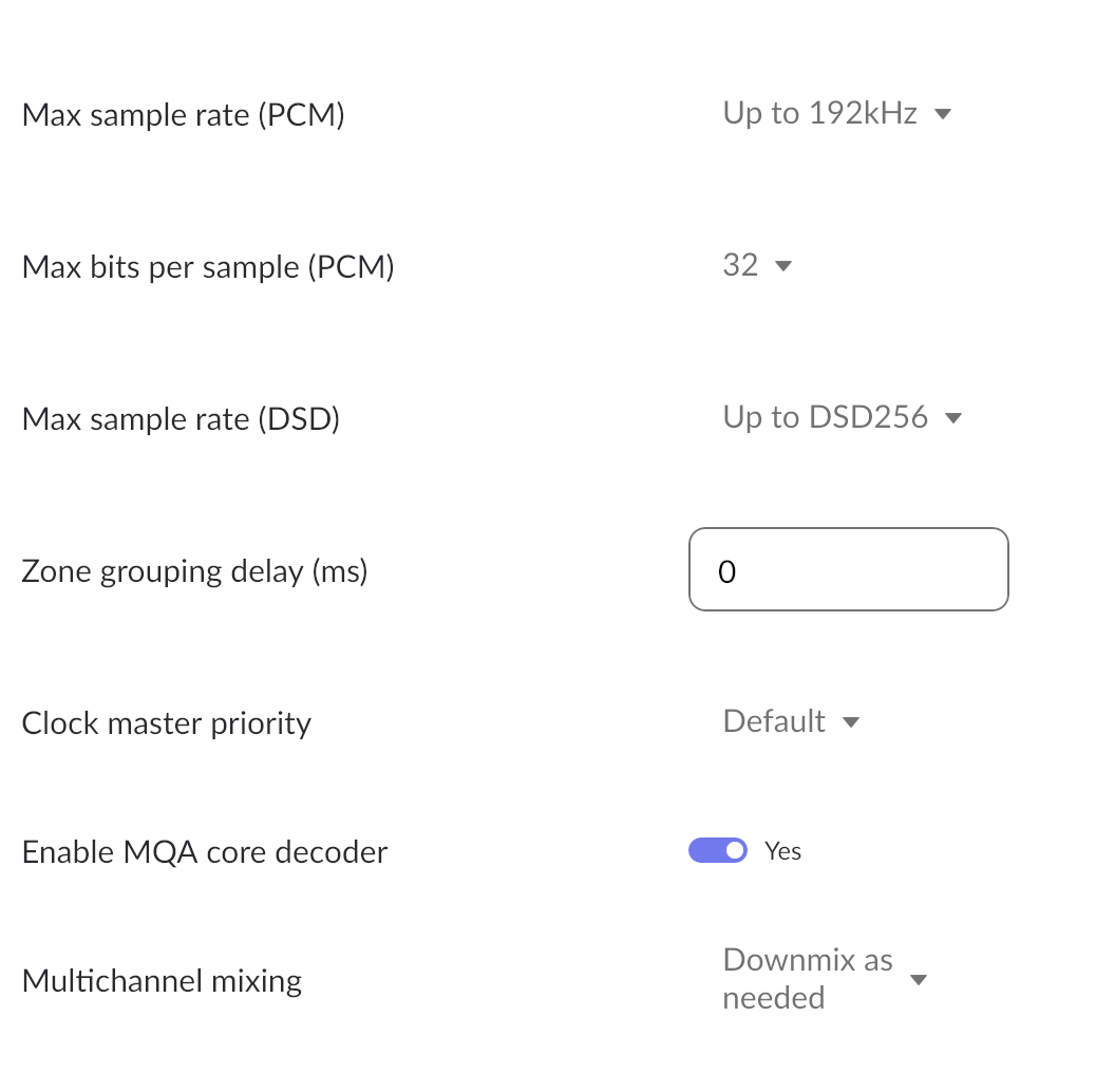

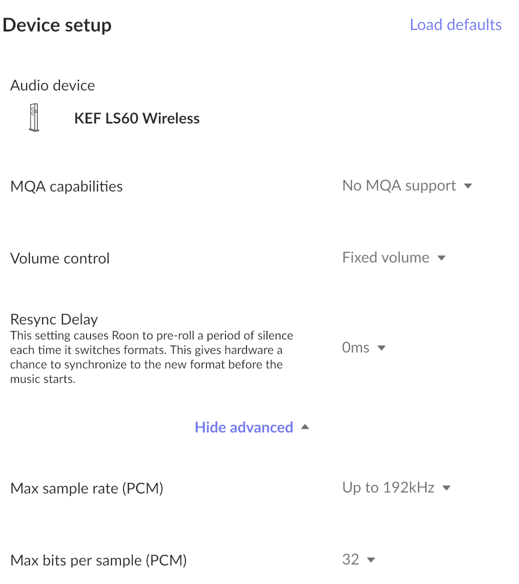

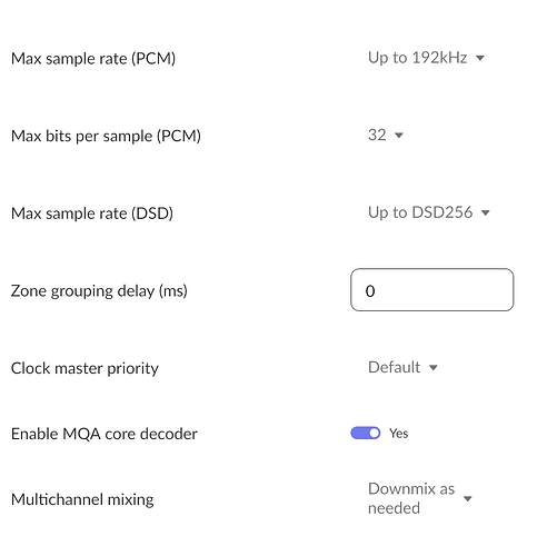

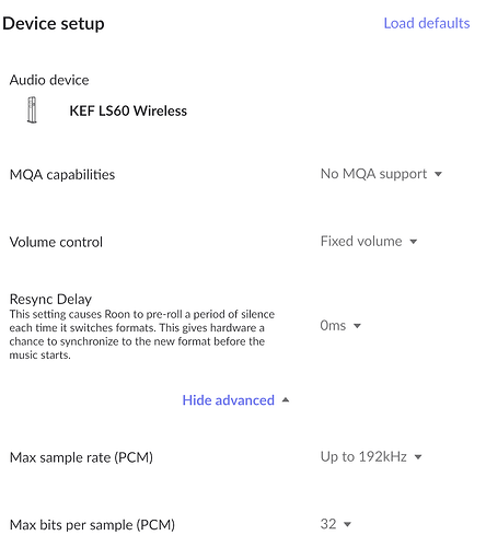

Please also share a screenshot of the Settings → Audio → Device Setup page for the affected Zone.
We’ll gather logs in the meantime. Thank you.
This path does it too.

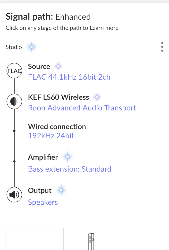

And this too.

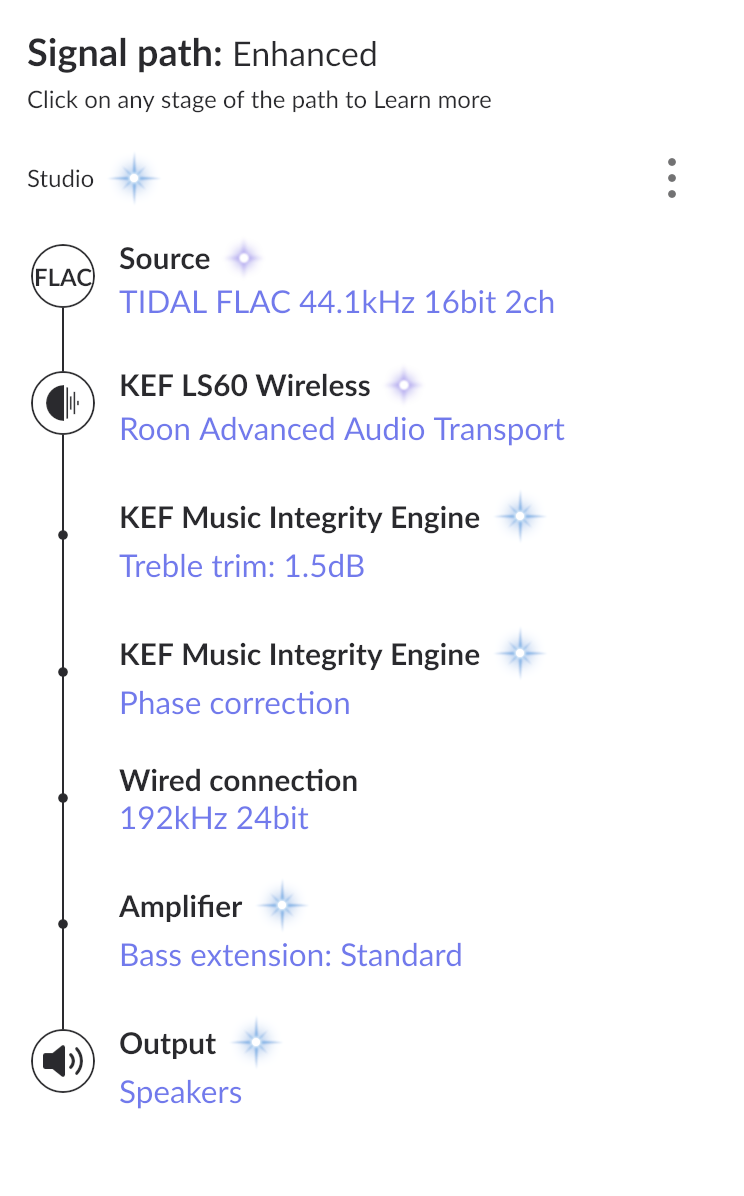

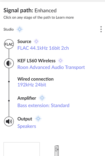

Thanks, conner,
I hope these signal paths help. I’ve supplied KEF with MAC address and firmware version of the speakers and the pertinent information about Roon setup on Monday.
