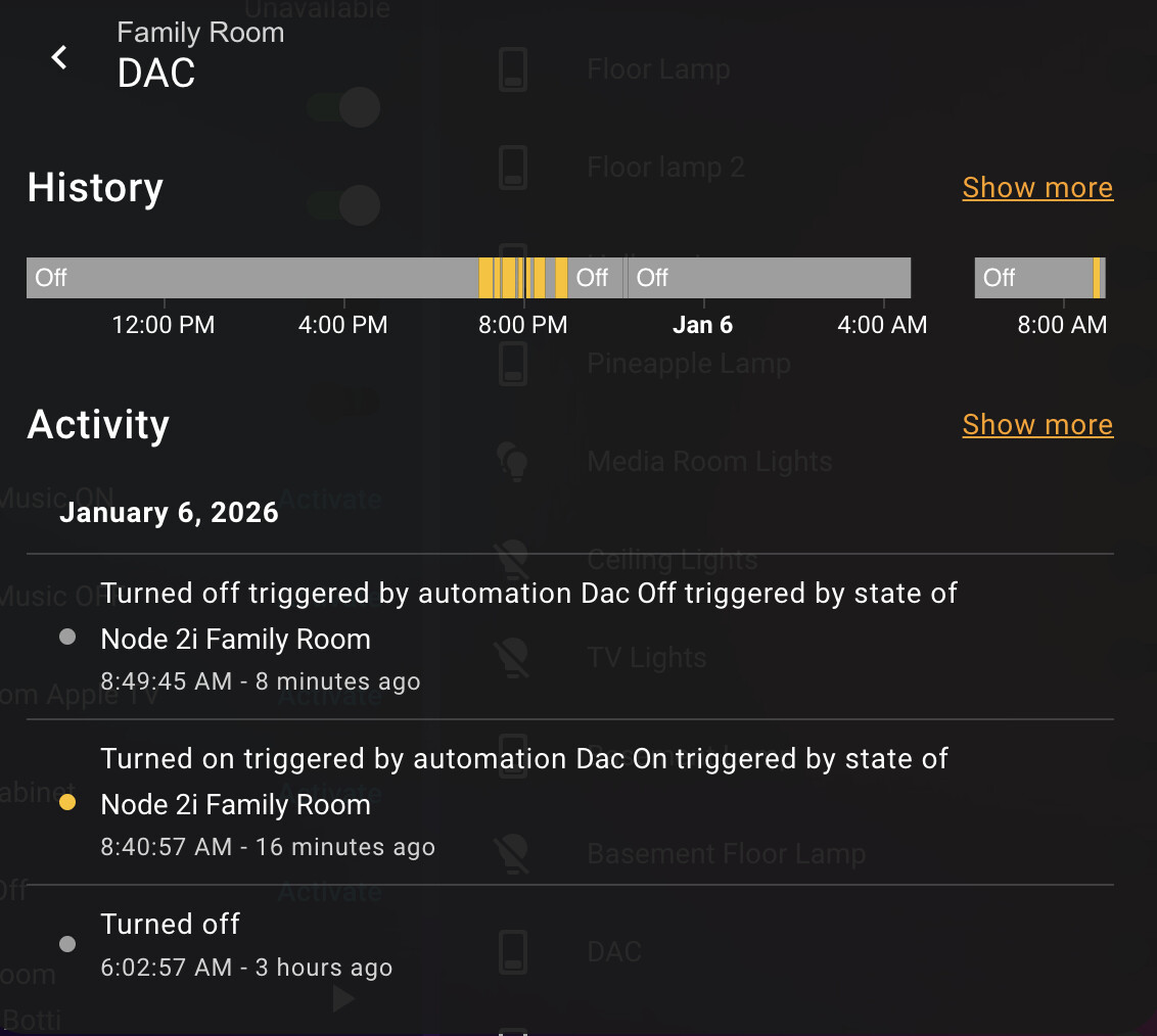

Here is the time stamp of the last issue. I have Home Assistant and my DAC is triggered to come on or off when the Node plays/pauses. Triggered on at 8:40:57 and shut off at 8:49:45. This is for the Node 2i Family Room. Played for close to 20 minutes on the Node 2i Media Room and I don’t seem to be experiencing the same issue.

Thanks for sharing that screenshot with us.
We have reviewed automated report from your machine and could have spotted following:
01/06 08:49:45 Trace: [Bluesound NODE 2i @ 192.168.50.7:36237] [raatclient] GOT [4] {"status":"Success","control":{"button":"pause"}}
01/06 08:49:45 Trace: [zone] Node 2i Family Room received transport control from endpoint integration: pause
01/06 08:49:45 Trace: [zone Node 2i Family Room] Node 2i Family Room received transport control from Bluesound NODE 2i: pause
01/06 08:49:45 Trace: [zone Node 2i Family Room] Pause
01/06 08:49:45 Info: [zone Node 2i Family Room] Canceling Pending Sleep
This log clearly describes that it was “pause” signal coming from “Bluesound NODE 2i” and Roon correctly paused the media playback on it.
So in this case it likely means that the problem is not with Roon but with the Node 2i sending unexpected pause signal.
