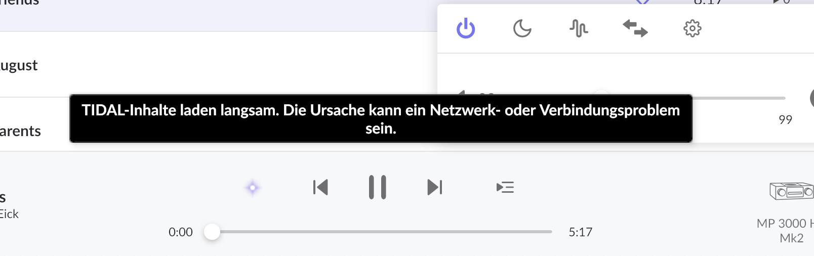

Tidal stops running , or jumps from one song to another song randomly
Fritz!Box WLAN 250 MBps down 50 Mbps up, Ping 10 ms stable works with video streaming . tidal works nicely when I use tidal direct at my Hifi system

From a recent diagnostic report, we’re seeing frequent network-related errors that could be causing the song skipping with Tidal. As an initial first step, could you please setup a direct ethernet connection from your Mac directly to your primary router, and let me know if you experience the same issues?
We’ll be on standby for your reply!
Thanks yes this seamed to solve the issue , at least I was able to run ROON Tidal in HiRes for more than 30 minutes. So I hope that works on the long rung. In case it won’t I will post another query Thank you
