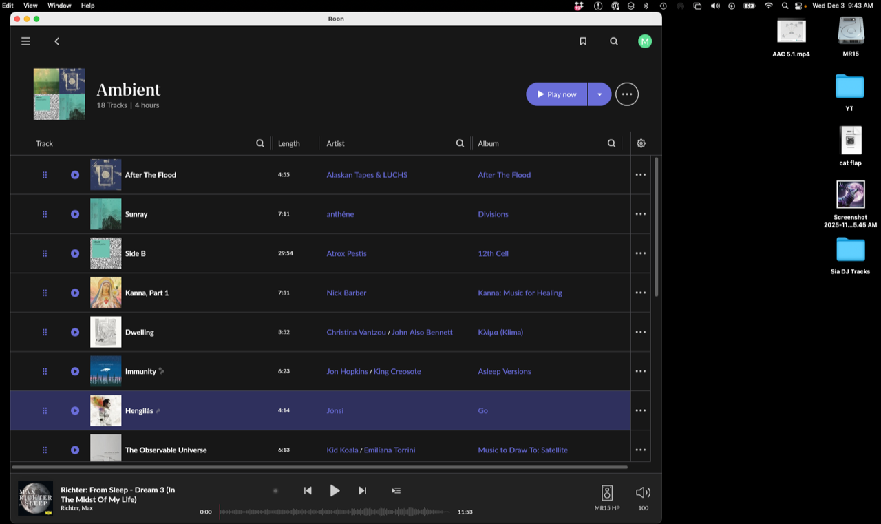

Hi. Still having random stops with roon playback of local music files. Not sure if this ALSO happens with streaming because i dont use streaming. In order to mix it up, recently moved Roon server onto a new mac mini, and converted all library to FLAC. So its all the same format now (although some different sample rates etc). After a few hours of a playlist playback, roon just stopped. Please see screenshot for approx time. I thought that the issue (previously) may have been running roon server and the end point on the same laptop, but now I have seperated the two and I still have the same issue. The commonaility is that the end point in both cases which stops is a 2015 intel macbook pro. However, this is the end point that kinda needs to work! Please help! :) Can you see what happens on your side around the time of the stop?

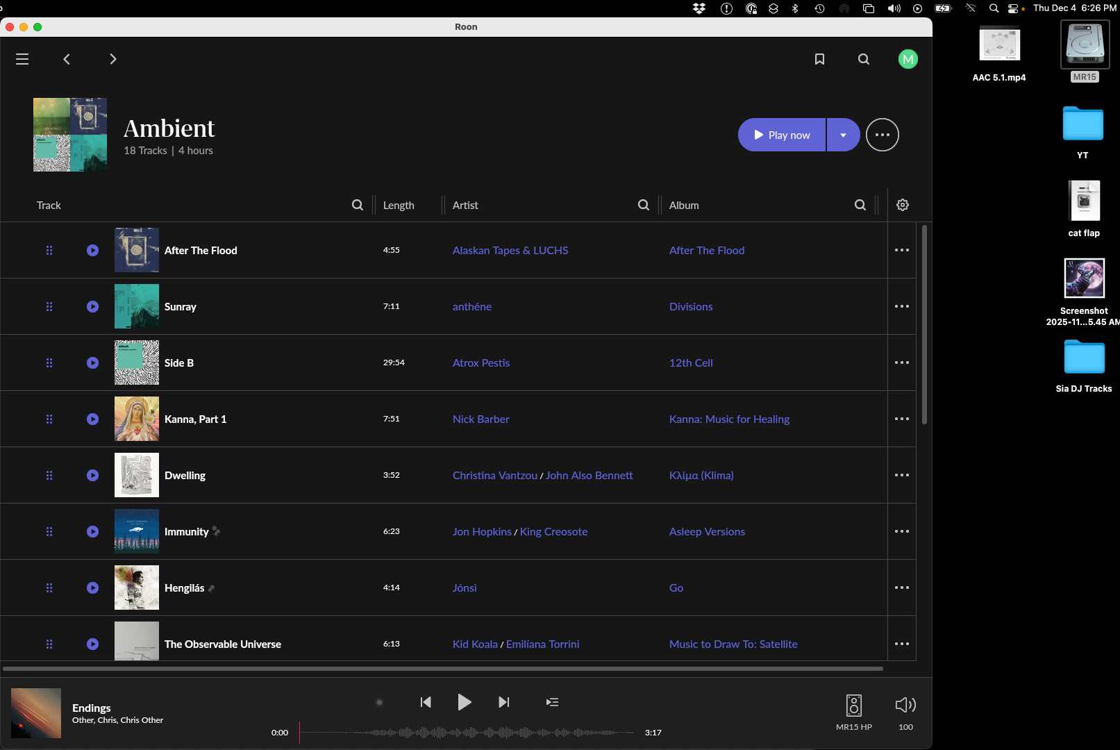

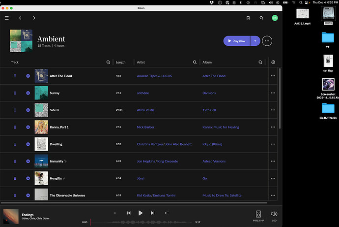

Stopped again today = screenshot shows song and timestamp - thanks
