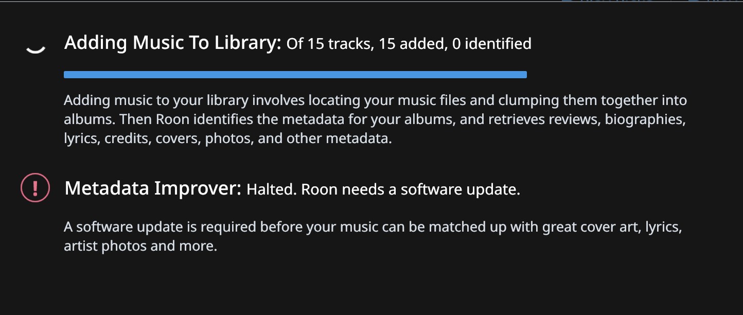

Hello - I am seeing a constantly spinning wheel, which I know signifies syncing, etc. But it’s not going away and when I click on it, I get an irrelevant message. My system is completely to Roon spec (see last photo).
I’ve logged out of Tidal via Roon, cold-booted the Core and everything else, etc. etc. etc. Confused!
Roon Stuck Spinner
Typically that message persists when Roon can’t reach their backend services … I’d suggest a full reboot of your network gear and the Roon core.
If that does not work, I’m out of suggestions and Roon’s @support will have to looked deeper.
