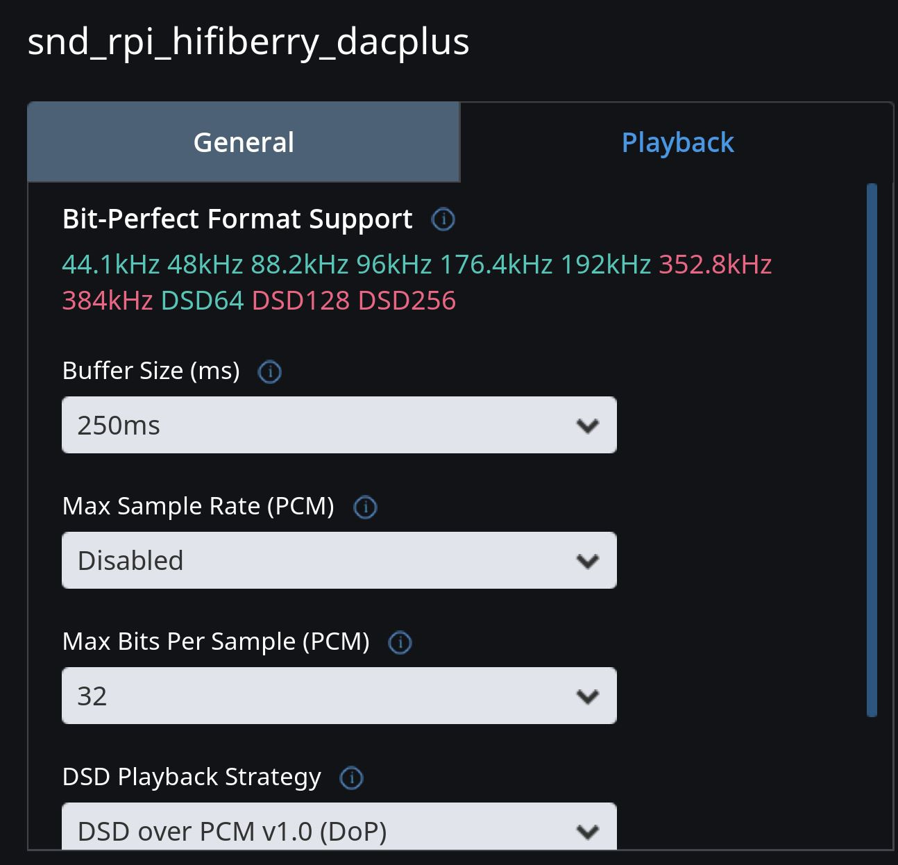

Successfully installed the latest DietPi and for the most part all works as expected with the exception of DSD playback. I have installed the correct Linux Kernel via the DietPi install and indicates that the correct Kernel is installed to allow for DSD playback, but Roon via DietPi wants to convert everything to PCM. What am I doing wrong?
PCM rates up to 192 allow DSD64 so it should play that. DSD128 and DSD256 require PCM rates of 3xx and 7xx which that device cannot do.
I have instaled DietPi, the additional Kernel that allows the higher PCM rates, and Roon via the DietPi interface. See URL/Thread below;

Nothing I have tried will get DSD to play DoP with any of the 24/192 DACs like IQAudio or Allo to name a couple, all work fine on converting to PCM. I tried the 384K Kernel too and still no good even setting max rate to DSD64 still silent.
Same in Volumio for that matter too.

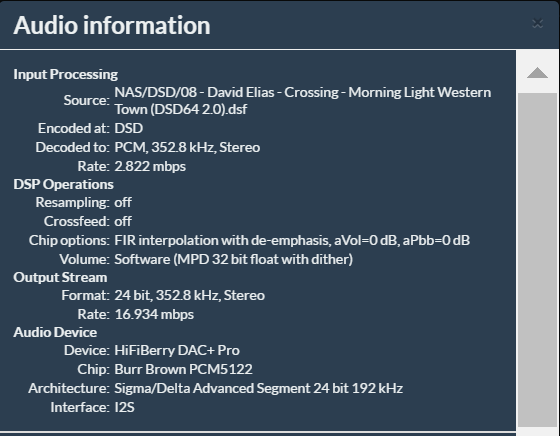

As you stated previously and according to my logs and Audio Output I see where the audio/dsd file is being converted to PCM. Thanks again!
Last login: Fri Jan 13 15:58:31 2017 from 192.168.1.141
pi@moode:~ $ cat /proc/asound/card*/pcm0p/sub0/hw_params
access: RW_INTERLEAVED
format: S24_LE
subformat: STD
channels: 2
rate: 352800 (352800/1)
period_size: 16384
buffer_size: 65536
