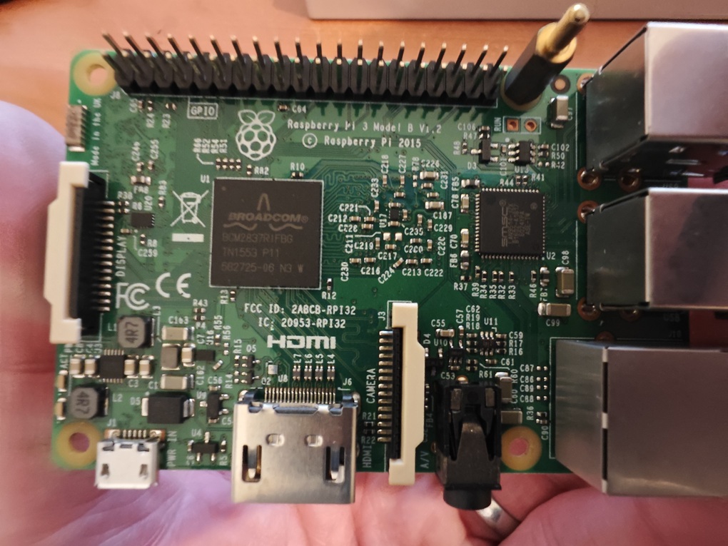

  • Stripped down the RPi+Hat to ensure that all of the connections were clean and tight, and to double/triple check that it’s an RPi 3B (it is).

I flashed the RPi 3B version, yes. And that version was working just a week or so ago. I tore down the RPi at 11pm last night to double check it was a version 3.
