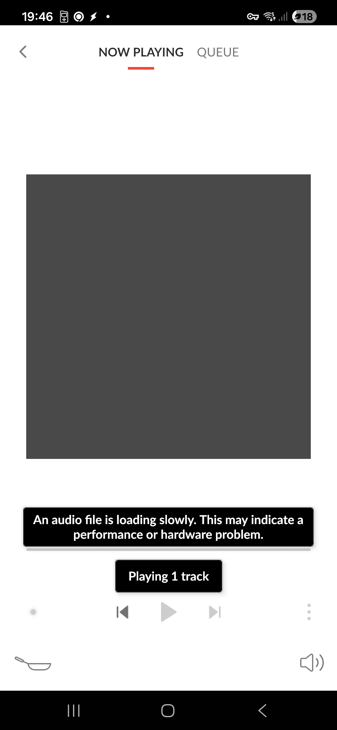

I’ve loaded it on the one that has been most problematic (and is easiest to get to). Same problem unfortunately, 96kHz 24bit roon/ropieee thinks everything is fine, but the speakers sound like playing underwater. I’ll see if I can get to the bedroom one you looked at the feedback for, because that DAC supports up to 32bit 192kHz and wasn’t even playing 24bit 48kHz the other day.

You’ll see not long ago I had Evanscence - Lost in Paradise playing for about 8 seconds… (this was the underwater sounds). I paused and unpaused hoping it would recover, but it didn’t, so then I skipped it. Prior to that I had some Taylor swift songs playing that I knew were 48kHz 24bit and they played ok, but have been problematic on my other unit.

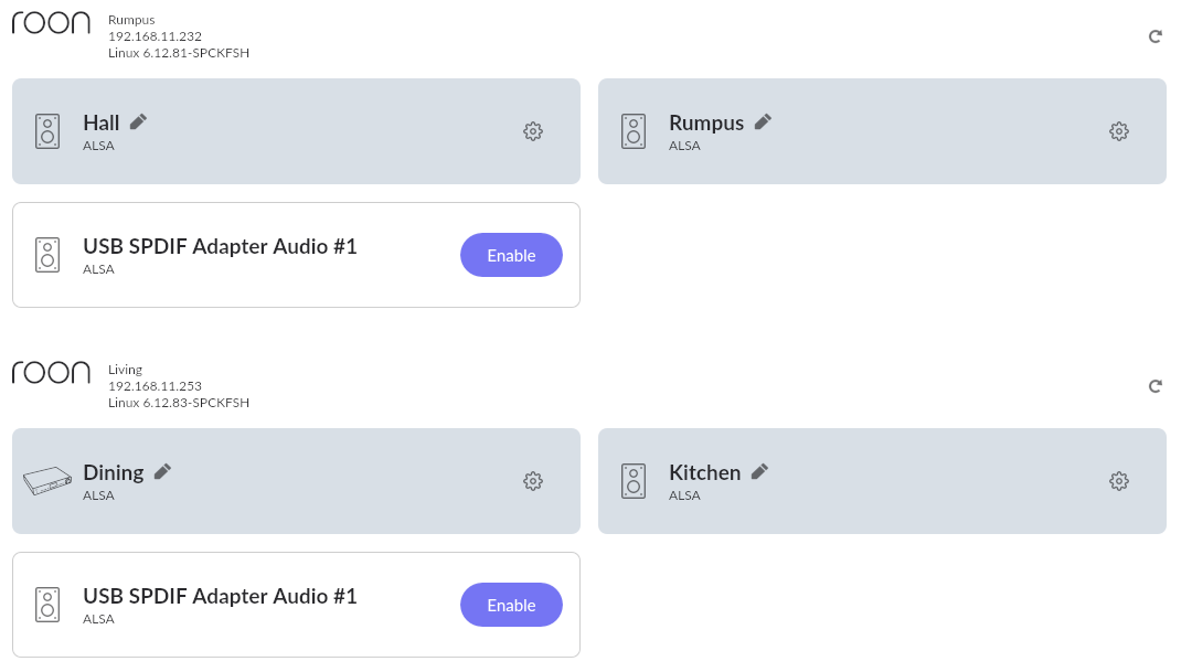

The other weird thing: I see 2 (!!) USB SPDIF adapters… I’m wondering if the dongle is behaving weirdly, and for some reason that worked with older versions (kernel?), but now is acting up…
That USB DAC has always shown up as 2 devices and I’ve always used the first one (I’m not sure why it’s 2… I’ve read explanations that didn’t make that much sense to me).
