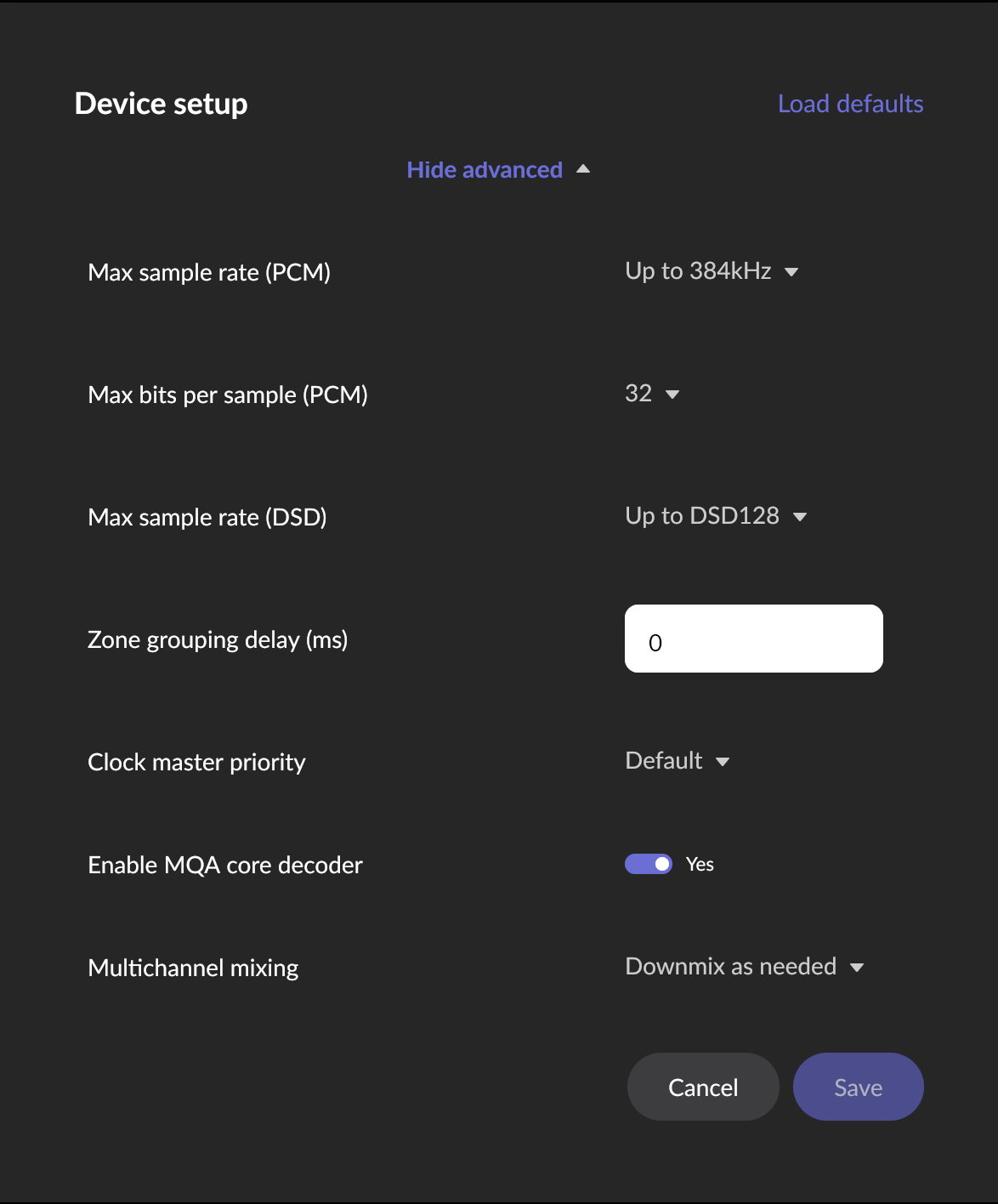

Anyway, my NDX2 settings (default, except I might have enabled the MQA core decoder setting):

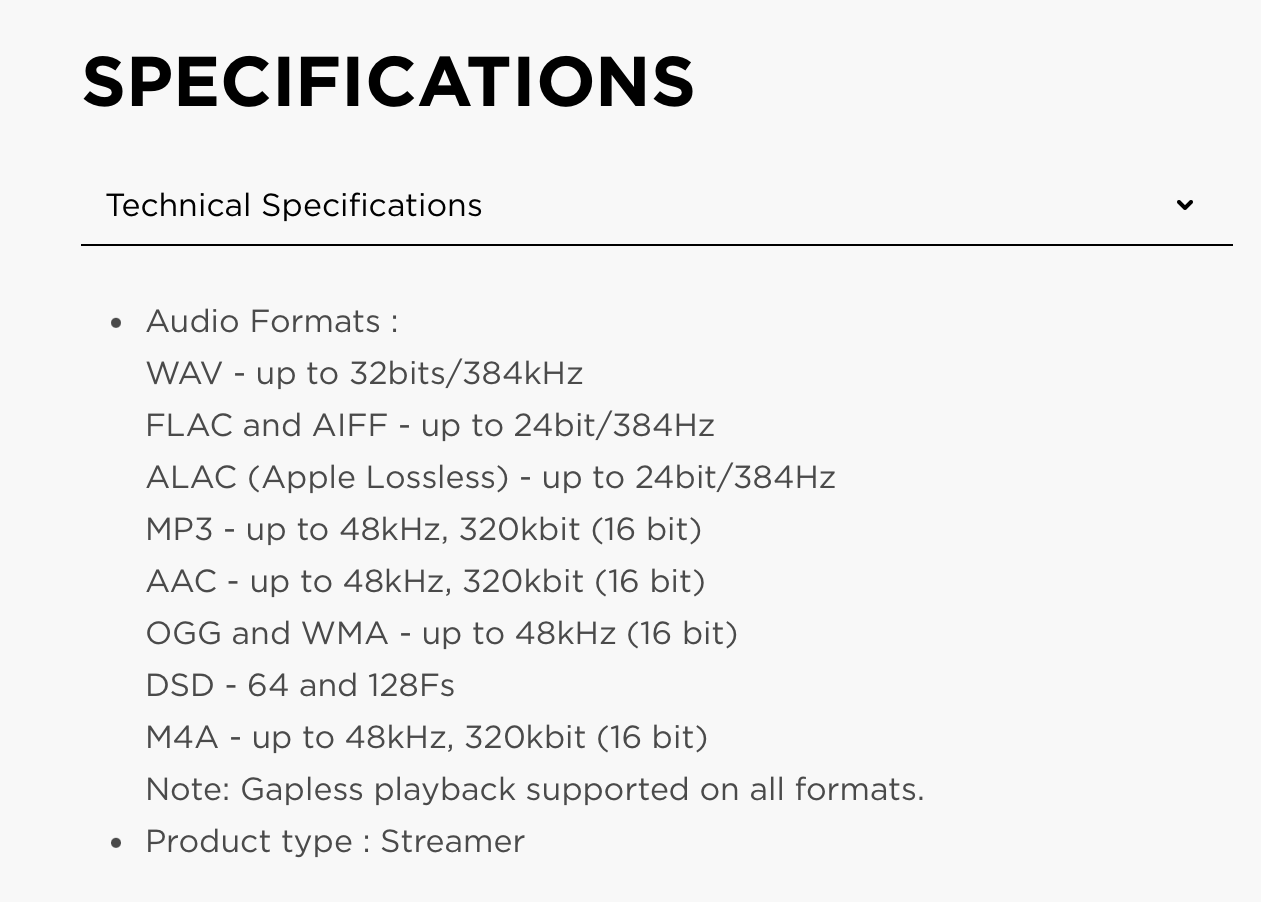

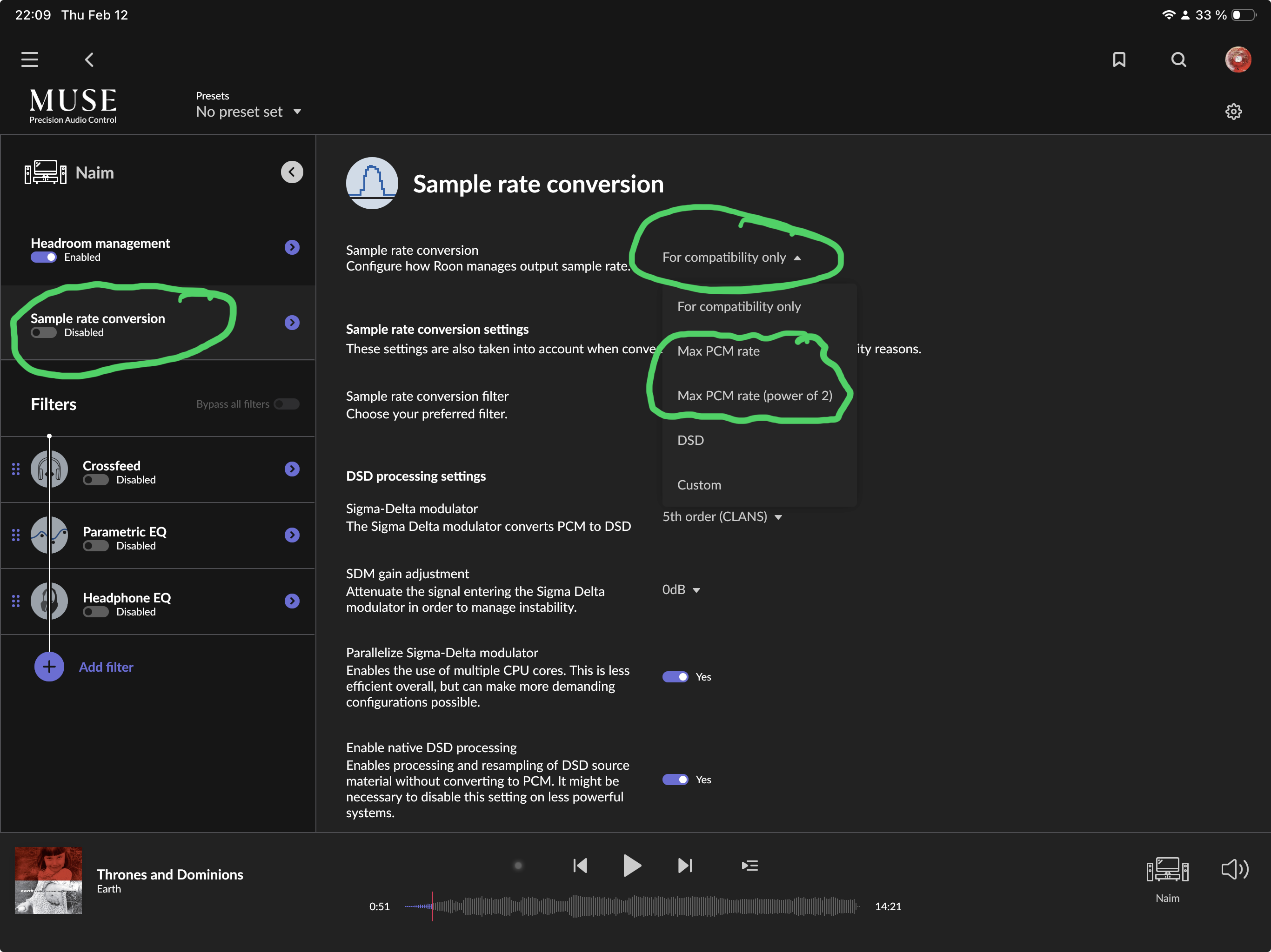

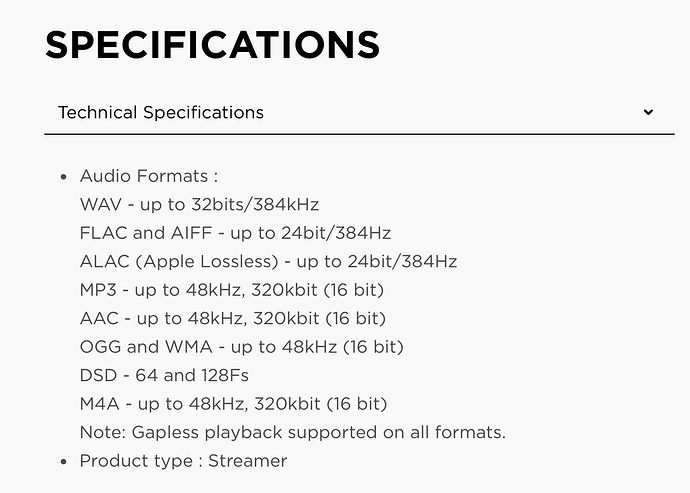

Of course, if you think that Roon makes a better conversion, you can go to MUSE and convert everything to the maximum of 384 kHz that the NDX2 accepts as input. I tried this in the past but if there is any audible difference at all, I preferred letting the NDX2 do its thing. YMMV.
As you can see here in the specifications, the maximum input is 384:

If you want to play with it, the upsampling in Roon is done in MUSE > Sample Rate Conversion > Max PCM Rate. (I usually have it off because I let the NDX2 do its thing and my source material never goes to 384. Otherwise you may want to choose „For compatibility only“).
Though even then, it will still oversample to the 705.6/768 internally, you can’t change that.

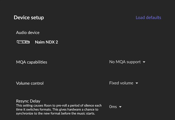

And note that I have set it to “fixed volume” because I feed it into a NAC 252, and therefore using Naim’s system automation to control the volume by Naim’s remote in the preamp, as Naim recommends.
You could theoretically switch it to variable volume, and then you could control the volume via Roon. However, the digital volume control in the NDX2 is implemented only in 32-bit and without a lot of effort, as Naim didn’t really intend it to be used. It’s only there because digital volume was needed to achieve some certification, AirPlay I believe. On the other hand, people on the Naim forum tried it and didn’t report any really audible poor effects (and this says something on the Naim forum, where they usually invent all kinds of effects out of thin air). So YMMV, again :slight_smile:

The fact that they provide system automation in the first place, so that the NDX2 remote can control the NAC volume by turning the NAC volume motor, is another hint. They could have saved on that if they thought otherwise. (And I think they continue to do so in the New Classic and the NSS 333 - instead of implementing improved digital volume in the streamer, they put the fancy digitally controlled ladder volume control into the new preamp instead).
Finally, mostly to the OP, @Christian_Bolton:
32-bit digital volume is generally known to be problematic because reducing volume means that the least significant bits are cut off, and with only 32 bits to play with it might reach into audible bits at least if reduced to low levels. (That’s why Roon’s DSP volume is implemented in 64 bit and data gets increased to 64 bits before volume changes are calculated, then downsampled again).
You can try it yourself, of course. With variable volume on the NDX2 it might become more audible the lower you turn the volume in the NDX2, compared to the same audible volume with the NDX2 as fixed and the volume controlled by the amp. Though the quality of the amp and its volume control will play a role, too. Though if you set it to fixed, make absolutely sure that your amp volume is turned down before raising it slowly.
