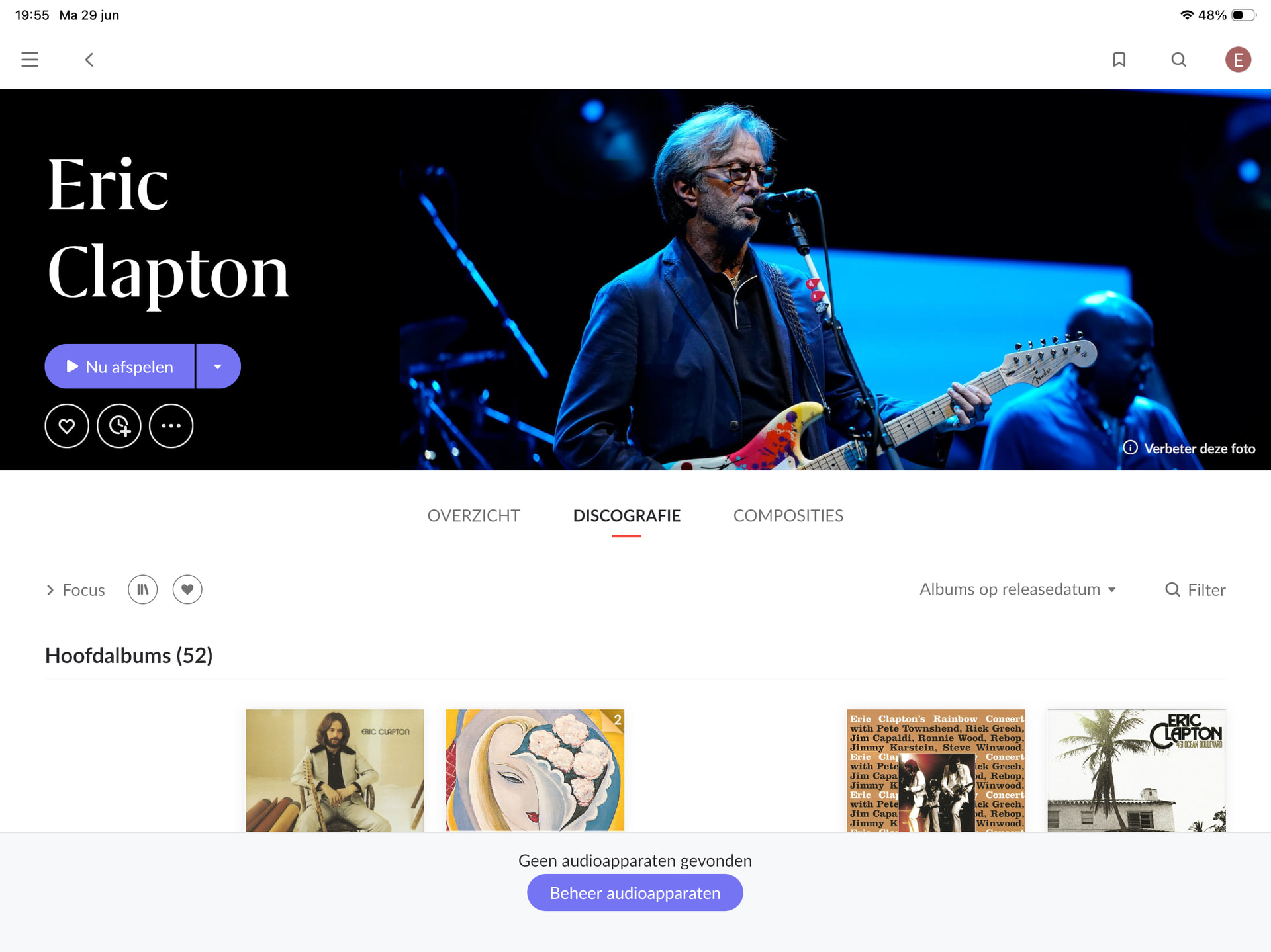

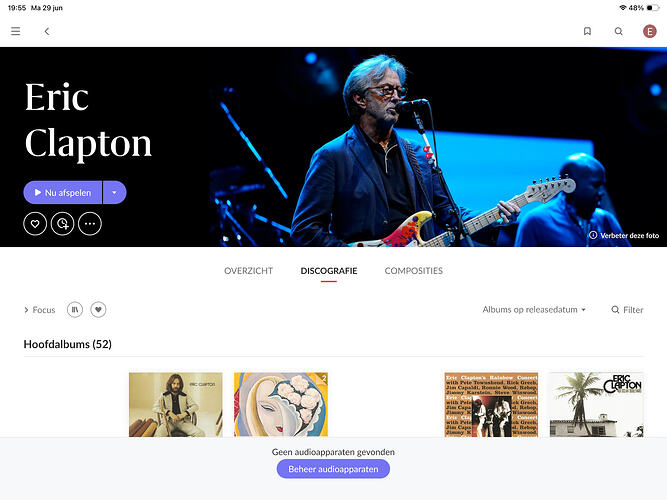

And the last one for today (drop out)
20.21 complete drop out

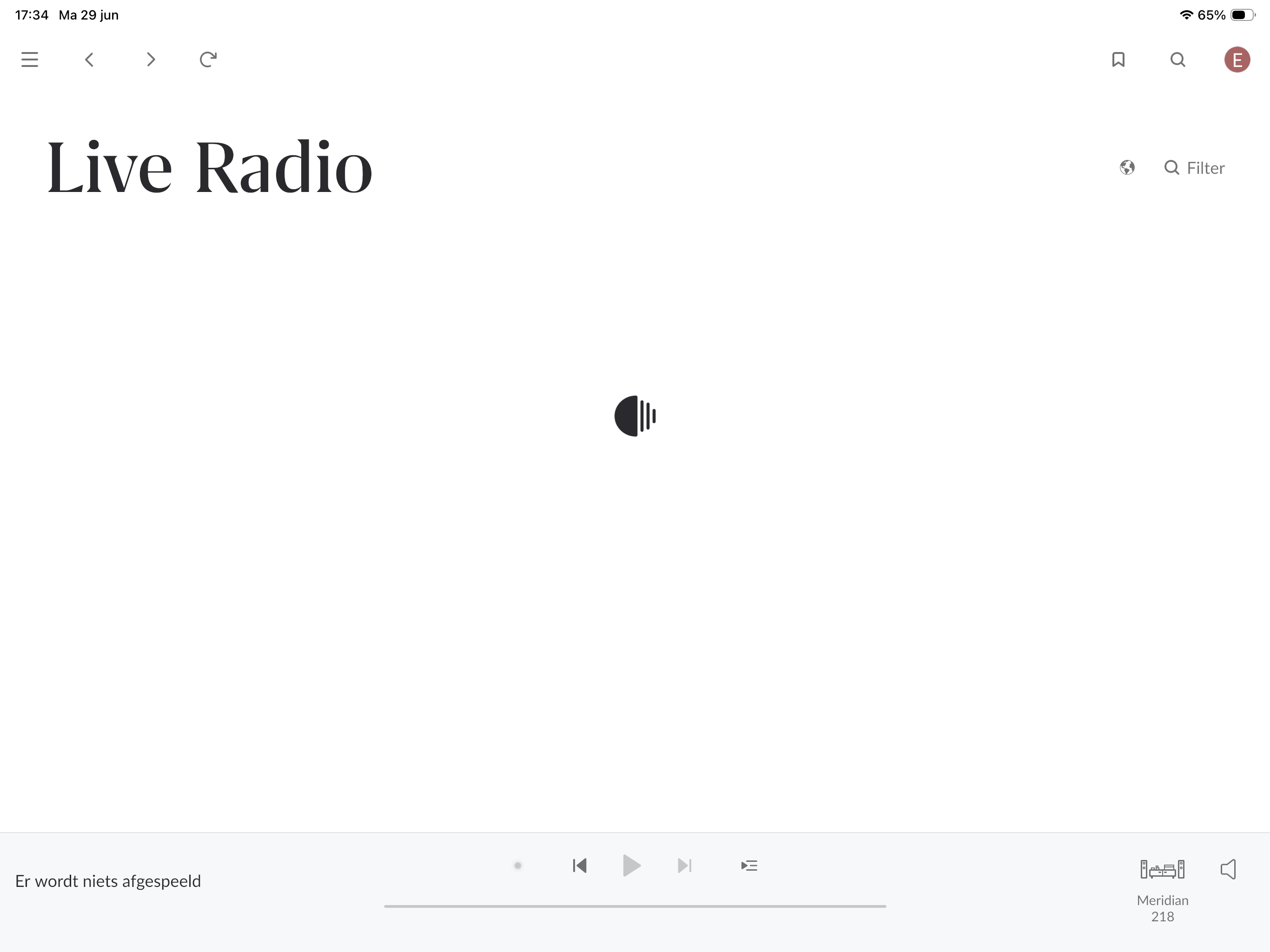

Radio paradise (just like all the other channels fall out of nowhere)
If I want to change something in Roon, so another track or radio station
Want to change there will be a failure

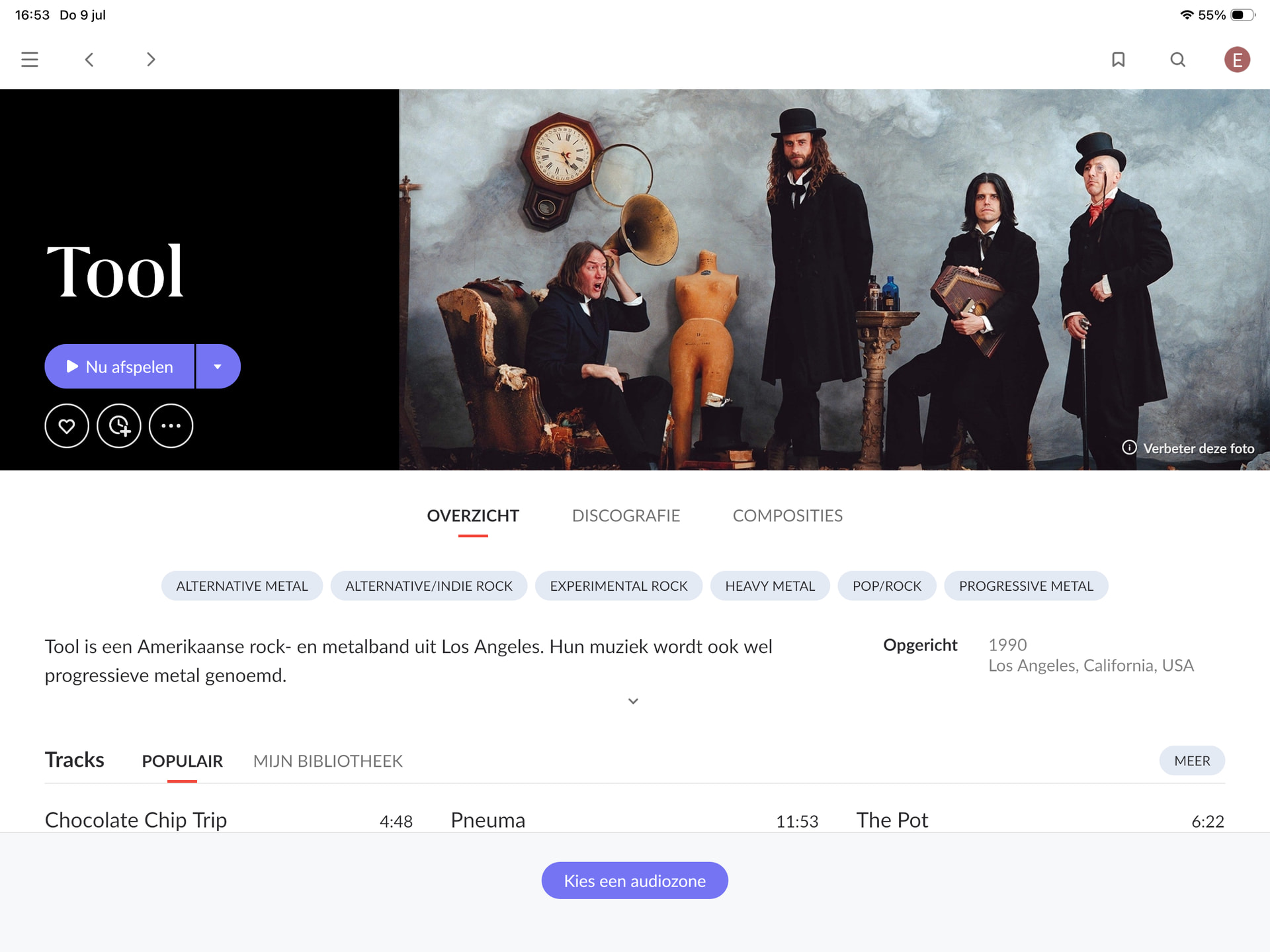

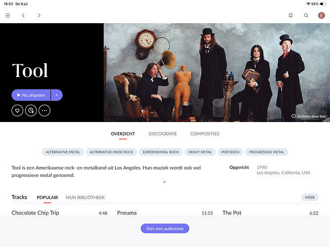

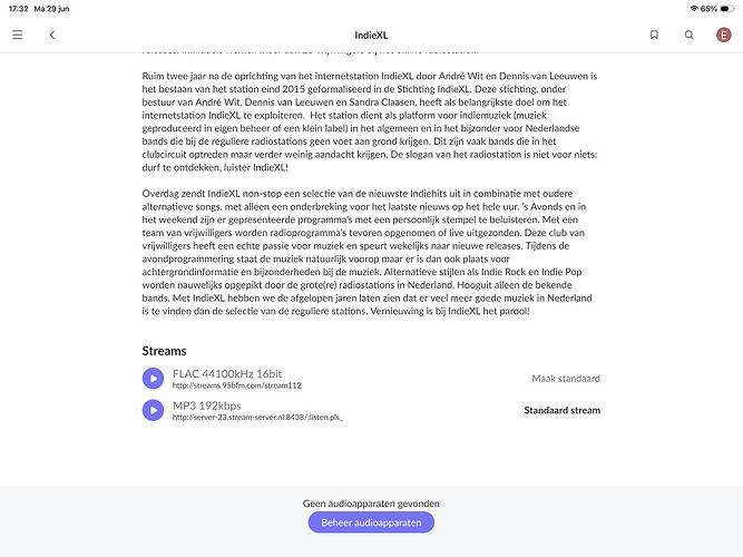

This is where things keep going wrong (old photo)
I have tryed everything, no success.

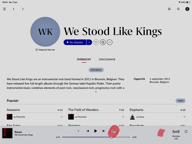

Hello, can you provide a solution? It’s a total disaster. Whenever I press the three lines and the arrow, the connection drops.
