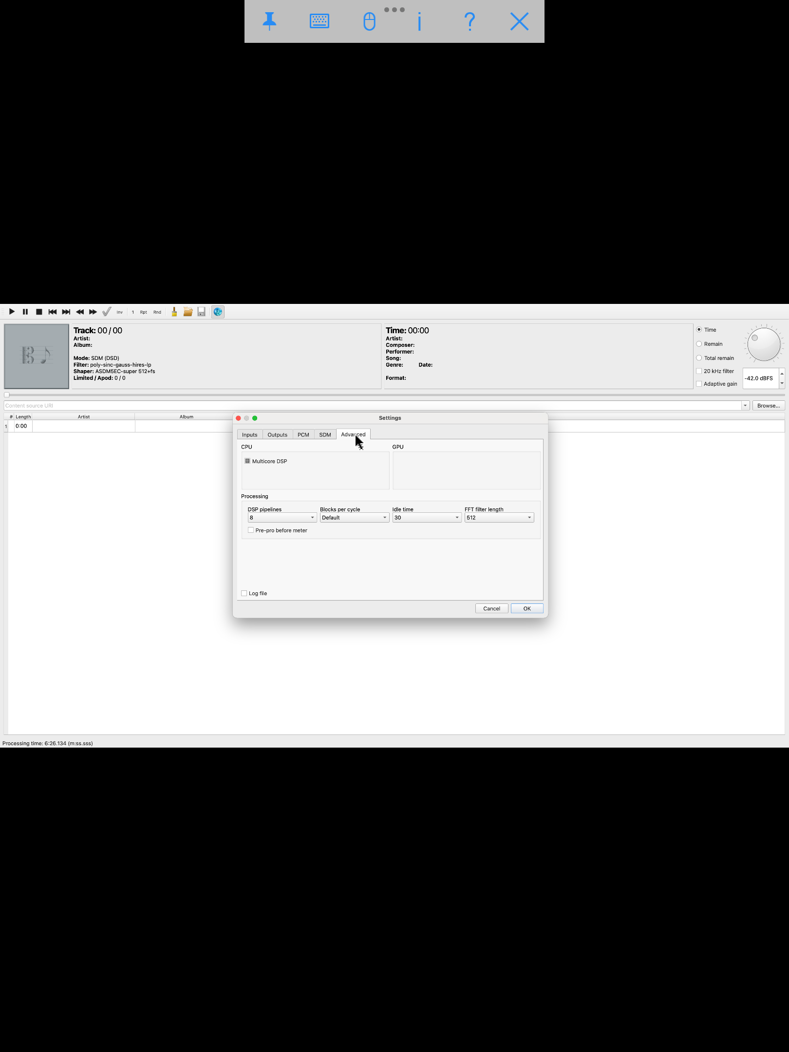

I updated yesterday to the latest version and noticed something that was better handled in the previous versions.
I am using ropieeXL as a NAA bridge for HQP and my Cyan 2 DAC. I had in the past (do not ask me which version) quite pronounced crackling when sample rate switched from one song to an other. This was much better (almost not hearable) in the version before the September update and now the crackling is quite noticeable back.
Any tipps how to reduce / eliminate this?
Thanks

Ah, what I would change in your settings:
  • DSP pipelines to 2 instead of 8
  • Multicore not greyed, but enabled
  • Bitrate limit to 48 kHz x 256
Are you enabled the DAC correction for the Holo Audio (I’m using the embedded HQP and don’t know where this is to set in the desktop version)?
Enabling eats a lot of horse power…
Thanks.
I disabled 48k because in the past that caused more problems with crackling but I will try again.
What is strange is, that I cannot set DSP pipeline below 8, there is only default, 8, 16, etc….
Yes I use DAC correction, that why I use the super or light modulators.
Will see what effect this brings.

If you can’t set pipelines to 2 in the GUI, you can change it in the config file manually.

I updated to the newest HQP version and all is back to normal (one very slight mini crackle between tracks with different sample rate).
All good, thanks for your help.
