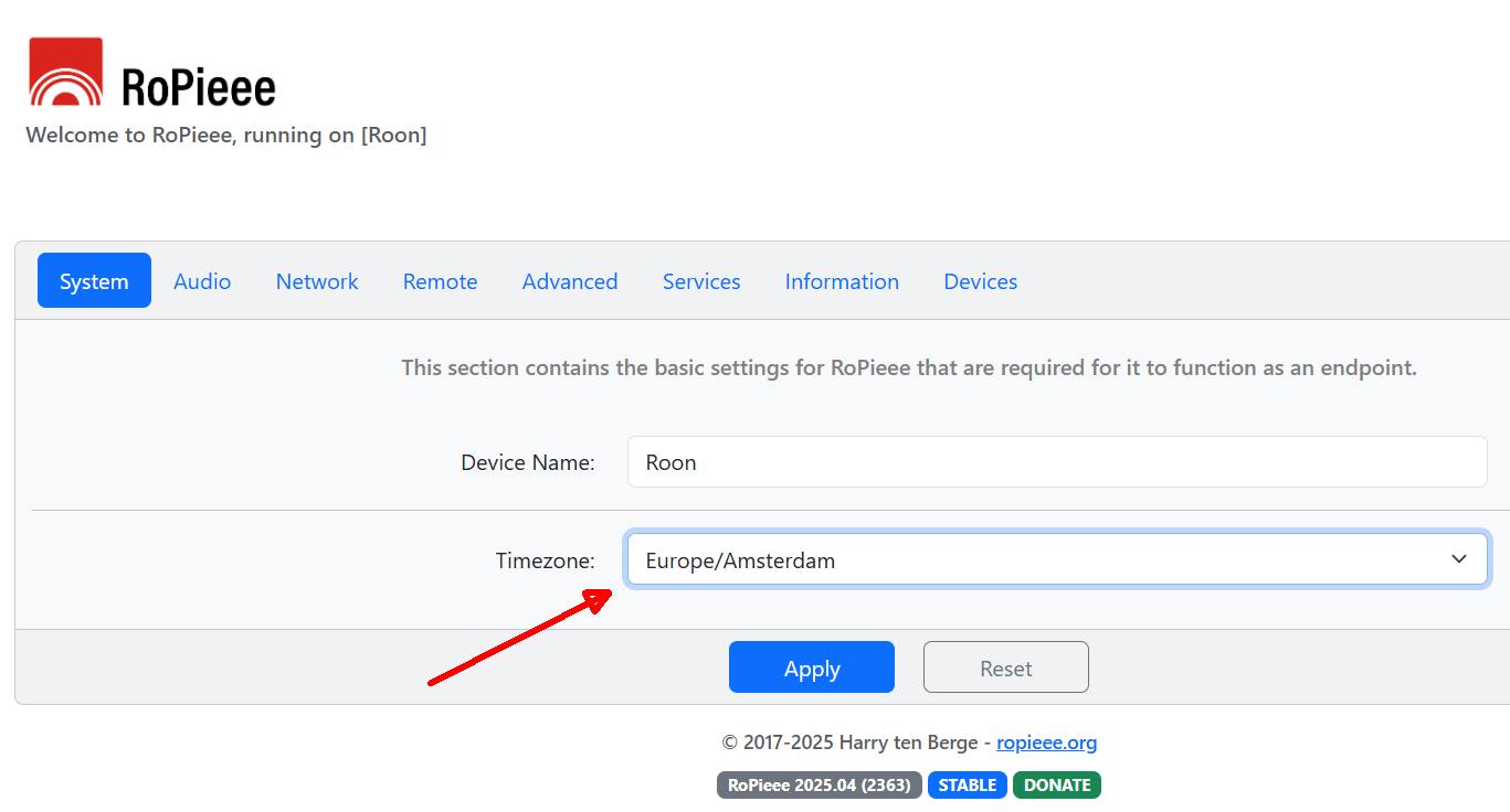

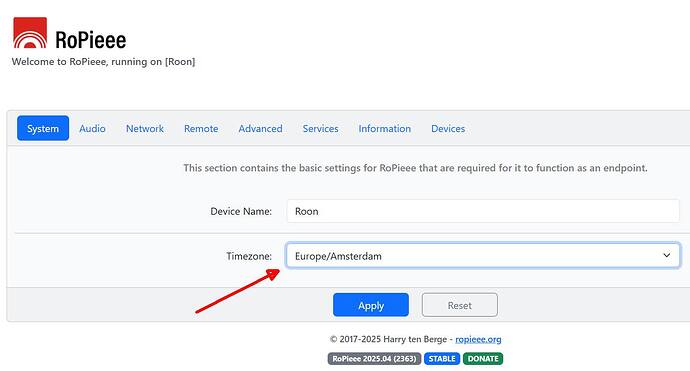

Hey @spockfish, the time is 1 hour behind on my display. I am Eastern Standard time in the U.S. We just recently had Daylight Savings Time so that might be why. Any easy fix?
You can try to change your timezone to a city which has the right time.
You should change in Ropieee GUI System/Timezone to Your country. Than clik Configure button. That’s it :slight_smile:
Regards
Perfect. Changed it to New York city and all is fixed. Thanks Bruno and Frank!
